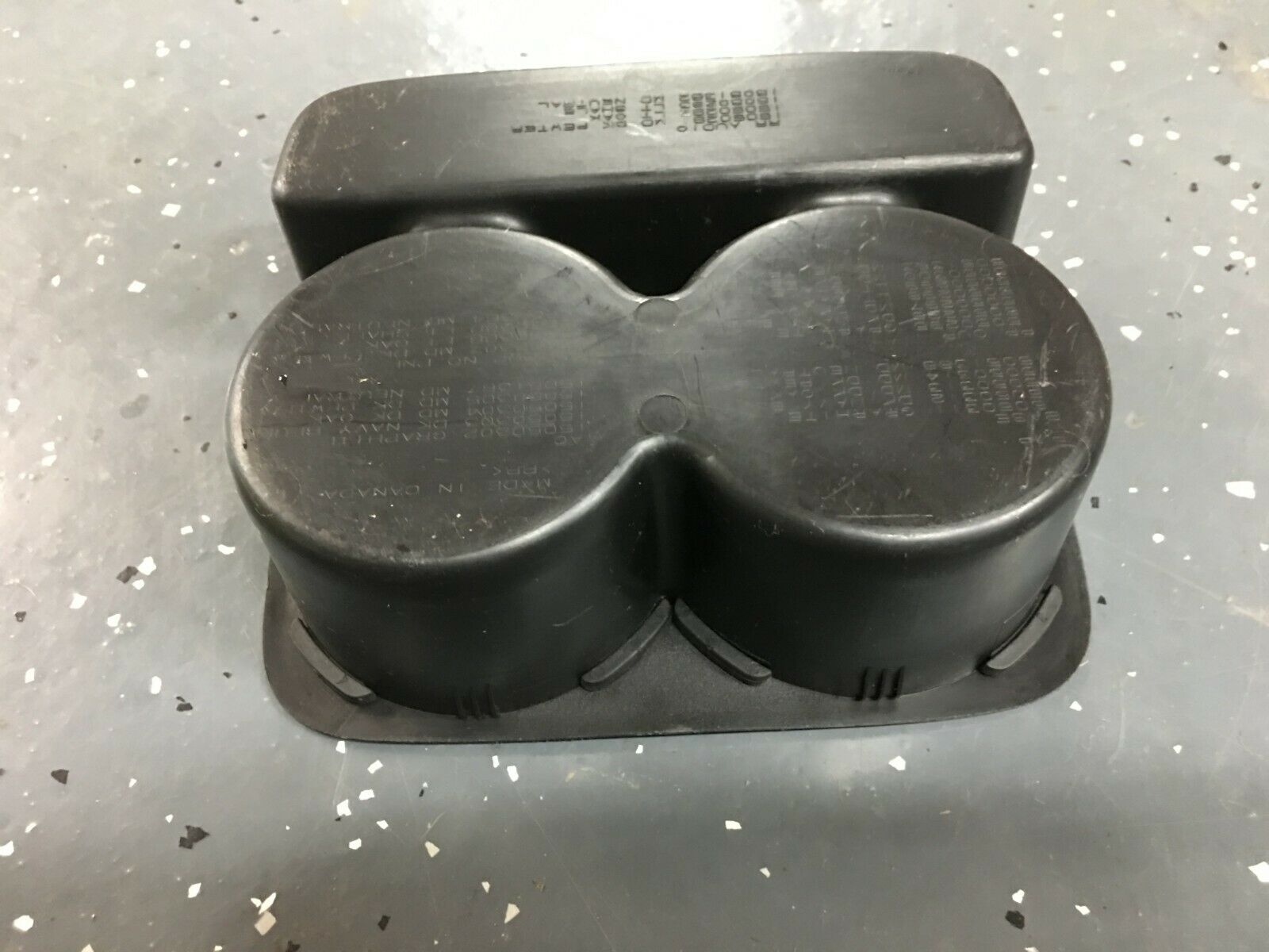

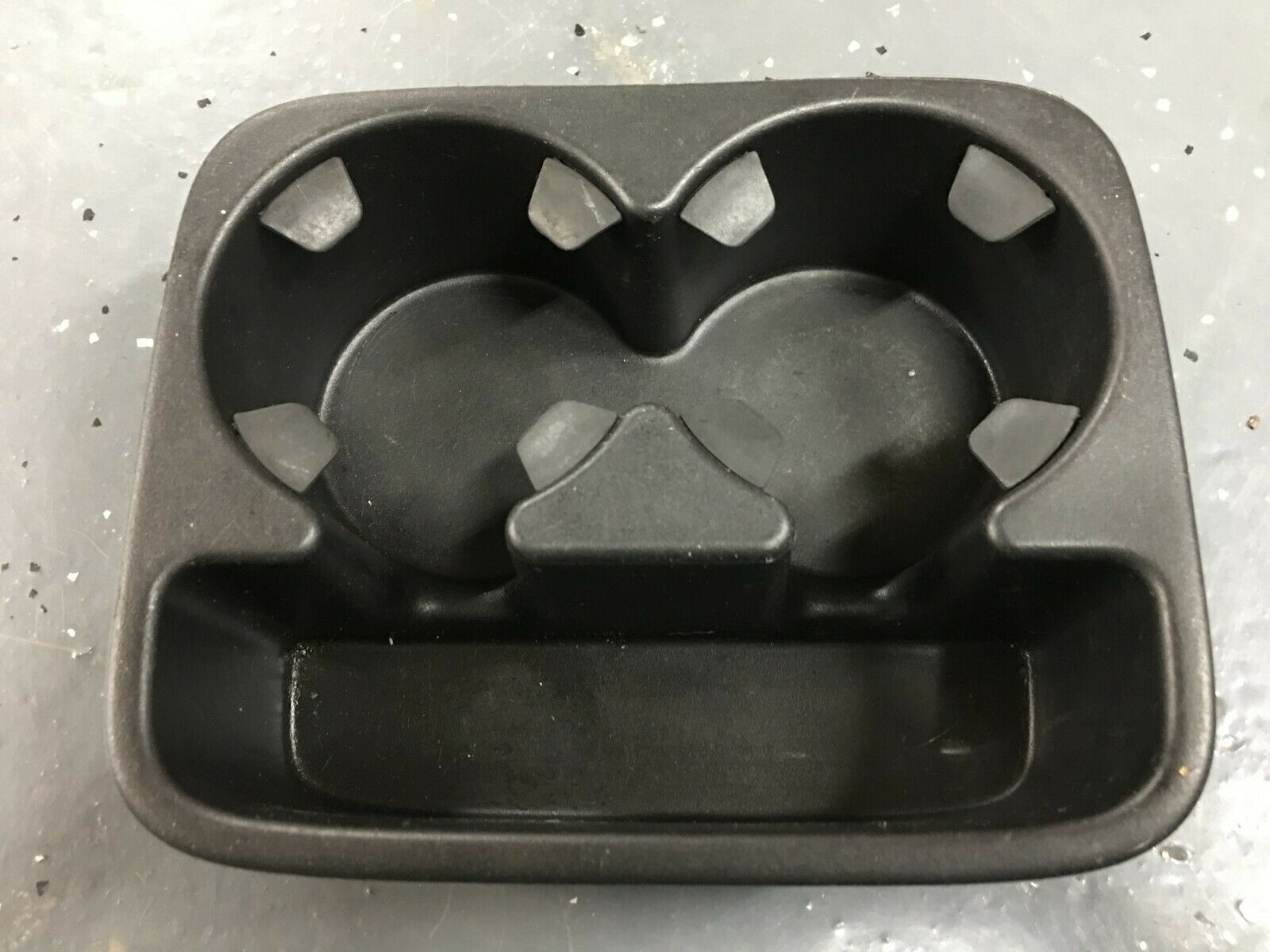

I've got a 2002 Chevy Tahoe Z71 and my drinks fall out of the cup holders when I make a turn. I know there is space underneath the cup holder in the center console. Does anyone make an aftermarket cup holder that I could install that would be deeper or hold drinks better? I've already searched eBay and Amazon. Thanks. I attached photos of the original OEM one that is too shallow.

I’ve never seen anything deeper. buy a replacement (junkyard, ebay, etc) and cut the bottom off so your cups drop down further... as the cup gets wider up top it will stop it from falling through. When you get it to your desired depth, plastic weld the extra plastic back ..on.

I was having the same problem with a Bronco I owned - went to Home Depot and got a couple pvc pipe couplers and installed them in the oem cupholder - worked well.
