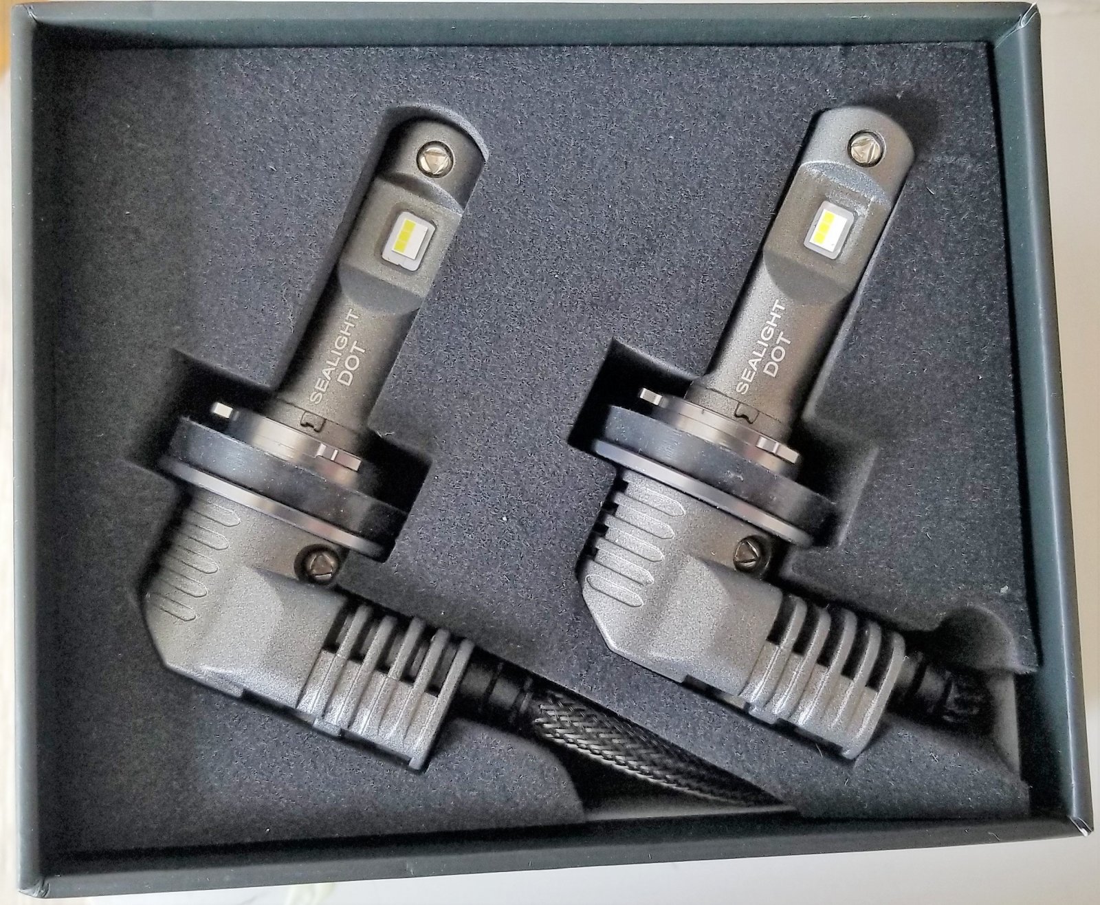

Good Afternoon,
After having a disastrous experience with an Amazon seller and Spyder for their Tube LED Headlight Assemblies warranty.
I was already aware of the low light output, but my warranty claim was for them being out of square or rotation. They made a V when on a night.
So after a long search that many of us have made for a bulb which does not require cutting the core support and other modifications.
I have found two:
1) Sealight H11 S2 I got these at a great price when going to their website. They have a wheel of discount and freebies on your first time on the site. Shipped to me $59.00 for a set.
2) Headlight Revolution's "Perfect Fit" bulbs, cost for these are $129.00. I went with the lower cost because of past clearance issues, the two companies are similar in size.
I was concerned that they would not fit, like the many others before the Sealight H11. Install was not difficult I just removed the bumper as I find this to be the most efficient for me.
I'll take some night picture later and post....
So after the install I was greatly appreciative of the fact that no modification were required of any kind.
Assembly:none
Harness :none
Bulb: :none, some rotation adjustment was necessary for a 3 and 9 o'clock orientation
Pics:

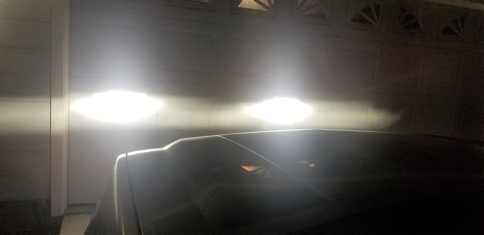

Night Shots...
Needed slight downward adjustment, will get road shots tomorrow..
Thnx

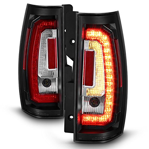

nothing, he probably added led tail lights as well and failed to mention it, I see reports of some people loosing cruise after adding led tail lights but I never had that issue no matter what I did to them.

Yes, I have a new style C shape LED Tail lights. These if I understood correctly have a built in resistor/canbus ready.
I am running LED DRL, So maybe it's the combination of the two.
But, I did have cruise when it was just DRL LED's

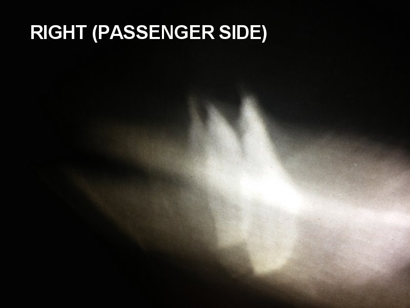

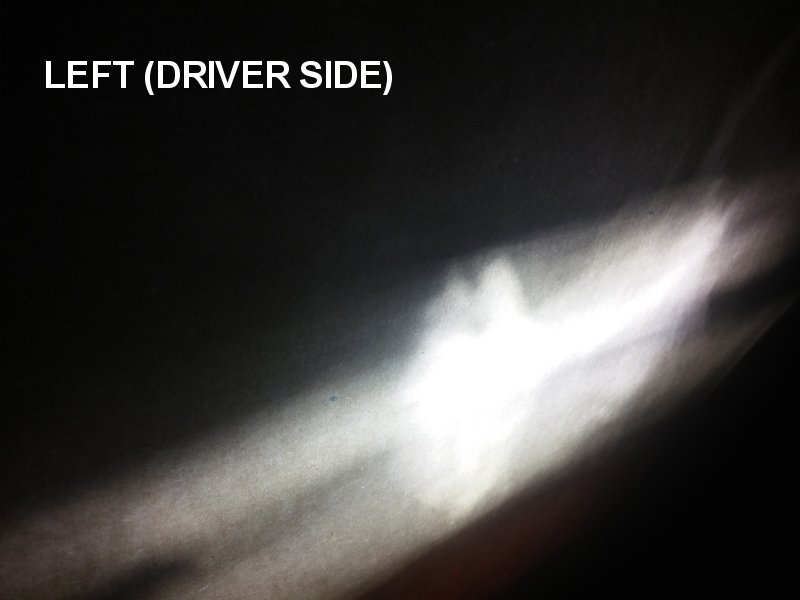

Thanks for your post. Can I ask which Sealight H11's you ordered? I ordered a set that look just like yours, because the smaller fan and "L" shaped plug looked like it would fit without hitting the core support tube. They were my fourth set of LED's ordered, all the others were too big. They did fit, but the beam pattern is all over the place, with multiple angled slices (like a bunch of orange sections), where the points at the ends go up above the cutoff line, not the smooth beam pattern you are getting on your garage door. When I pull out into the street, they are going up the sides of houses, and I suspect will hit oncoming drivers as well. They seated properly, are vertical, and look just like the ones in your photos. I included an image of the bottom of the box that has some kind of part number labels on it. Any help appreciated. Really getting tired of fighting this issue.
View attachment 223909 View attachment 223910 View attachment 223911 View attachment 223912 View attachment 223913
I would like to throw in that Morimoto 2Stroke 2.0 bulbs are LED and DOT certified so you should have no pattern issues with them. Are you sure you have those bulbs oriented the correct way?

Disasterman you have a message...
Cruise issue turned out to be a bad brake switch...
Orientation is a 3 and 9 (clock) ONLY, that will give you basically the OEM pattern...
