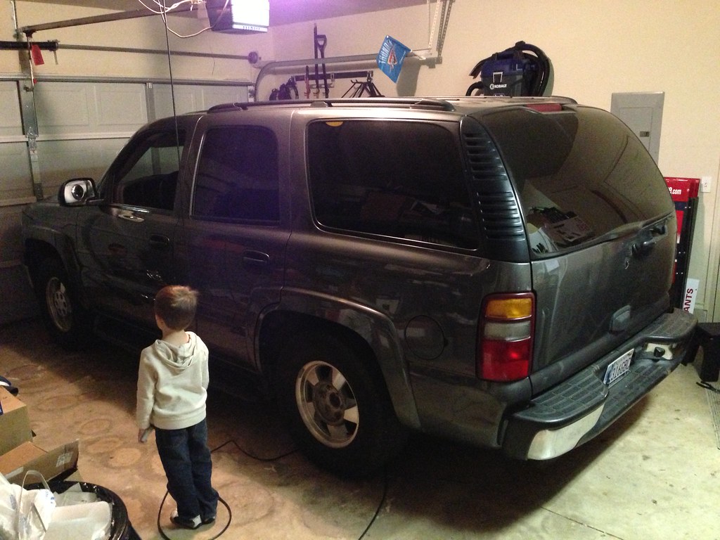

Back end is done
The rear is done.
I guess I'm halfway through. Starting on the front end now...

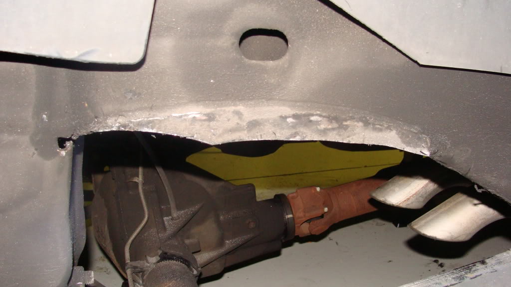

the kit rides great but you need to cut the bracket off the frame ie free travel mod I spoke to you about this.

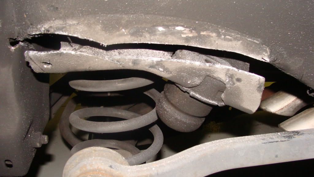

The kit rides good just ask godoy he has the same kit. That being said there is no way it will ride good without the free travel mod. This is why I sent the short bumpstops. When we spoke I even said new bump stops are included when you cut the rear bracket off the frame. These are the same ones that I sent you when djm didnt sent them and you said you wanted them so you could do it all at the same time.
Maybe there was a loss of communication but im sure I said the stops are for that.
If you have a sawzall you can cut the bracket along the frame and then clean up later.

do it now trust me on this. I bet if you look at the rear of your truck the bumpstops are sitting on the axle. Just get a sawzall for now and hack it off just cut as even as you can with frame like pic above shows.

I actually yanked the factory bumps out, so the bracket's there, but no bump stops.
