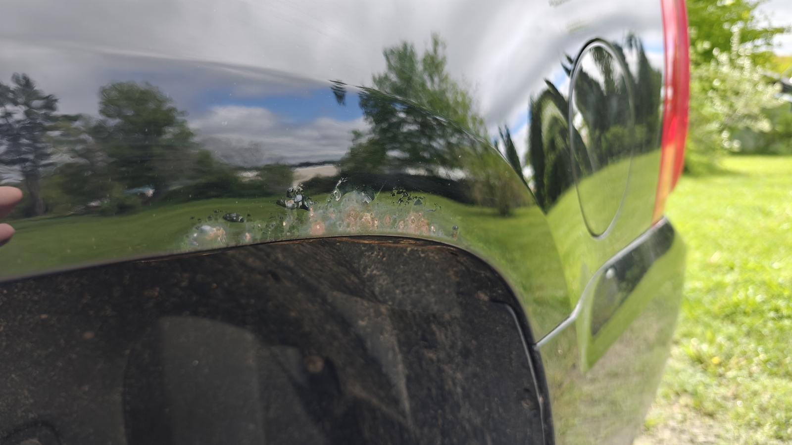

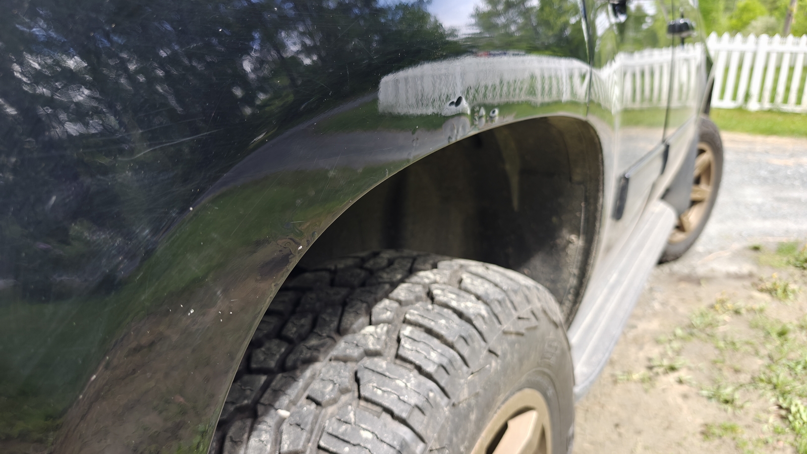

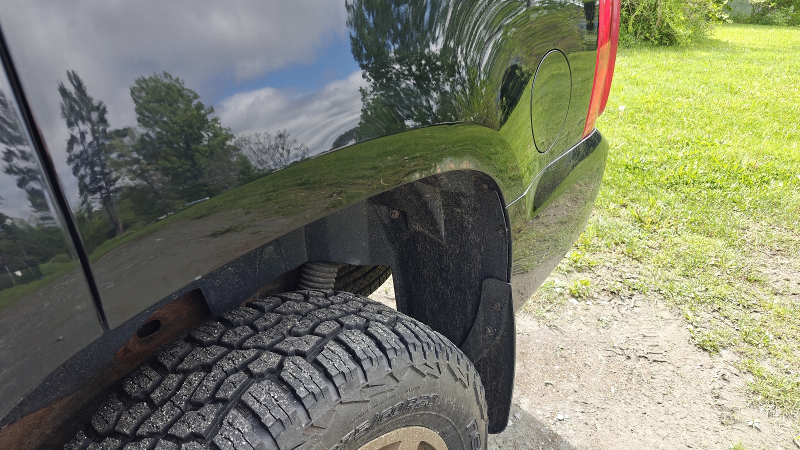

I'm starting to get quotes for some rear wheel-arch paint bubbles and rust repair, and the the first quotes are from $2000-4500! I'm not sure I'm going to spend that on car that's probably worth ~$10k... if that.
I'll probably try doing it myself, but would like you folks to chime in with any/all tips & tricks, or some videos that helped you out. The priority is stopping the rust, and not glamorous paint perfection.
Getting the metal serviceable, then adding some fender flairs might be the play.

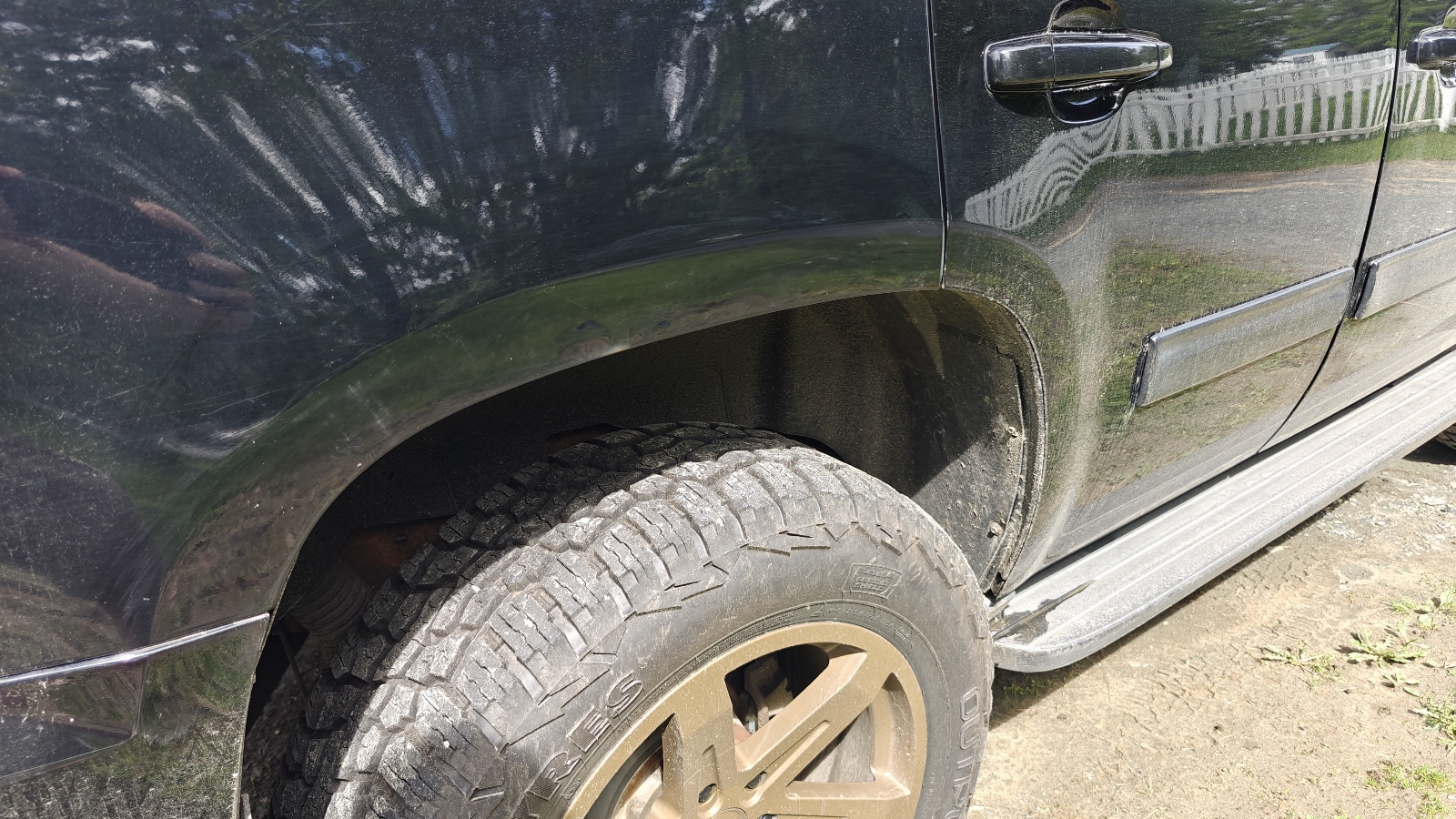

I have some similar wheel arch rust developing and would also like to find a way to stop it cost effectively. I took the truck to one reputable shop who refused to work on it. They said they have too many customers with rust returning and to do it right, it requires too much labor which drives up the cost to levels that don't make sense for older trucks.
I don't have any experience with body work but would also love some advice on ways to get it "good enough."

I have similar on mine. To do it right the shops won’t repair any rust they replace the entire panel. No big name shop will grind and cut out rust because it will come back and they won’t warranty it. That is why the costs are high. I think the 2-4k is a good deal; recently I paid 2k just to get my hood repainted. Labor ain’t cheap anymore.
I understand the labor thing.
If I'm going to do it I'll be looking for material recommendations. POR-15 vs. *** vs. ***, etc.

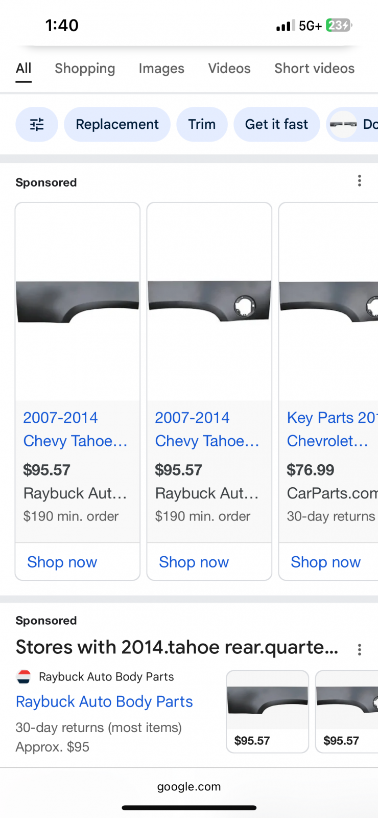

I have a 2015 so the body is a little different. I did a quick search and new panels are only $100 for a 2014?I’d just get one and have some backyard painter spray it if you want cheap and good enough.
I would consider that if I had a way to cut and weld the new panels in. That's something I consider above my skillset for a daily-driver.

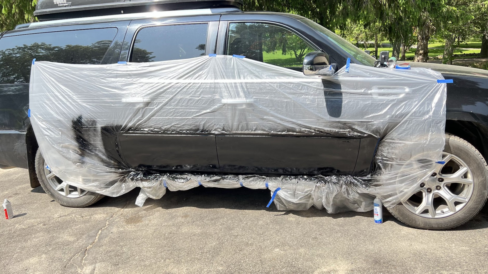

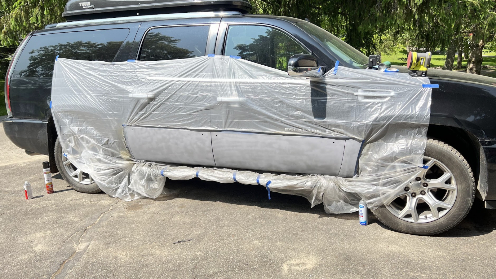

Just did this to mine this weekend, there were tiny specs of rust, when I started sanding down the pore opened up and what looked like a tiny dot had a quarter sized circle of rust underneath.
Finished it off with primer and rustoleum paint.
