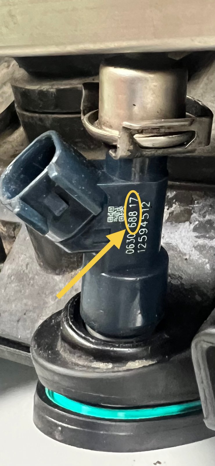

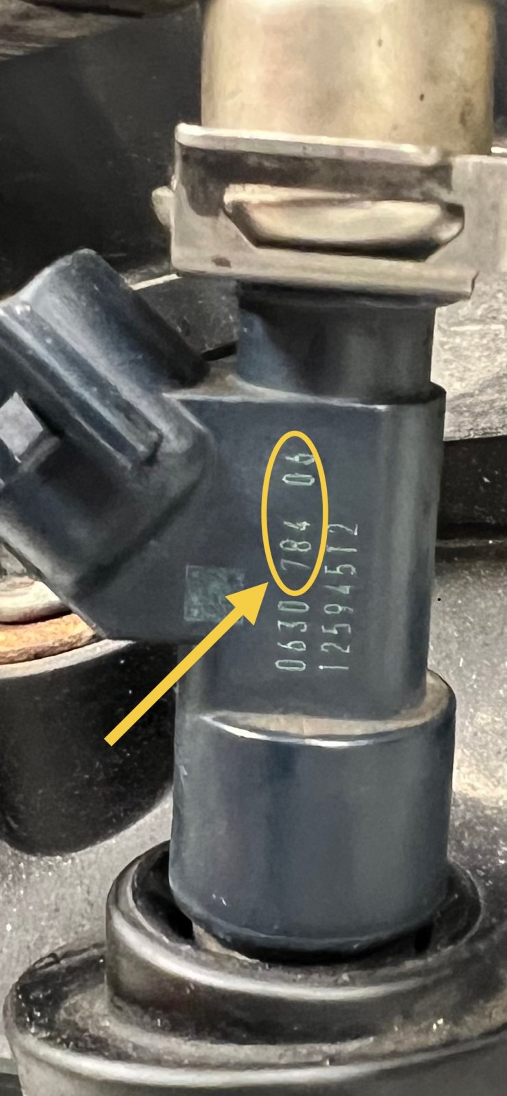

It’s been a minute, but I found out what’s going on with my jalopy. So, the previous owners put in new injectors (think I mentioned this in my earlier post), and apparently, one of the injectors is different.
All 8 injectors have the same primary part number, and all 8 seem to have additional part markings above the primary PN (see pictures). However, 1 of the injectors seems to have a much lower flow rate compared to the other 7, but also has different part markings above the primary PN - the one with the “784 06” marking.
I ended up taking a non flex fuel intake assembly off an 07 Sierra and swapped it onto my Tahoe. She runs mint now.
So, I’m looking to buy a new set of injectors, but have some concerns about the difference in the ones I currently have. Do you guys know what the numbers circled on the injectors in the pictures mean?
