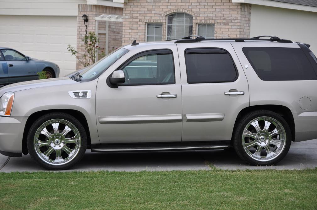

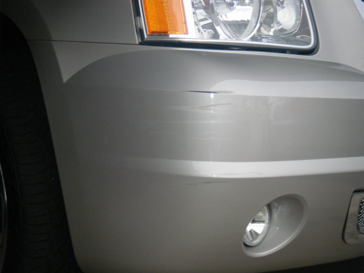

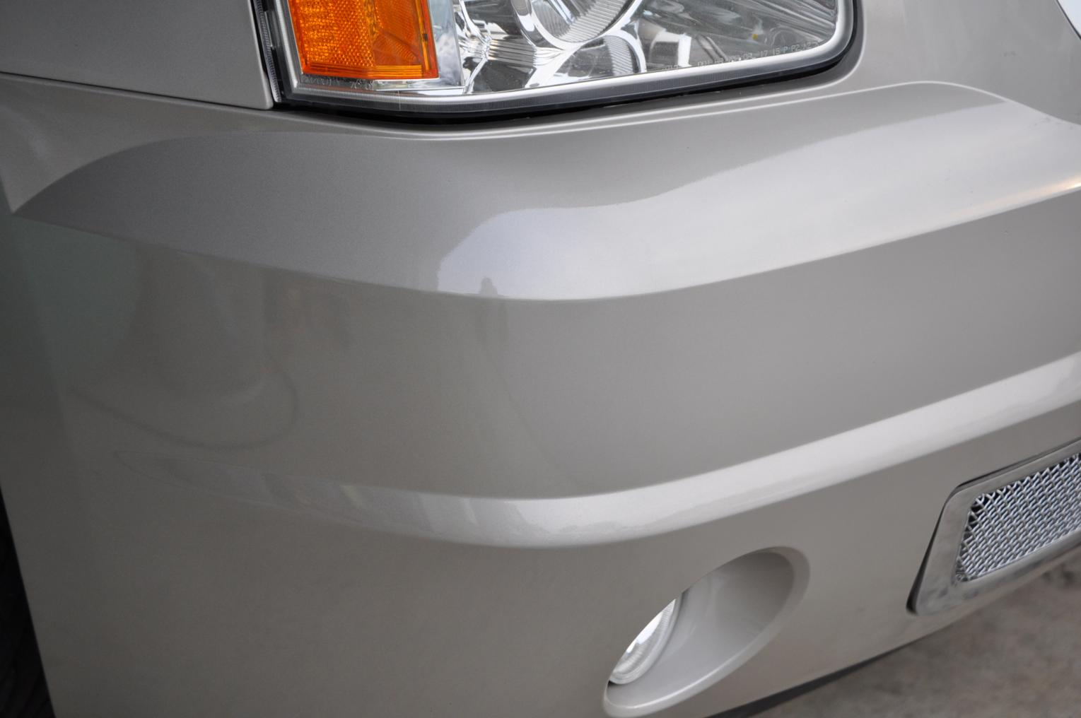

Ok, I just picked up my Yukon from the Shop. They heated up the inner trim and pushed it back all the way and let it harden. I can go over a bump over 10 MPH and no rubbing, I can back up and no rubbing. I also had my right front bumper repainted, it had a large scratch on it. Now it looks new. For all of the work that I got done I only paid $170.
Scratch Before:
After Scrattch:

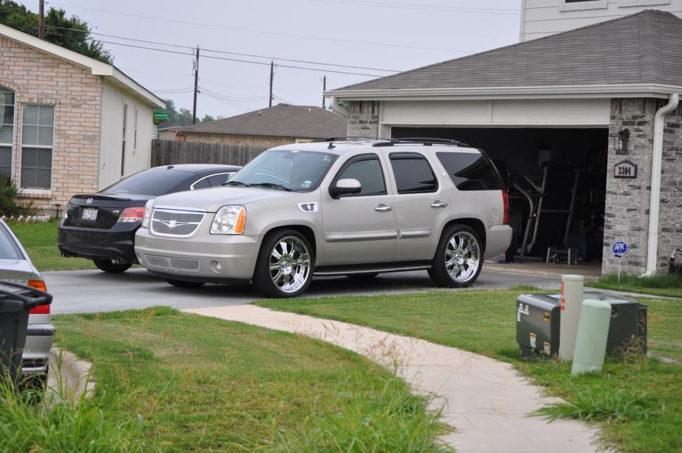

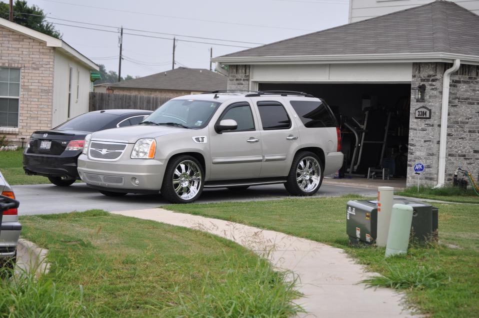

Belltech 2/4 Drop:
Tell me what you think of the MOTHERSHIP!!!
THANKS!!!

looks awesome! we had the same issues with our 2/3 on 24s. We went from a 305/35 to a 295/35 tire and have zero issues now. Ride is the exact same as it was with the 305s.

Looks good, I may need to get some 295 series 26" tires with all my rubbing!

Looks good bro. I love the ASANTI grill. I wish I could hear that horn

p.s.- cut your grass dude! LOL

Thats my Nextdoor Neighbors grass, mine is cut. I have been trying to get him to cut it.
