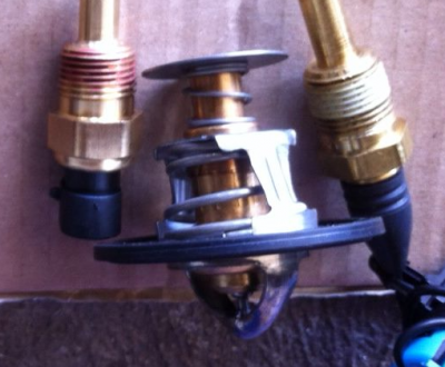

Yep, 2 of the gasket above. The housing came with a gasket. Should it not have one?
Truck is a 2000 Limited, so it is still the OBS with the 5.7 Vortec.

Yes, use the gasket that is supplied. Be careful not to over tension. Thermostat housings can crack easily at the mounting holes.
View attachment 258022 View attachment 258023
Never been a gasket on my 96. Not sure for the 2000
There's a recessed section in the center that seals to the rubber gasket (not an o-ring) that sits around the edge of the stat on mine.
