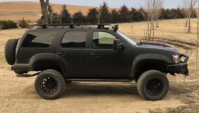

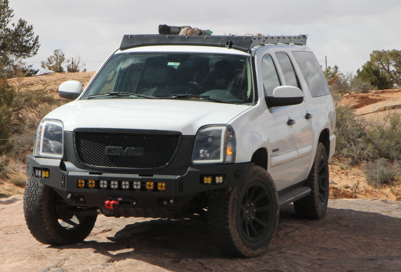

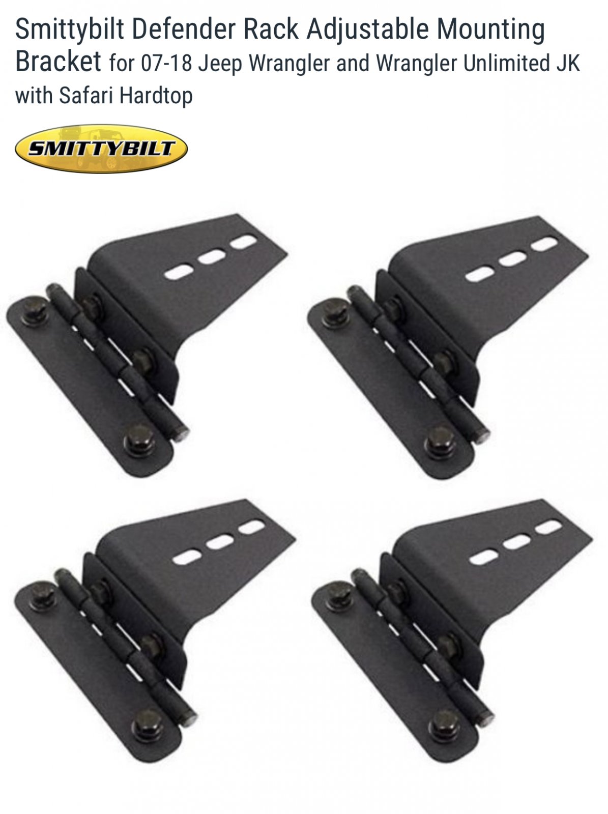

I removed the stock 2007 Tahoe roof rack and filled the holes with paintable sealant. We then used the Smittybilt Defender Rack Adjustable Mounting Brackets (Jeep) to mount an ARB Alloy Flat Roof Rack. Mounted the brackets with rivet nuts. Painted rack and mounts with Raptor paint. No problems with leaks and rack holds anything.

Thanks. I looked at everything out there and custom was the only way to get it exactly the way I wanted it. The trick was to find the rack I liked and the mounts. The ARB was costly, but there are a lot of others out there. Good luck with your project!
