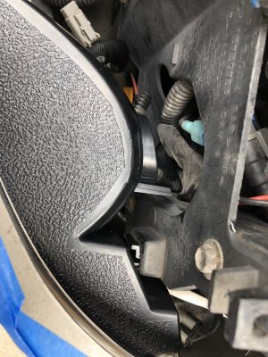

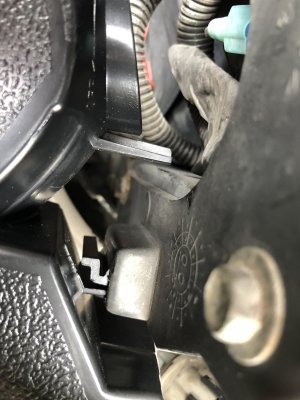

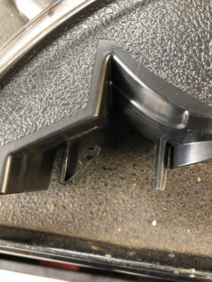

I got the new corner lights today and of course the driver side one wouldn't stay clipped in. I don't know why but every one of these sets I've ever bought has this same issue- the plastic clip that's supposed to have some 'spring" to it doesn't work. So again I applied a heat gun and opened it up a bit so that when I snap it in, it holds.

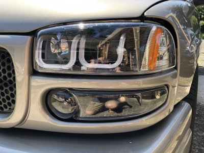

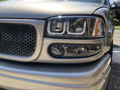

Installed, they match the Anzo's pretty good. They're flat black housings with clear lenses. If I was to do anything as far as baking them open, I'd probably either leave the corners as is and remove the orange reflectors and paint the chrome part inside the headlights, or open them all up and PTM in Pewter. I still haven't even seen the projectors at night so I'm still undecided on retrofits. But that can be done without opening them up. I think they look pretty good as is but I still need to check the output. Tonight.

Thanks. So last night I tried them out. They were adjusted so far down that they were useless until I adjusted them up. Then they were just as bright, maybe a bit more due to clear lenses, than the Spyders I took off. But I’m pretty sure that I’m gonna go ahead and retrofit them. Probably get Morimoto bulbs and ballasts too. It’s just money lol.

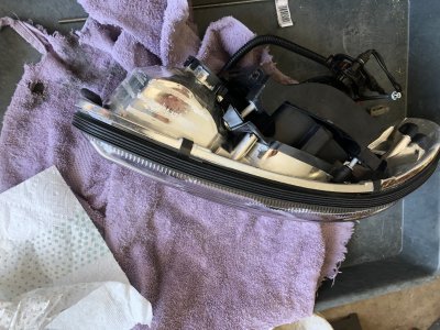

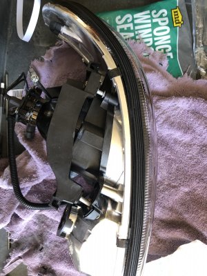

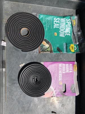

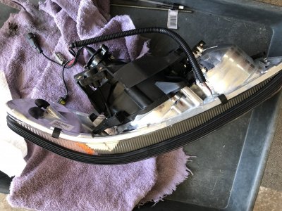

I've been contemplating using some weatherstripping to close the gaps around the headlights so today I gave it a shot. My trip to Home Depot resulted in 2 possible products that looked to be about the right size, both using 3M self adhesive. After getting home and messing around a bit, I decided on the rubber one. It states it's 5/16" thick. There were some other rubber ones that were 3/8" but not in black. I removed a headlight and cleaned it with denatured alcohol, and although I had only intended to apply it to the top and sides, I decided to do the entire perimeter. I did my best to follow the body lines as they move around the housing but it's not perfect. I didn't want to pull it off and reposition it so I might get another roll and remove the old/ apply new. It's not bad though, looks way better. I put the seam at the bottom where it won't be noticed. Before and after pics are in the next post.
