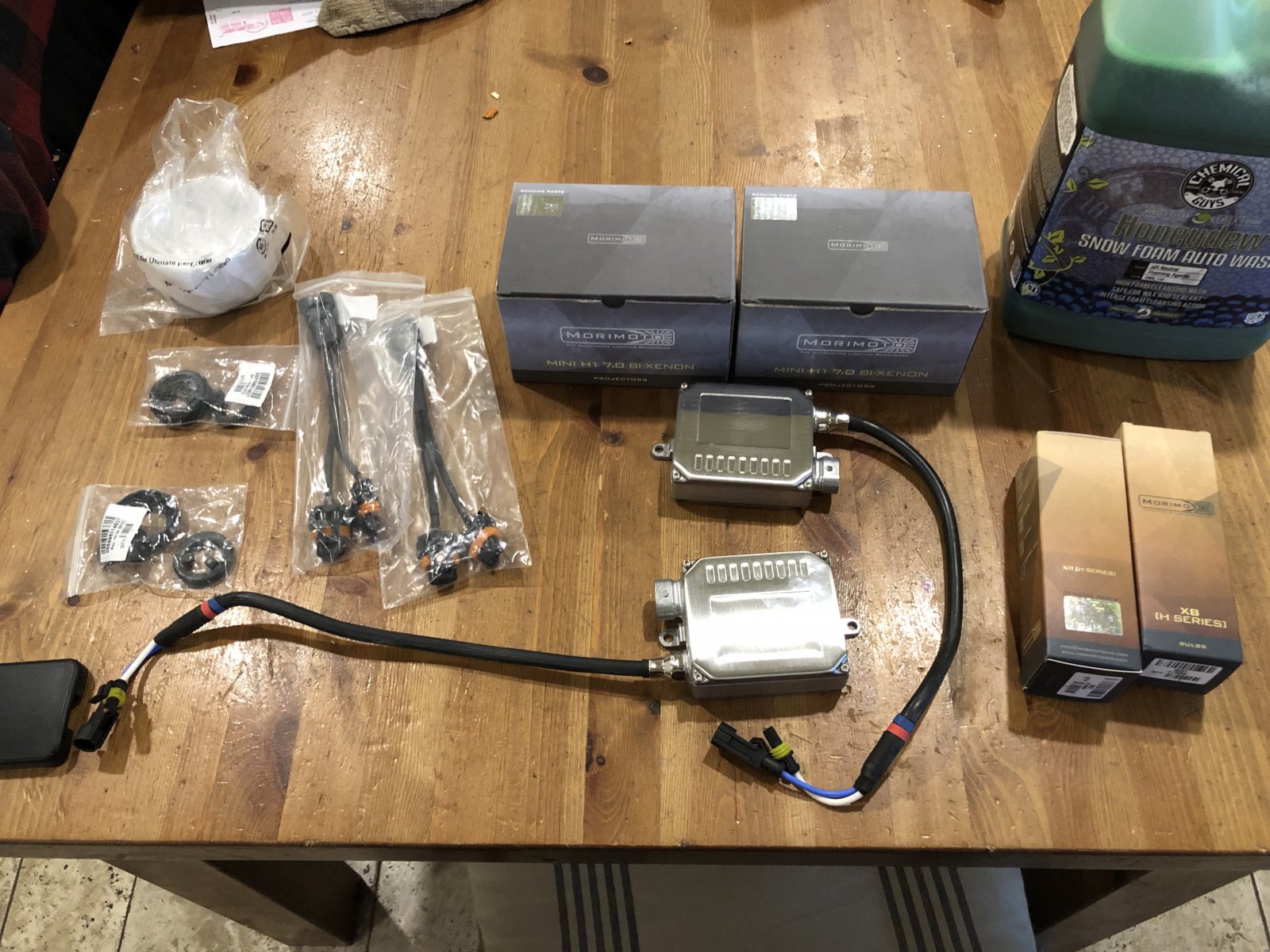

Got some stuff today. Projectors, ballasts, bulbs. The brackets will be here Friday.

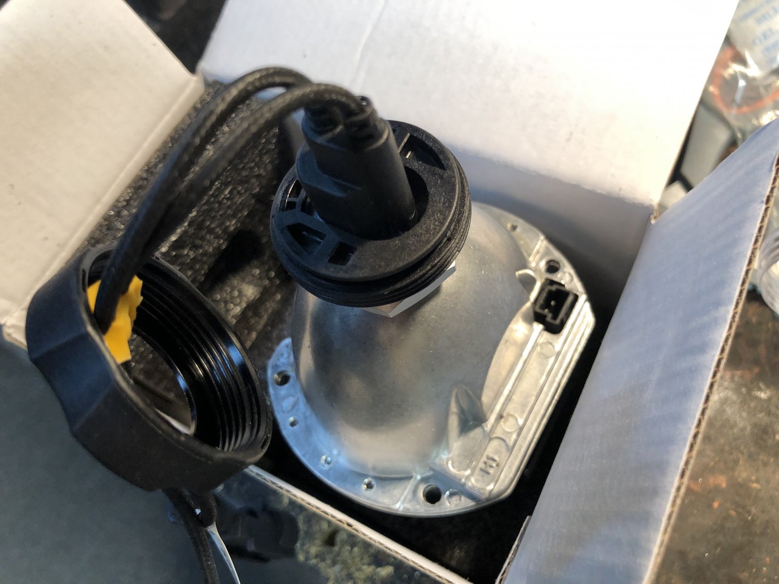

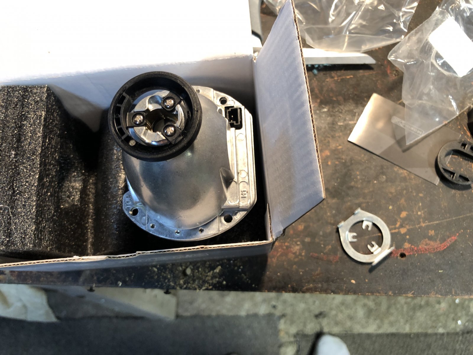

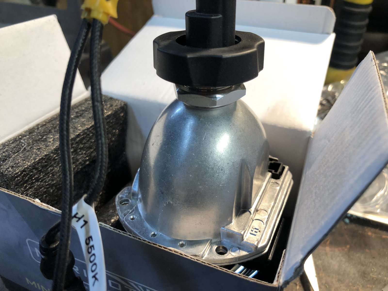

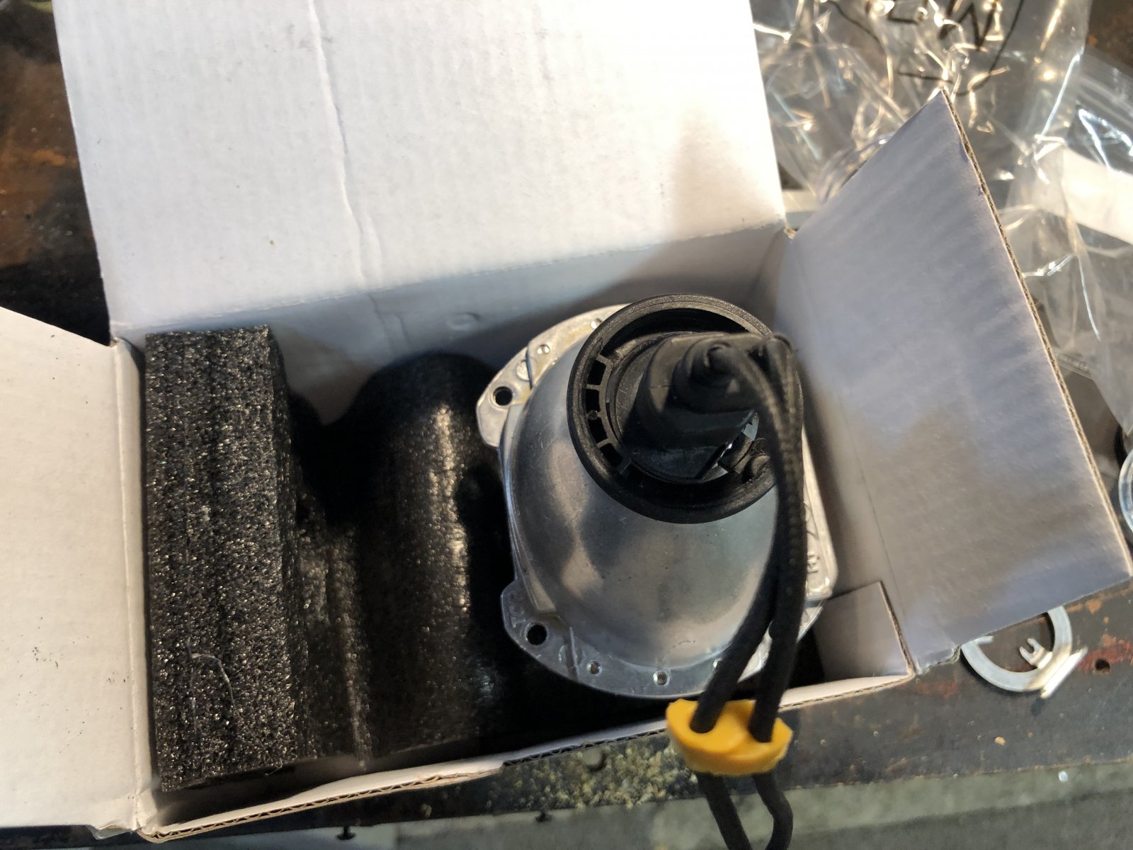

Who knows maybe I didnt use them right. But for some reason I couldnt get the bulbs to sit right in the projector
Weird. I just installed them, no problem. I just took off the metal brackets, screwed the back of the holder on, inserted the bulb then the puck, and screwed the nut thing down. Everything is keyed so it only goes on one way.
