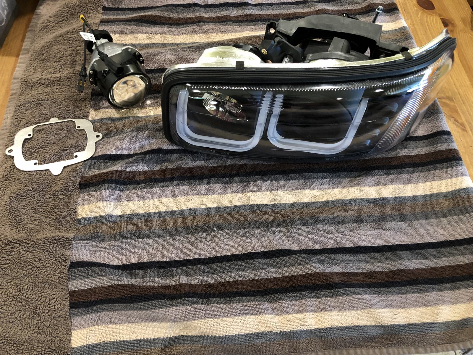

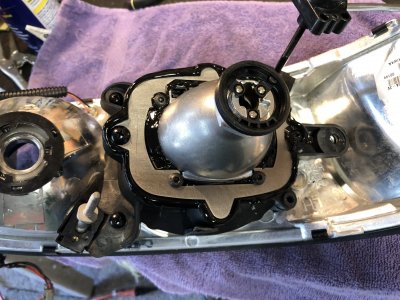

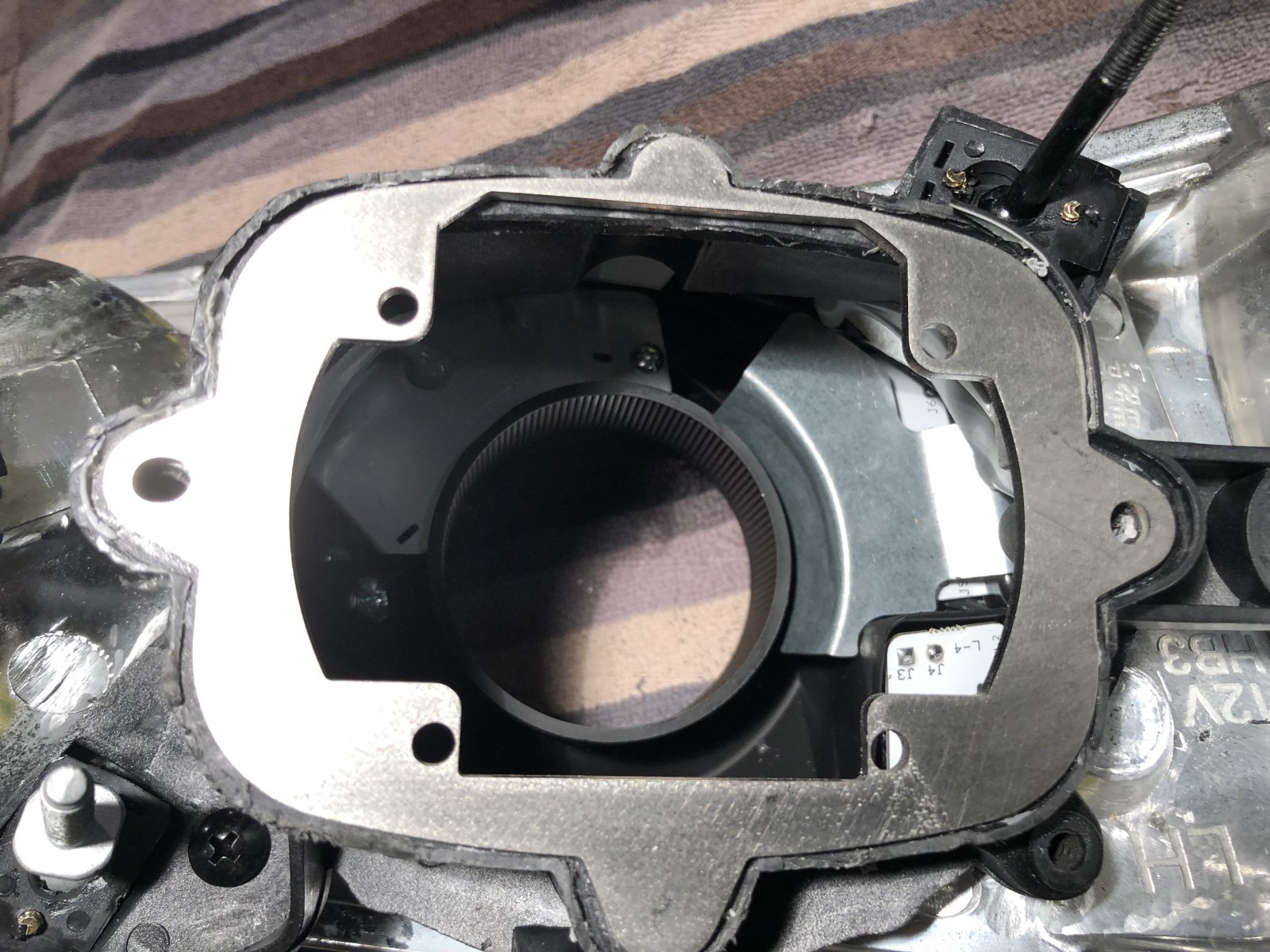

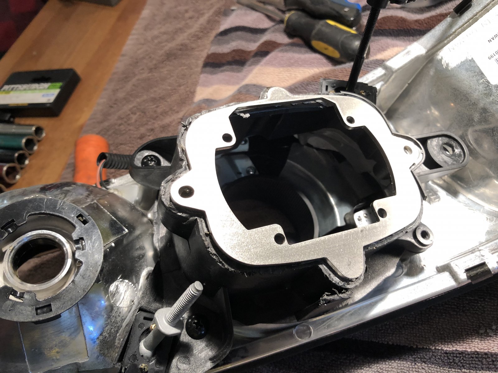

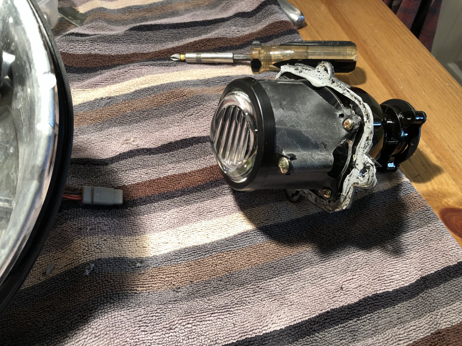

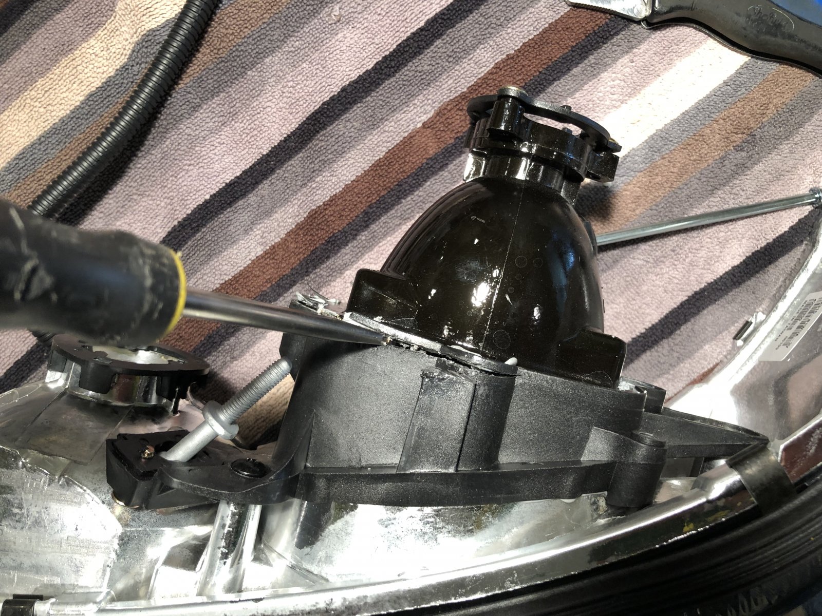

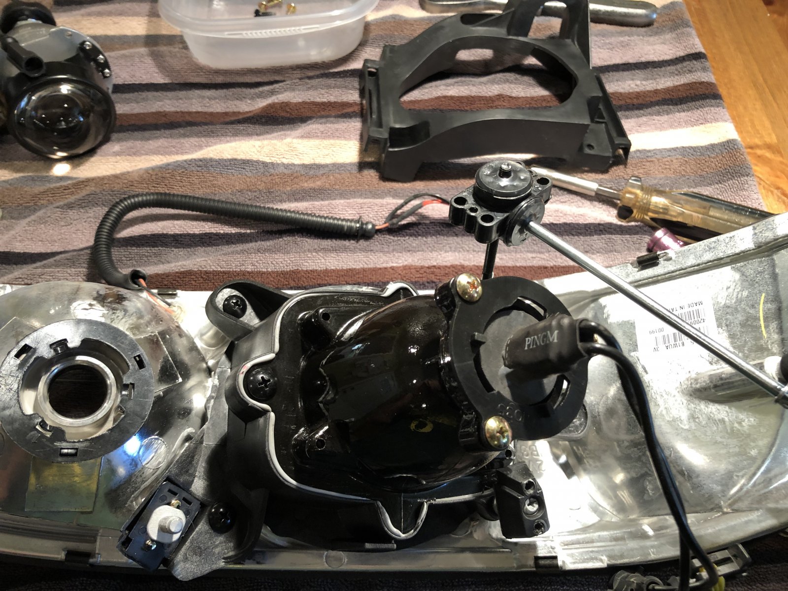

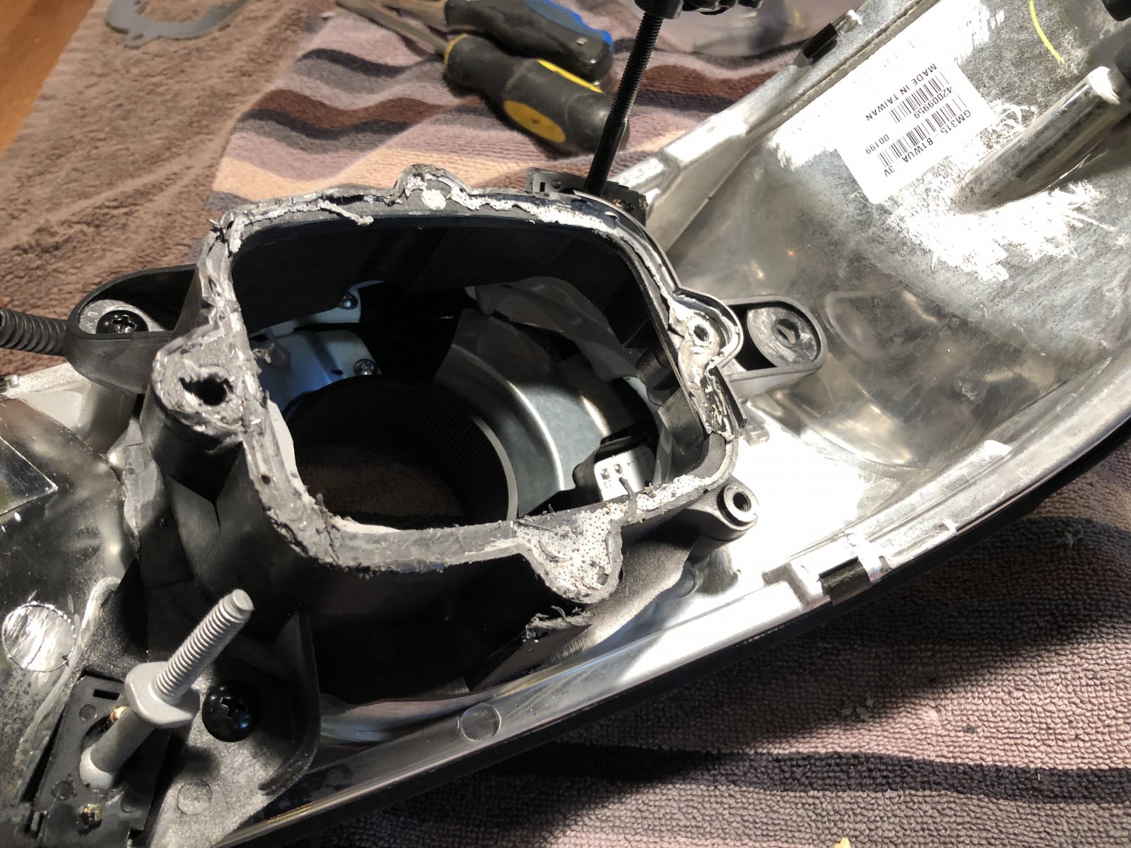

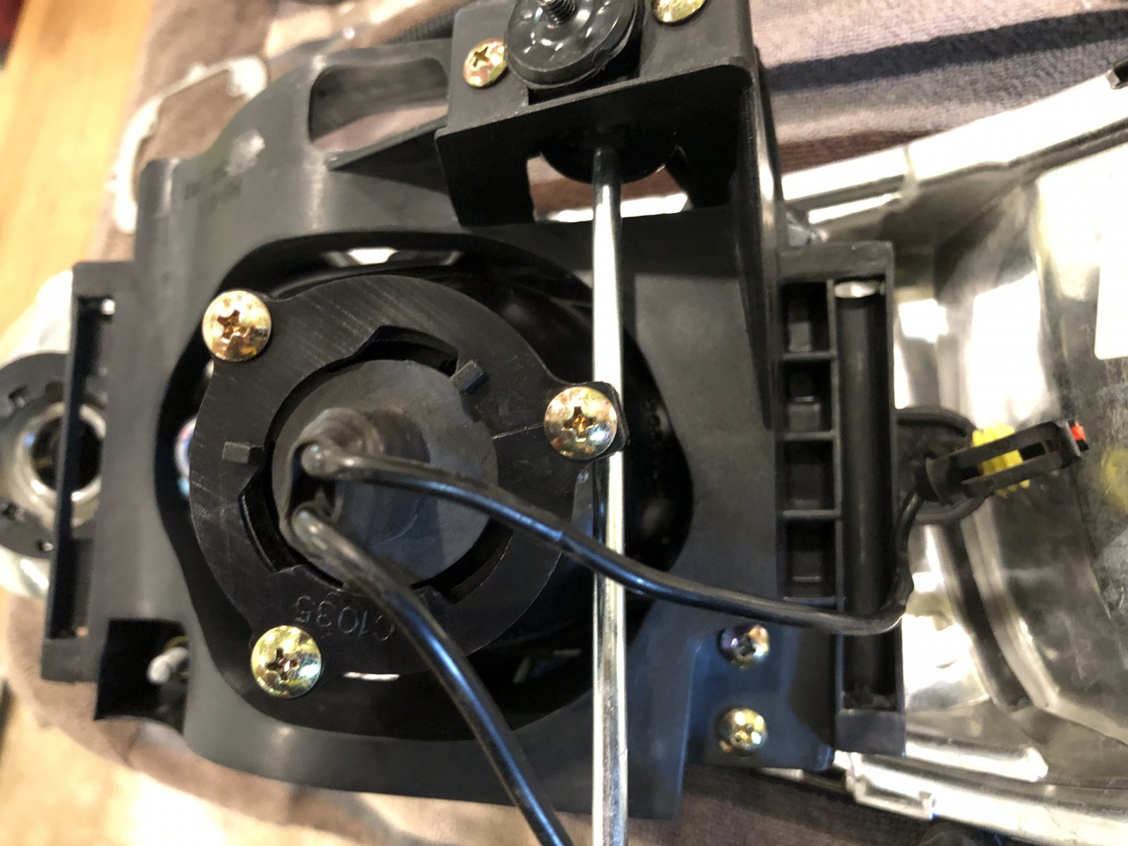

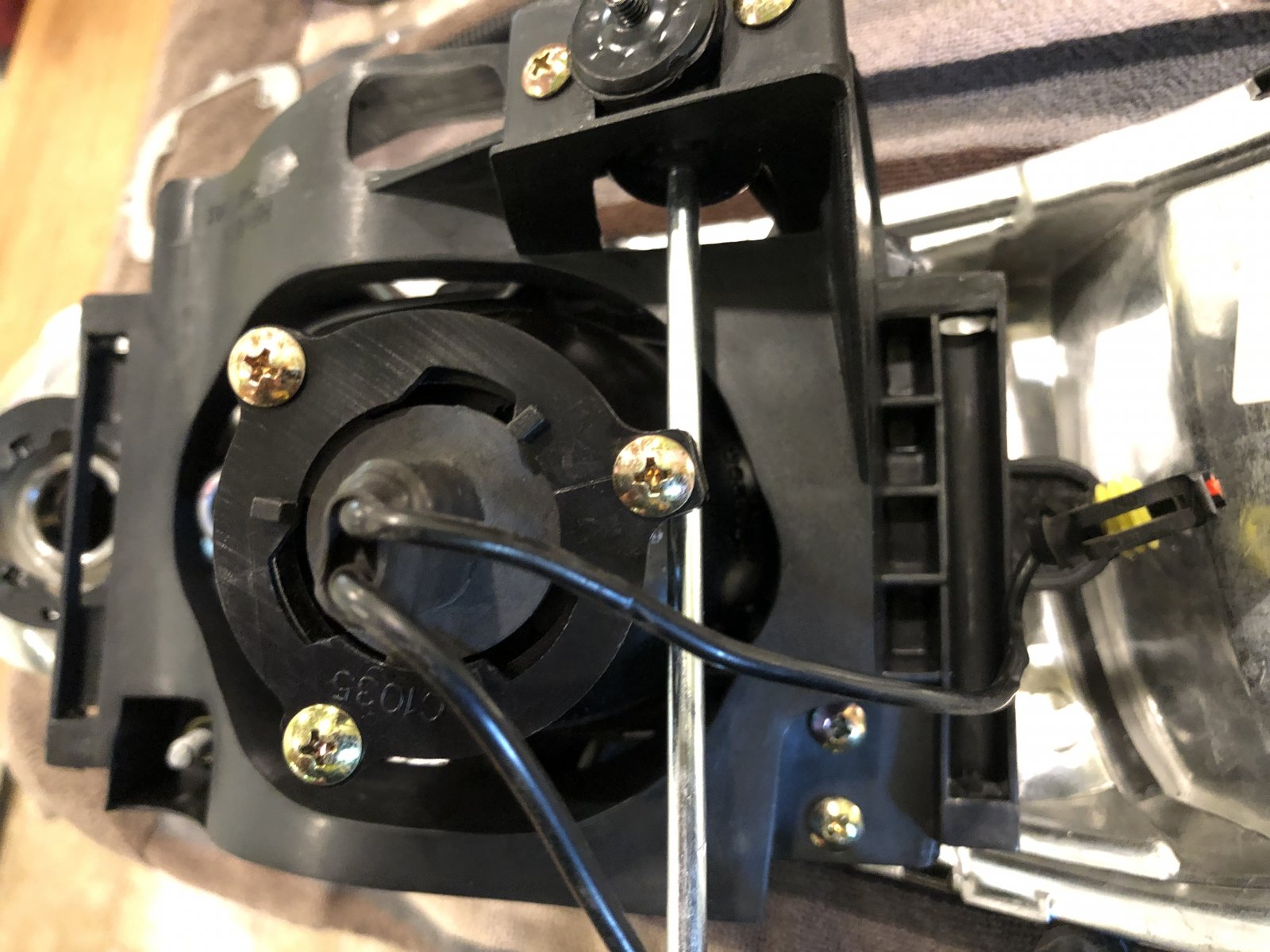

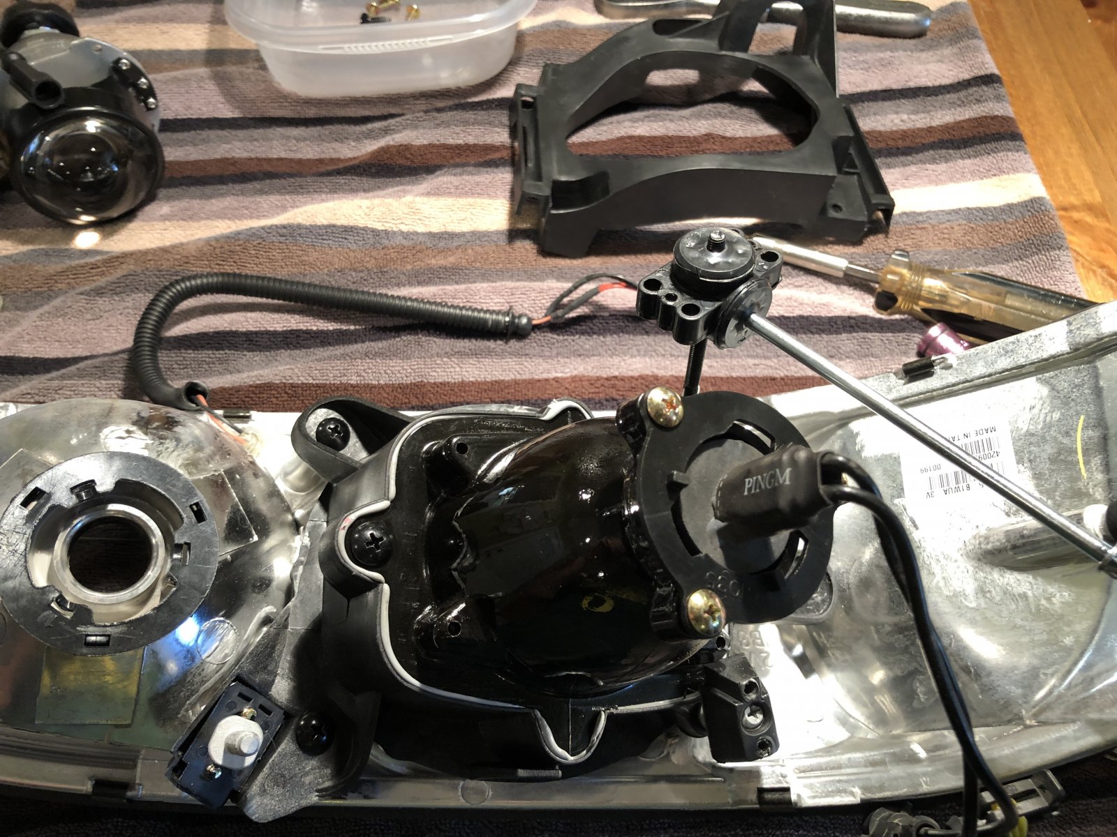

The adventure begins. Here's the headlights... and second pic is the back. I took a look before starting and it looked like the brackets would fit, so next I removed the adjusting assembly. Man it looked like this was gonna be soooo easy, 2 screws to remove the projectors but then what was that grey stuff oozing out from around them? Hoped it was silicone but nope, it was some of that permaseal or whatever that stuff is that's really hard to get apart. I started using my best razor knife and some new blades, cut a little until I could get something in to pry. I tried a heat gun and it helped a bit but pretty much just had to muscle through it. My arms were sore after the first one.

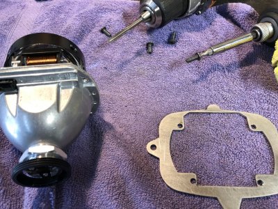

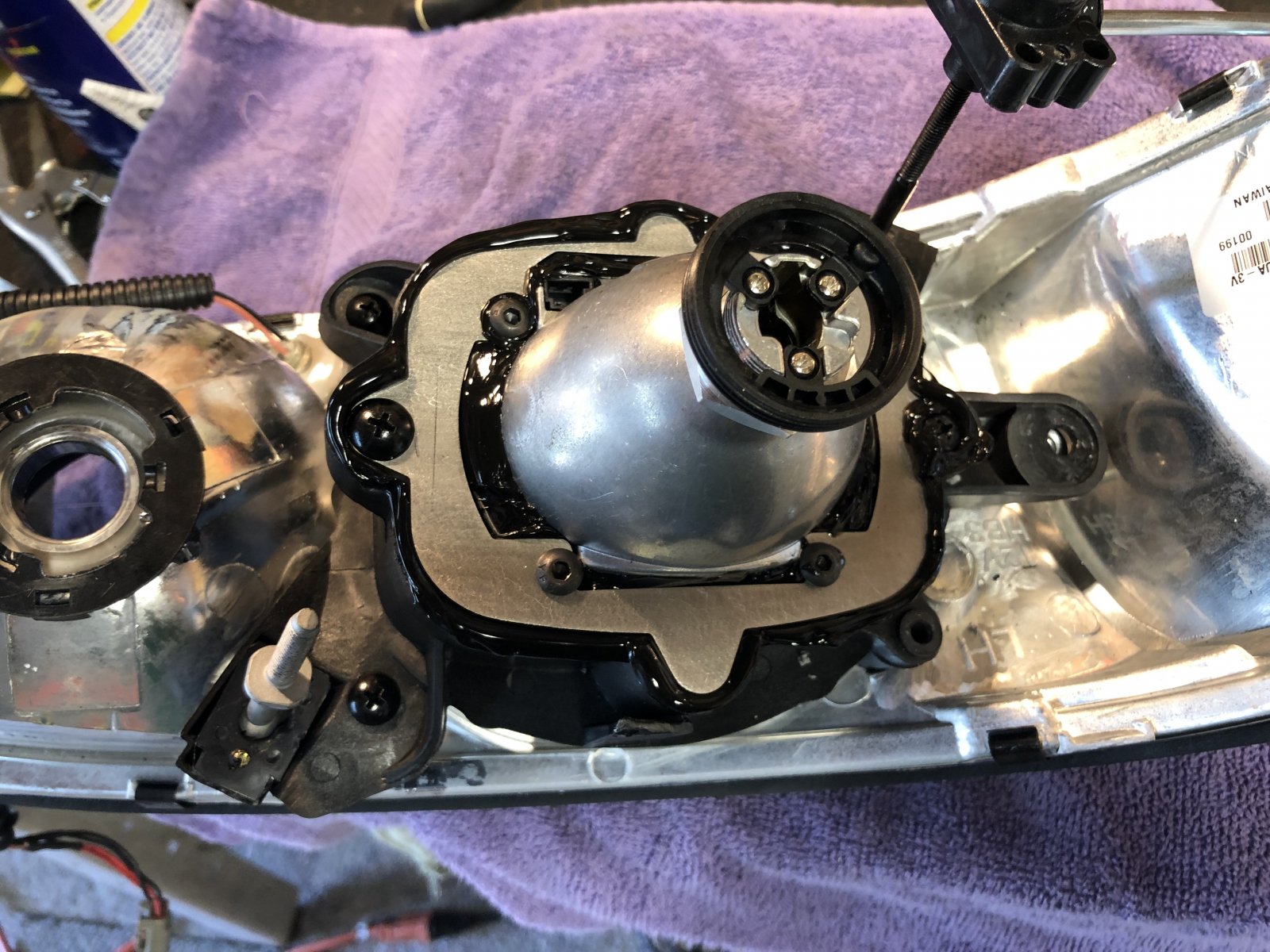

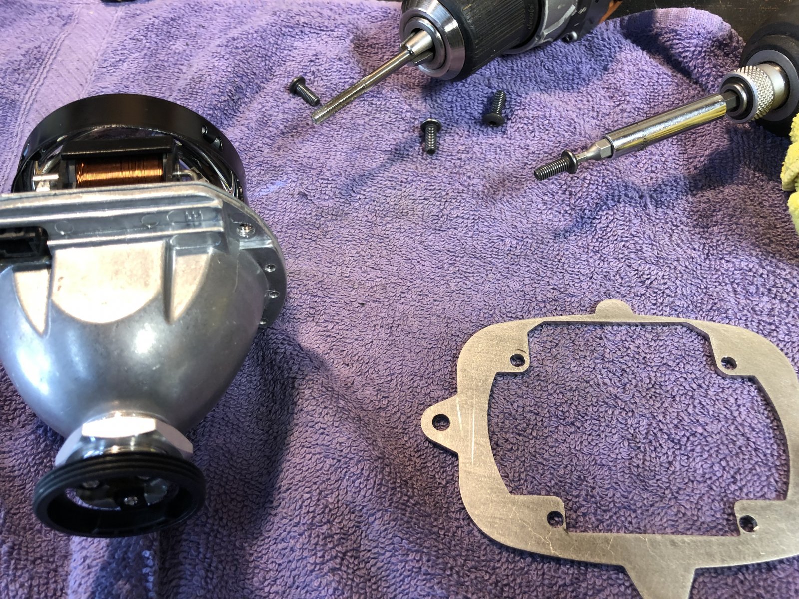

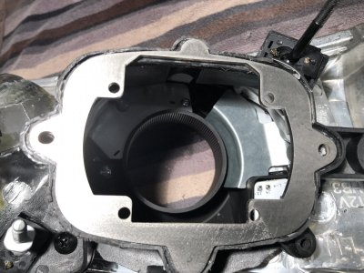

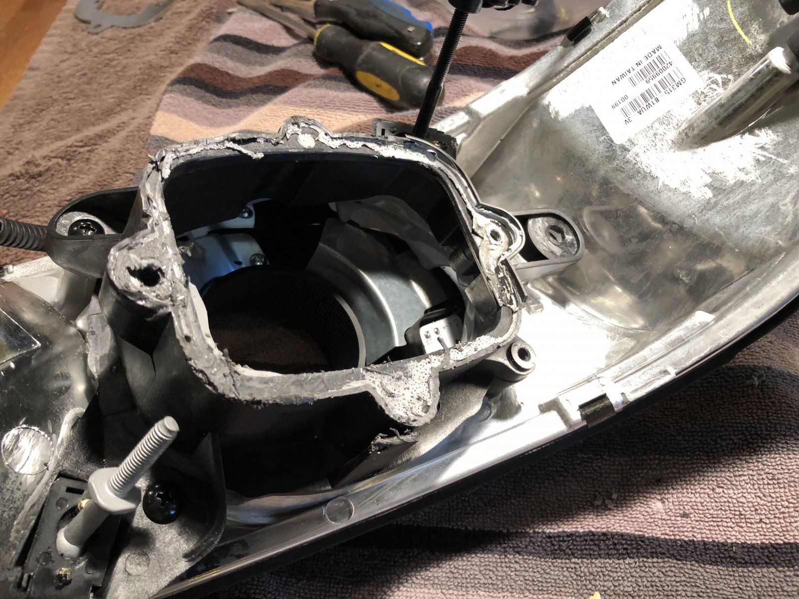

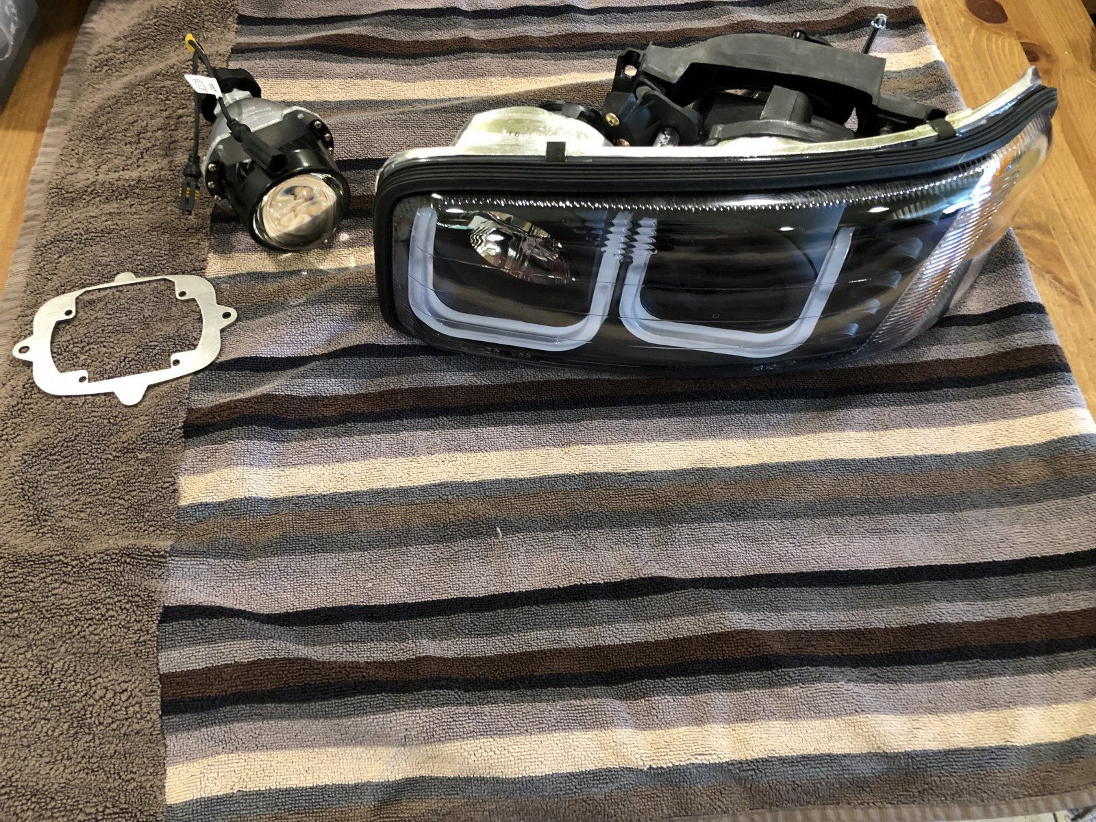

Then I checked the bracket for a fit (whew) cleaned up the mounting surface and tried the Morimoto's. They didn't quite fit until I trimmed a bit inside the headlight with an angle grinder. The holes in the mini h1's were the perfect size for a 10-32 tap and then I bought some allen head button top screws to attach the projectors to the brackets. I used some black RTV and mounted the projectors. So far so good, waiting for things to dry before proceeding.

View attachment 227215 View attachment 227216 View attachment 227217 View attachment 227210 View attachment 227211 The adventure begins. Here's the headlights... and second pic is the back. I took a look before starting and it looked like the brackets would fit, so next I removed the adjusting assembly. Man it looked like this was gonna be soooo easy, 2 screws to remove the projectors but then what was that grey stuff oozing out from around them? Hoped it was silicone but nope, it was some of that permaseal or whatever that stuff is that's really hard to get apart. I started using my best razor knife and some new blades, cut a little until I could get something in to pry. I tried a heat gun and it helped a bit but pretty much just had to muscle through it. My arms were sore after the first one.
Good thing nothing cracked or broke while prying it apart.

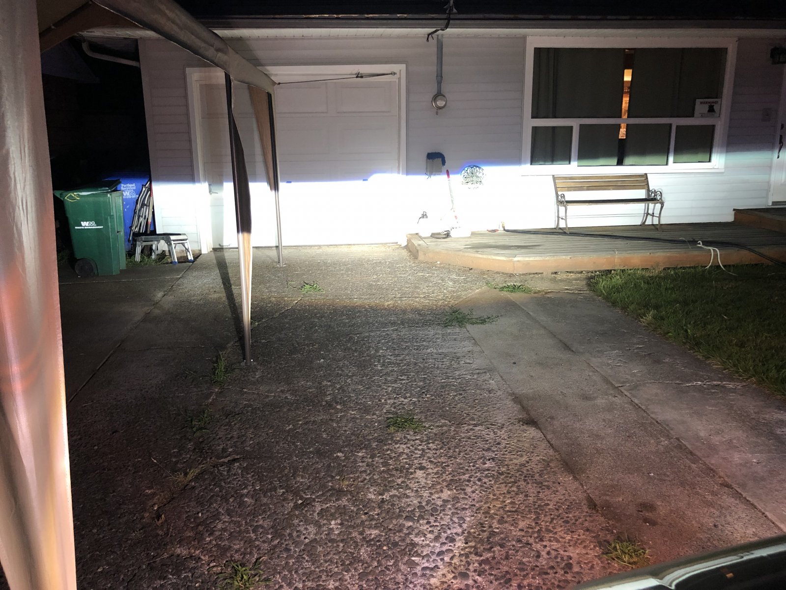

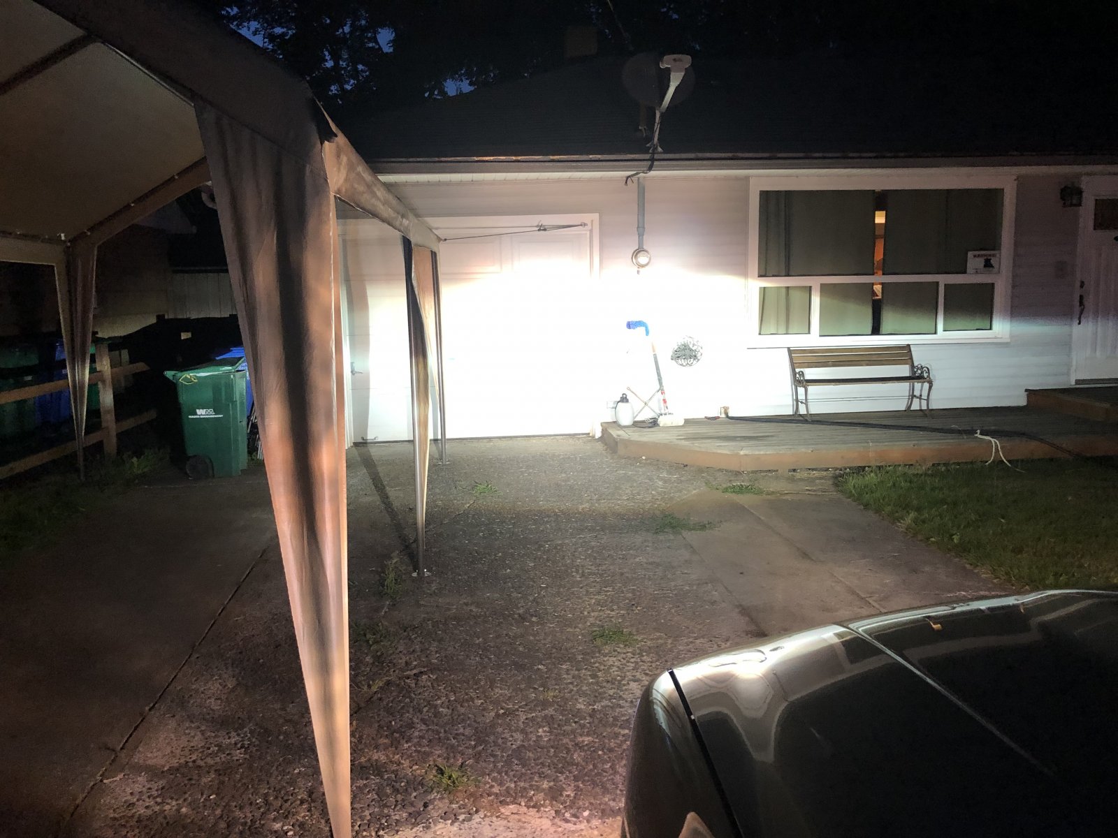

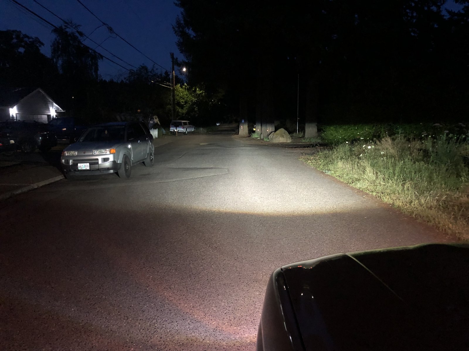

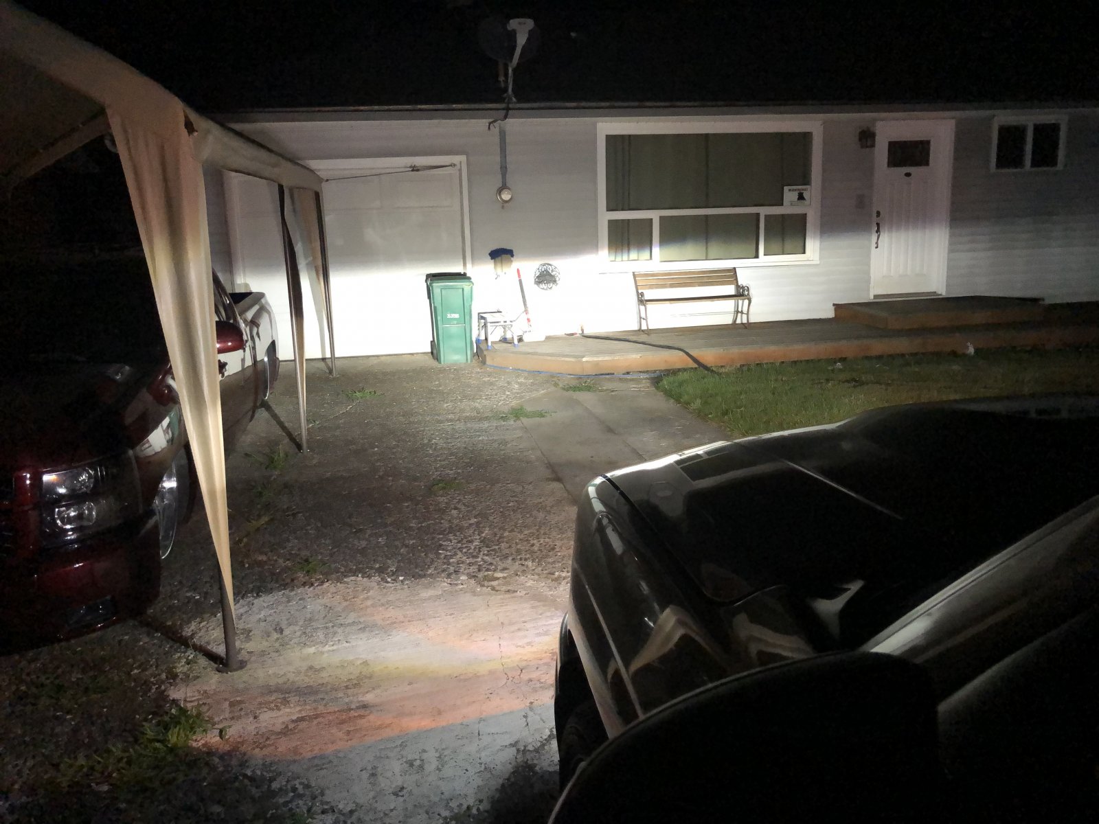

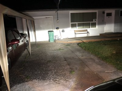

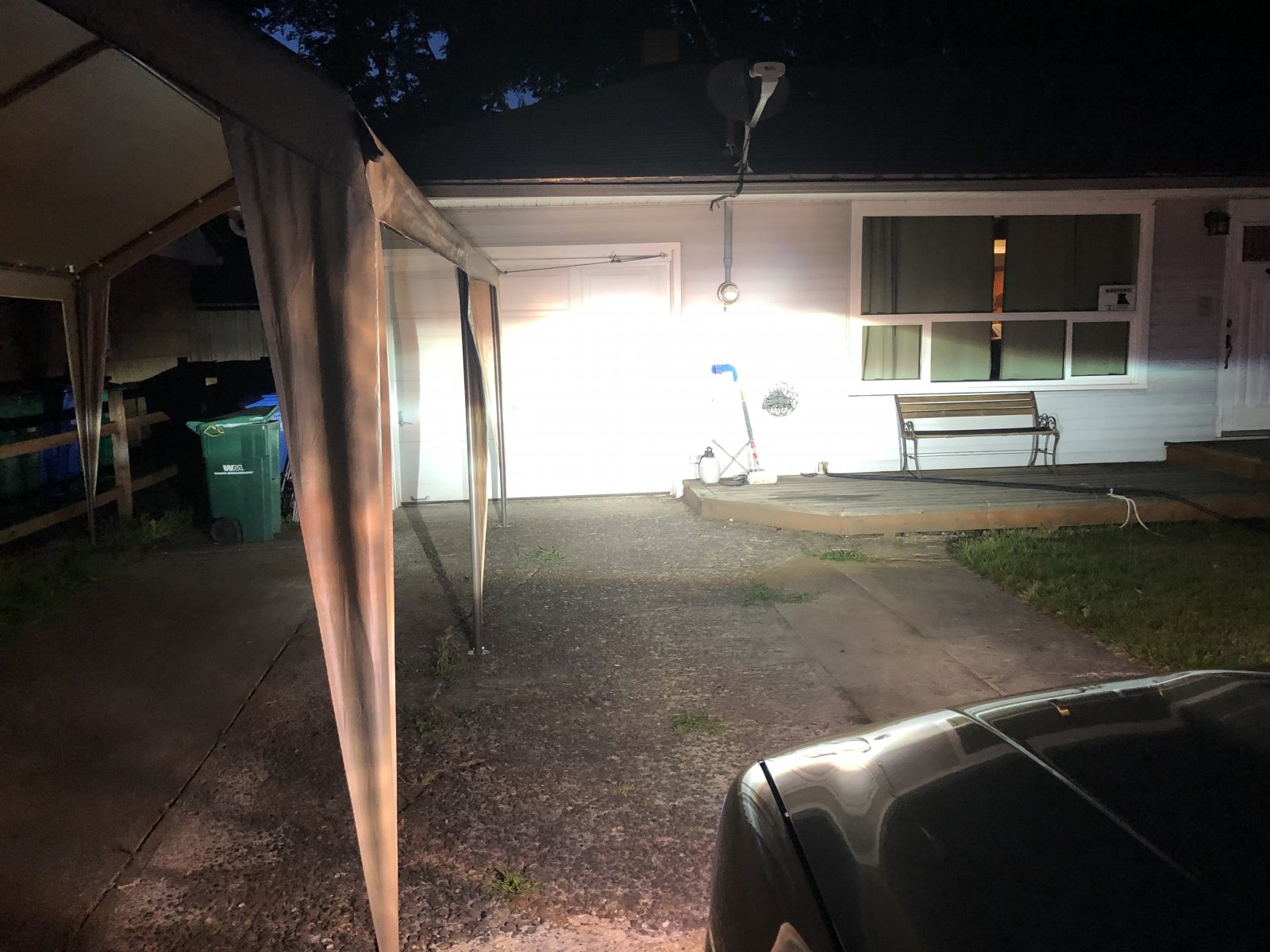

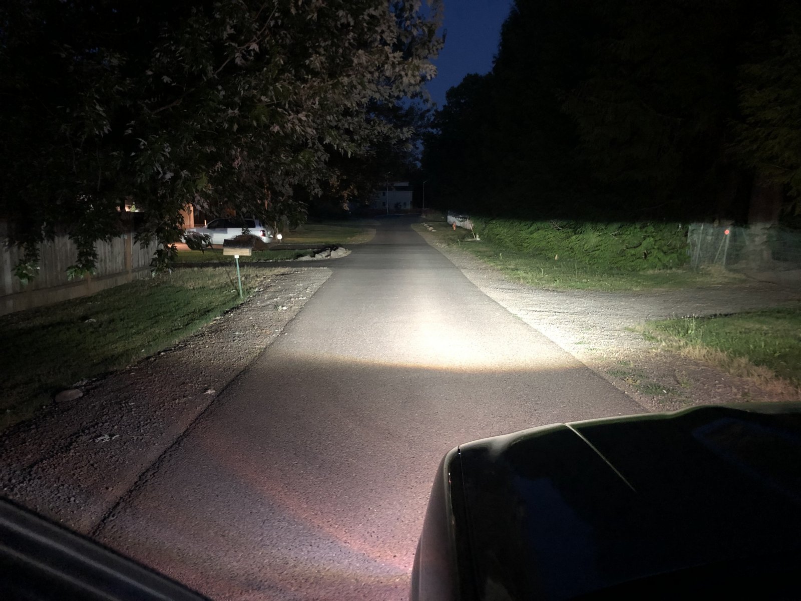

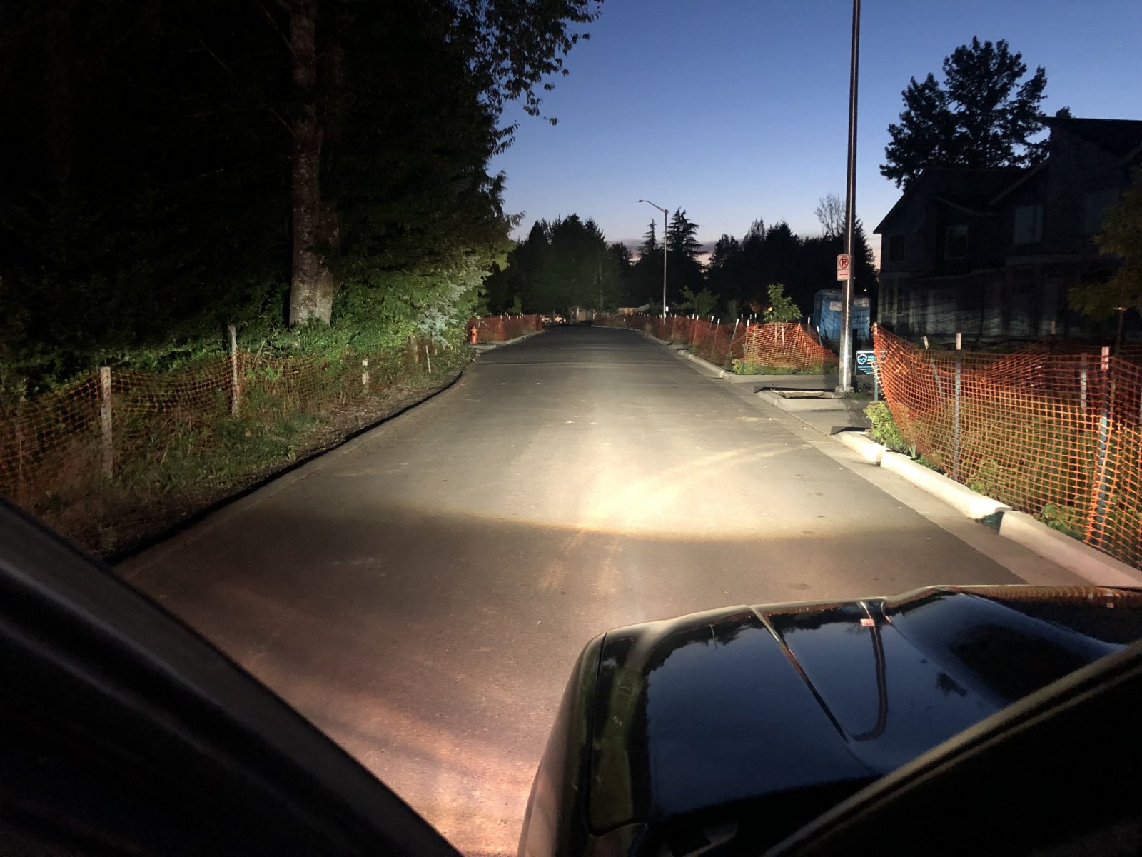

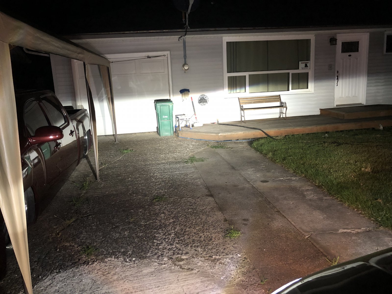

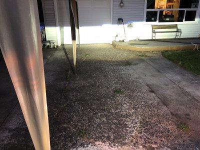

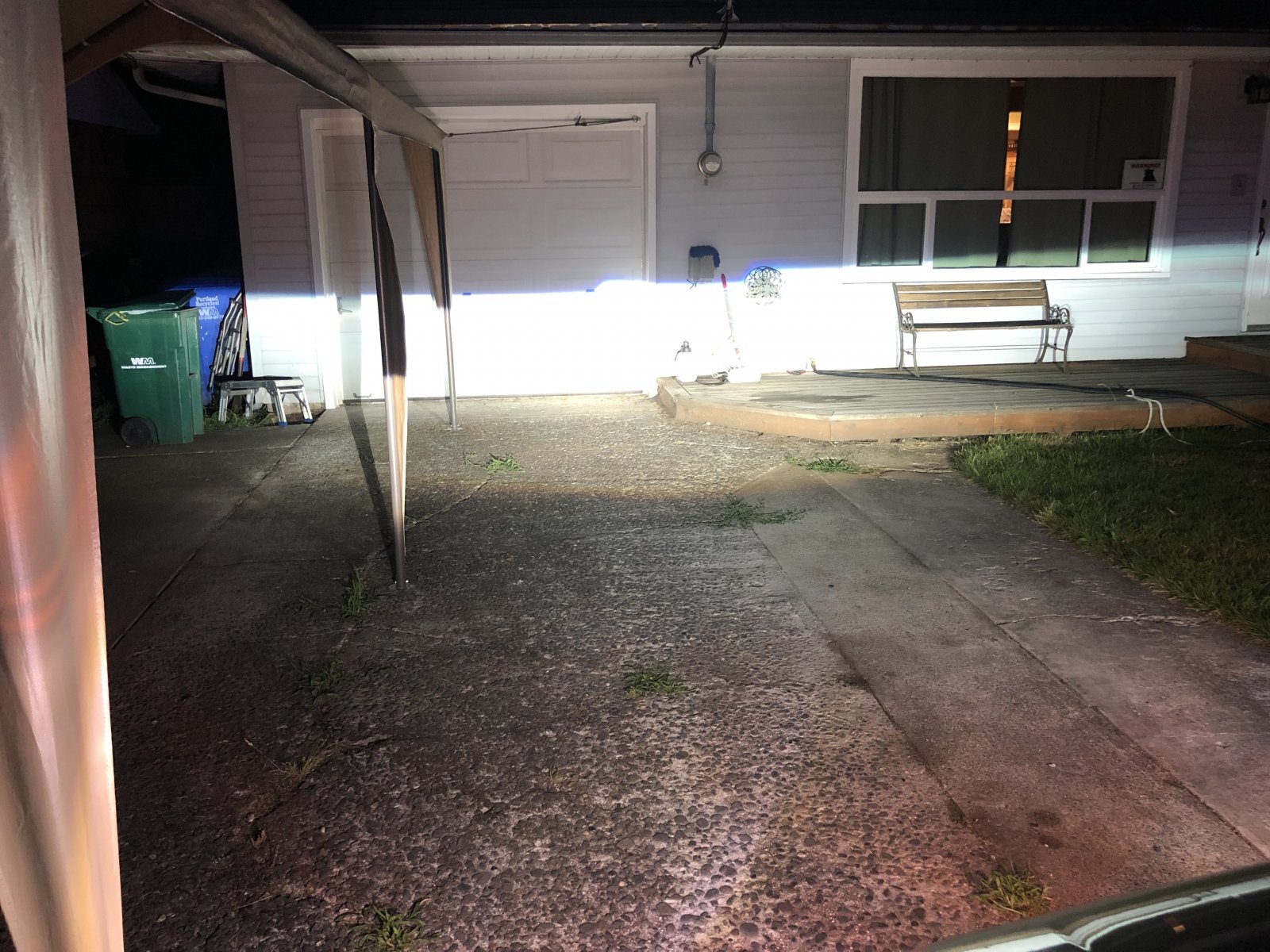

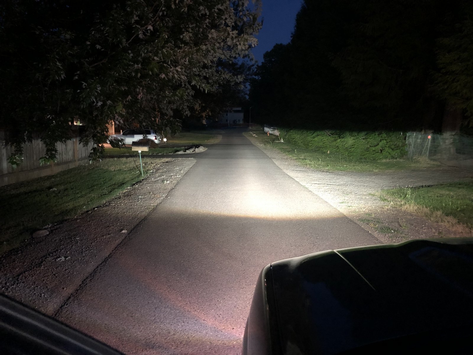

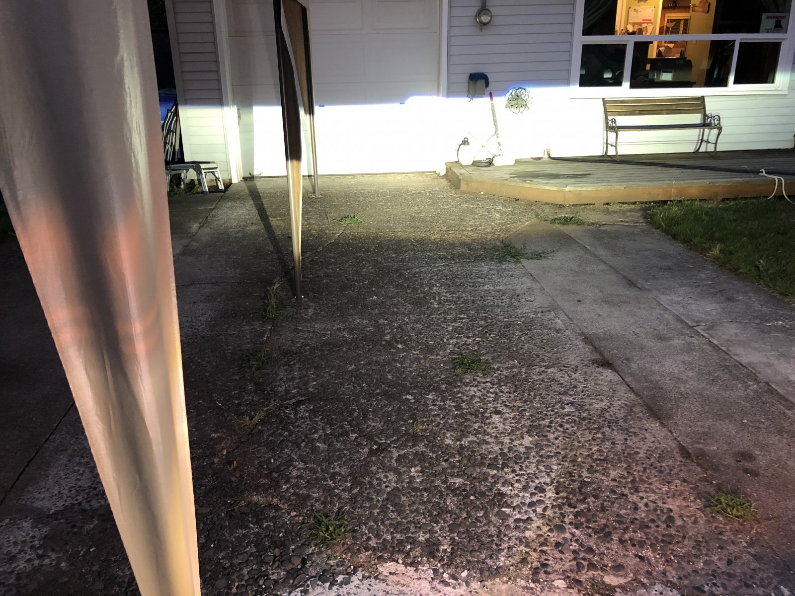

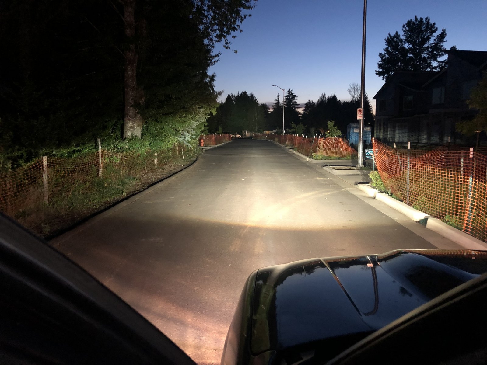

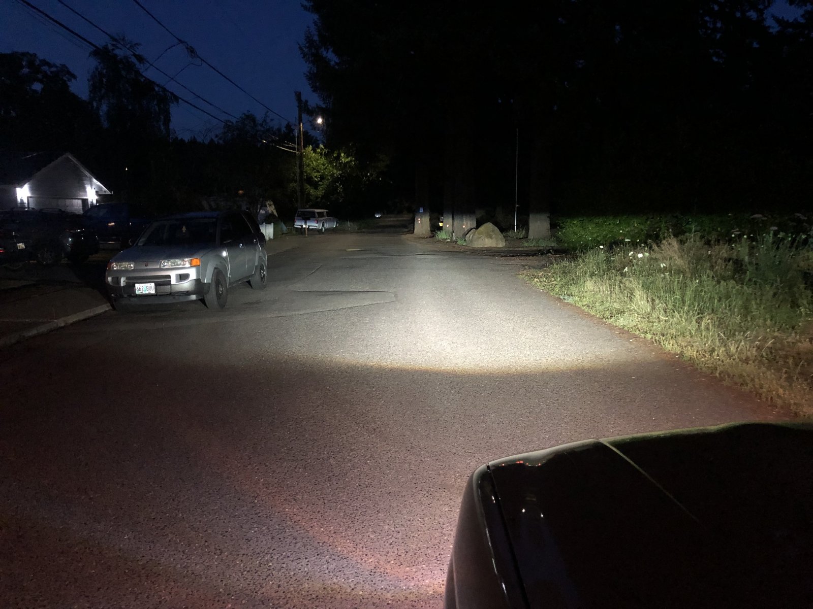

I forgot to post the before pics of output on the garage door. I should have taken shots of the road too but I can say they weren’t that great of projectors to start with. Here’s before and after on the garage door.
9FF7F8BC-2879-4827-830A-61761755E159.jpeg C4CFD81E-06D2-4299-A8D7-8E08C9E33CC8.jpeg A69CE2A9-3378-43D5-922B-51EF4D41A406.jpeg 252CB22C-9044-4CF5-8334-98BB31DA6362.jpeg
26,678
52,943
Those look ****..! Great output, and the lights look badass! Nice work!
Thanks Sam.
ETA: I think this setup is a good one. I’ve been trying to determine what to do with my crappy replacement OEM housings and LEDs.
Help me spend $$$ [emoji1787]
Yep, I’ve been waiting to find some headlights I was really happy with to do a retrofit on. These finally got me excited enough to spend the money and time on. And actually the retrofit was pretty easy compared to the Silverado ones I did. I’m satisfied.
