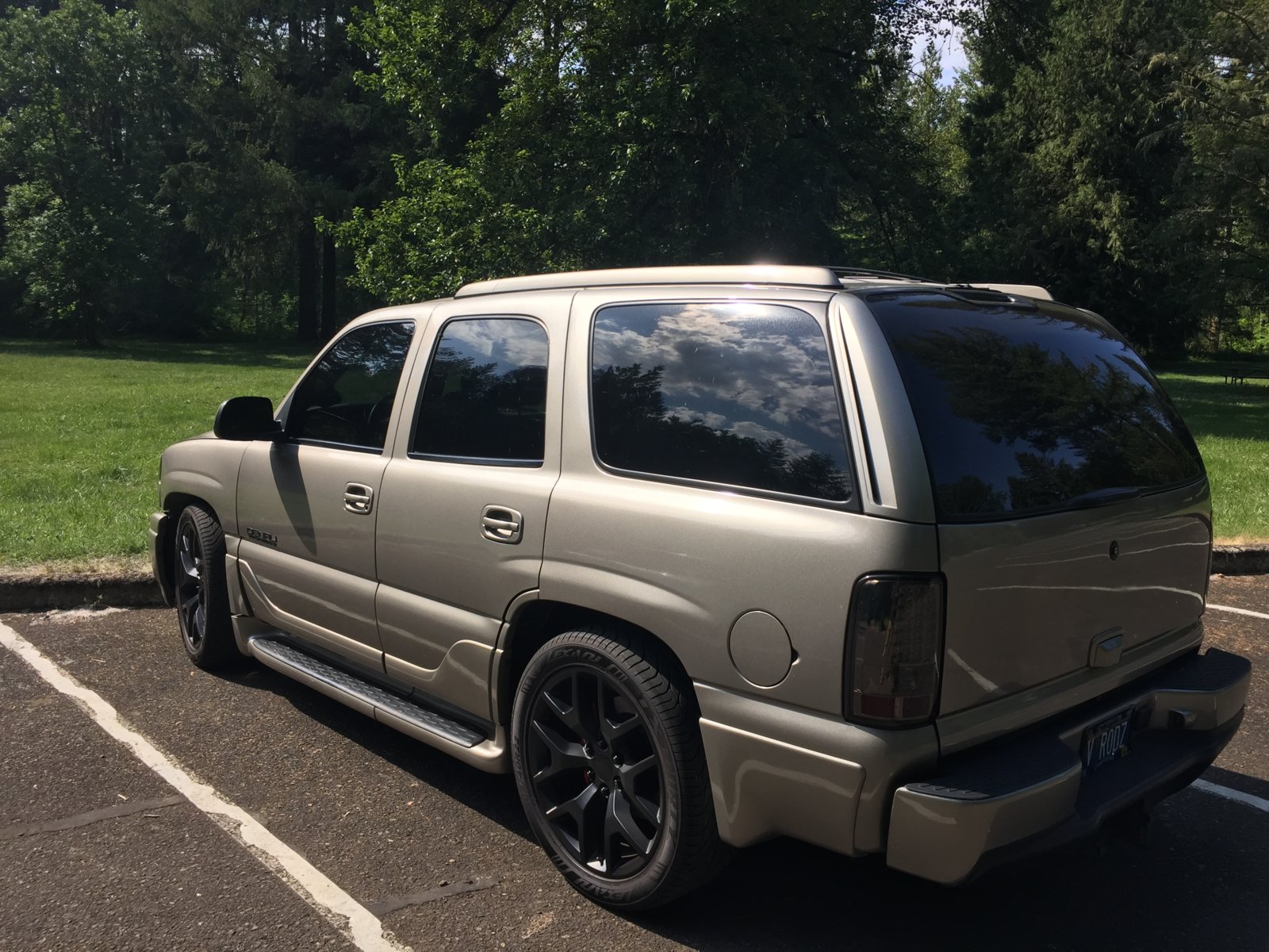

I thought those were your winter set though?
They are. The roads around here are still bad though, plus I'm considering selling the Dubs and buying a set of 26 reps like the 22's. I'm currently in a holding pattern of cash flow though. I need to settle with my insurance company on the motorcycle crash I was in and also get back to work. A man can only live on dreams for so long lol. Plus my Silverado is screaming for some stuff too.
