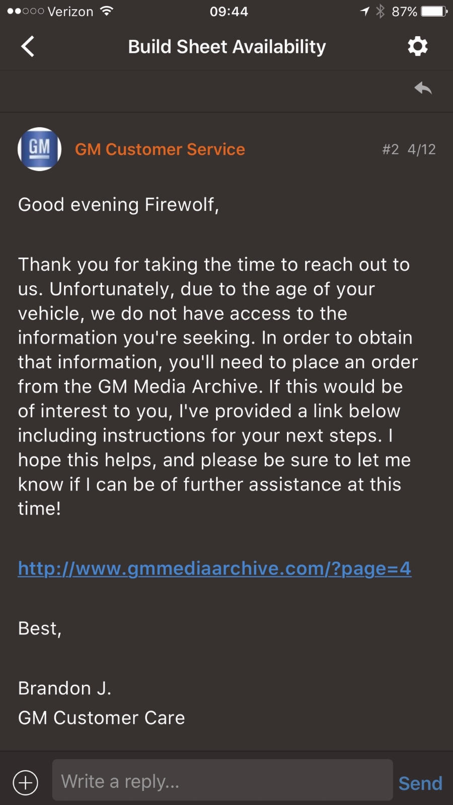

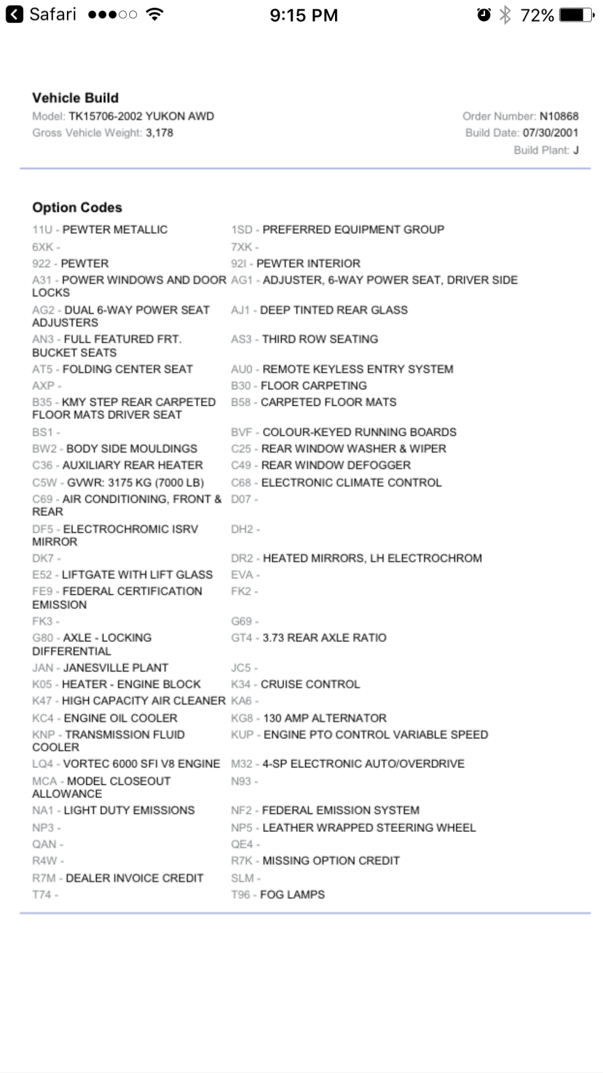

Here's the PDF build sheet I got from GM Customer Service.
  • Red Rocket Build Sheet.PDF
PG01
Nov 6, 2016
15,686
21,100
Up here to the right
52,949
I downloaded, enlarged and screen shotted it for ya....sorry

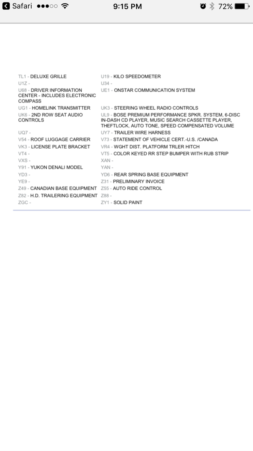

Thanks, I was having difficulty with that. As you can see, she was a Canadian , eh? I suspected since the HVAC controls were in Celsius but the speedo was in MPH. Someone had done a partial conversion and I finished it off with US Esky HVAC controls.
52,949
I've noticed with my build sheet that all the RPO's in my glovebox aren't listed at all, like KUP (throttle control electronic) aka drive by wire and some RPO's are listed but not decoded, like NP3 (transfer case AWD) so although it's pretty cool, nothing beats taking a picture of your RPO codes from your glovebox and filling in the blanks with an RPO code list.

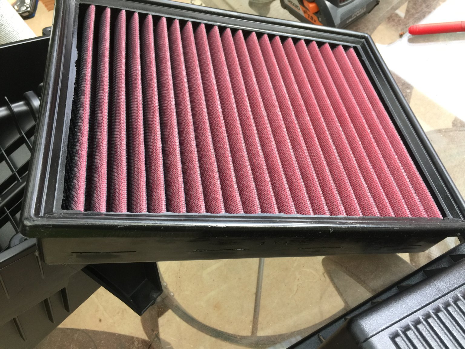

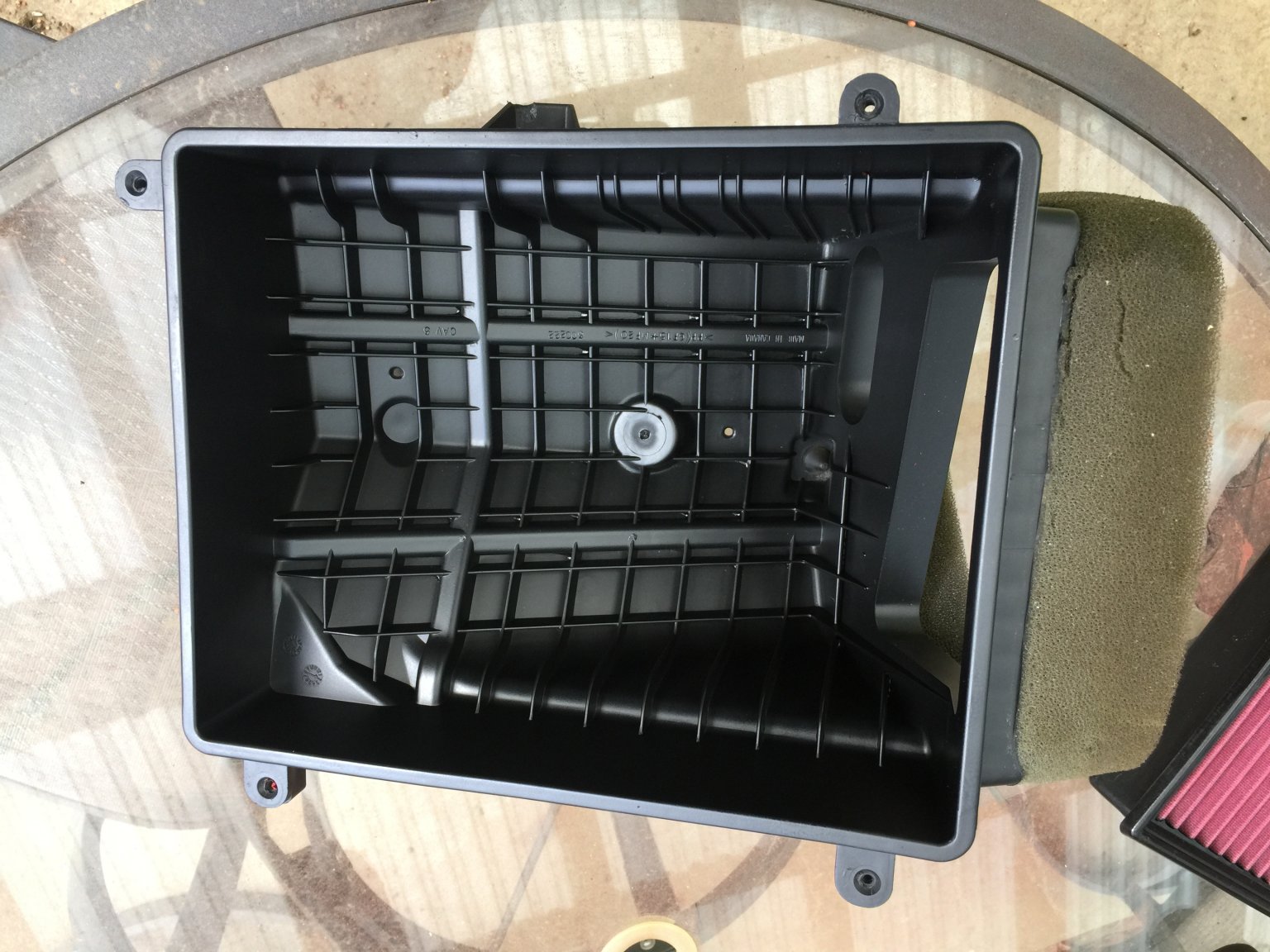

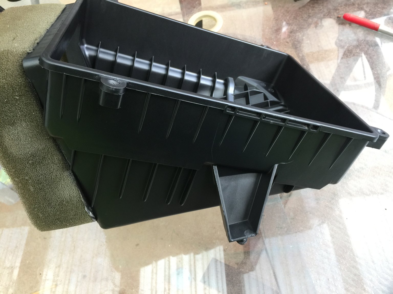

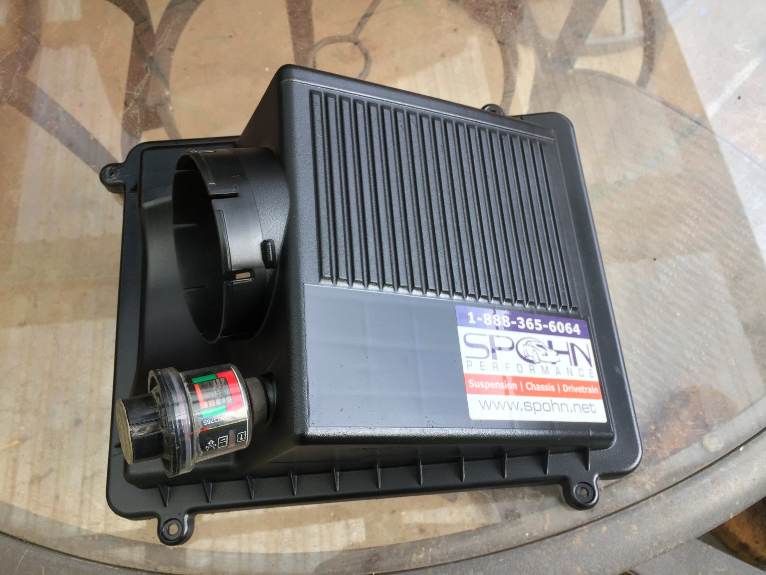

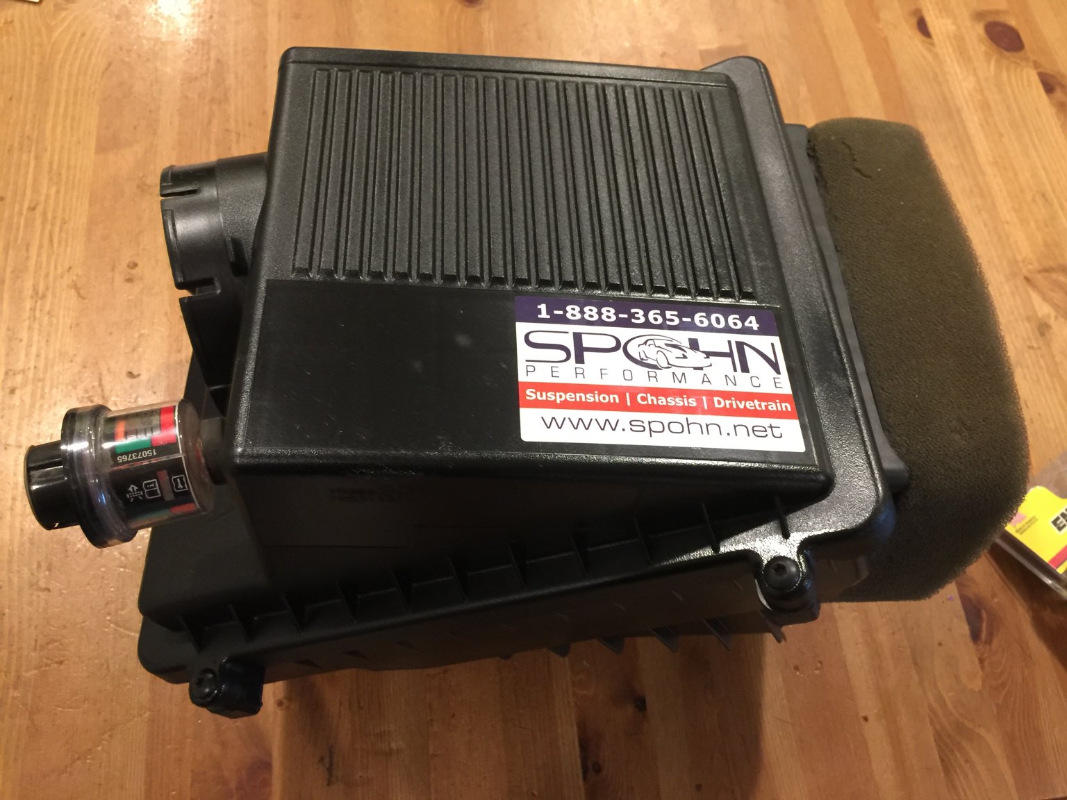

I got the factory air filter housing today (thanks @67RS427) and it had a couple cracks around the screwholes that hold the 2 halves together so I mixed up some Fusor panel adhesive epoxy and fixed them, then cleaned and painted it with Krylon Fusion satin black. I need another sticker that fits just right in the left over space from where the 2007 CARB label was. Fitted it with the S&B oiled filter included with the Whipple and it's ready to go!

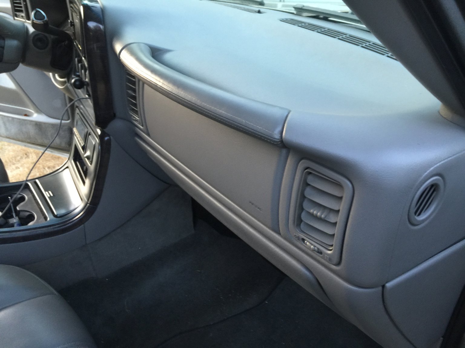

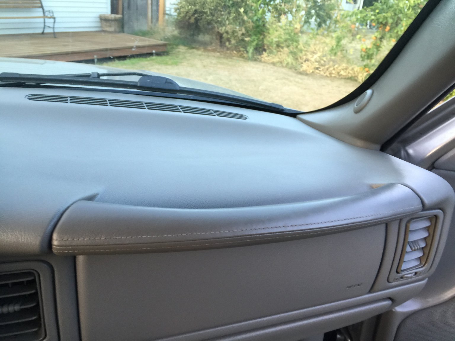

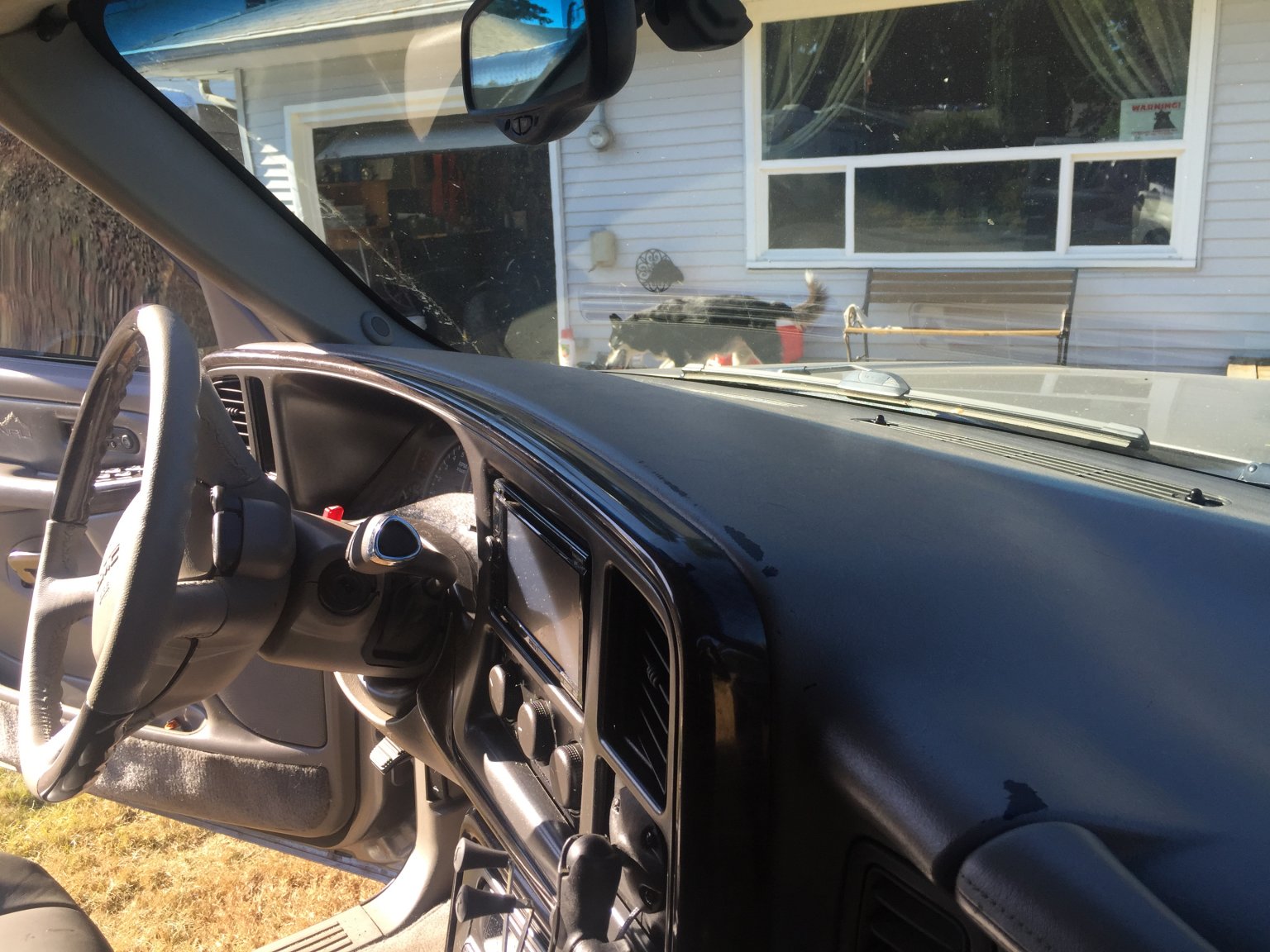

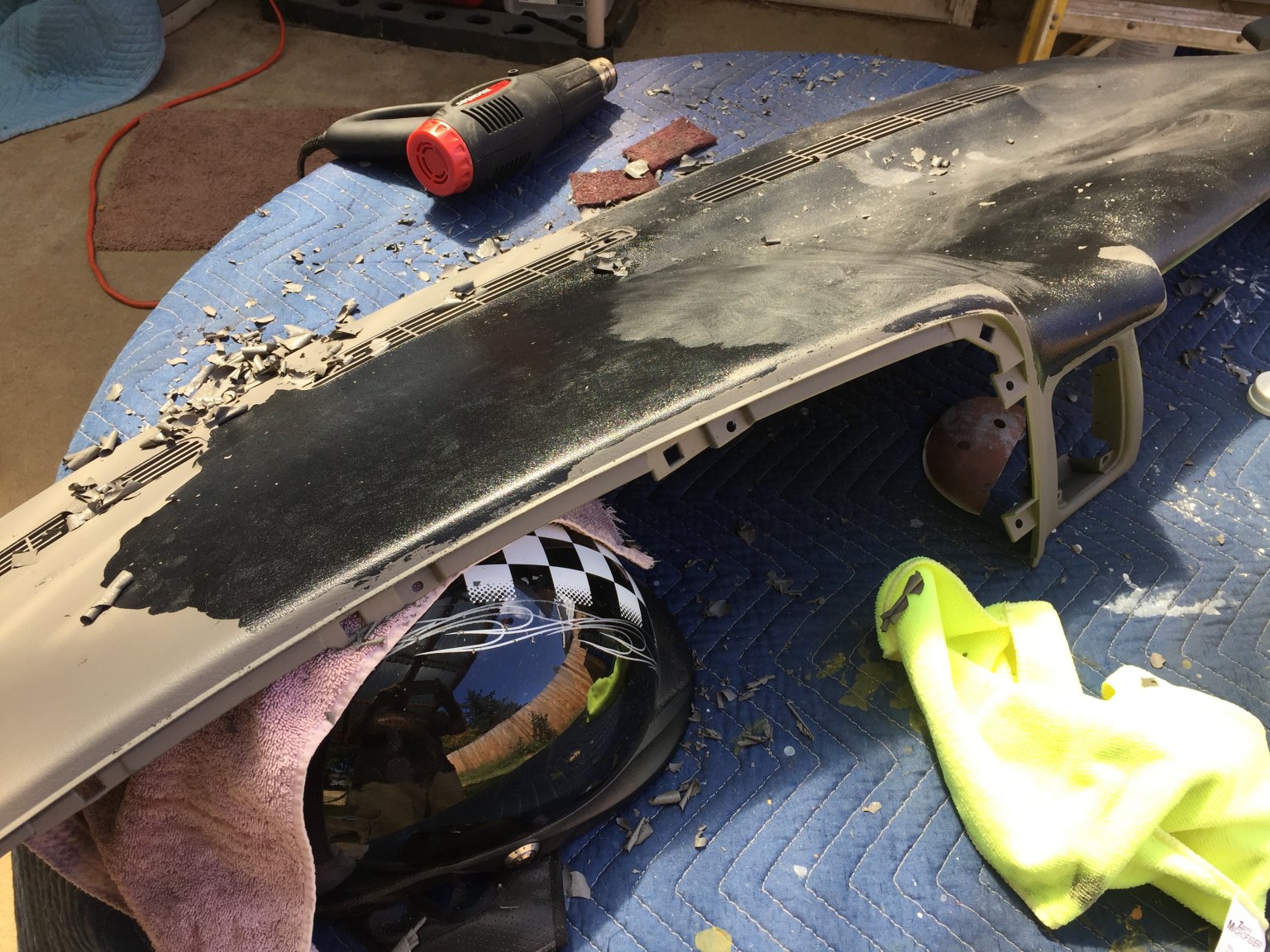

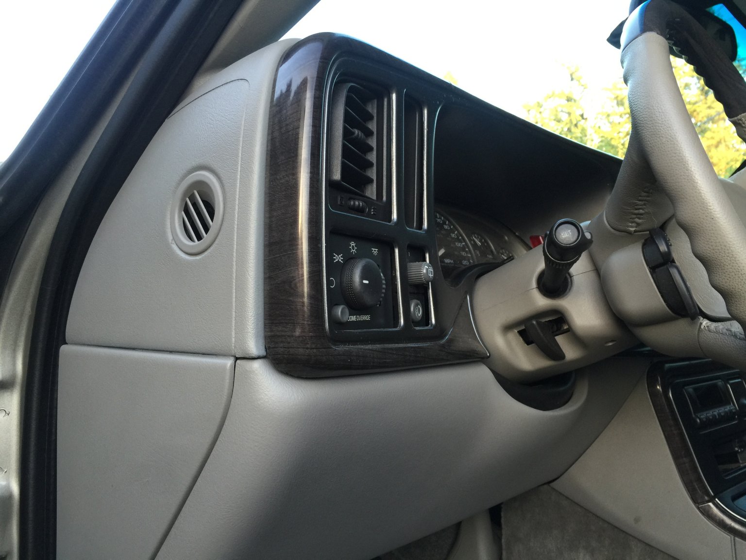

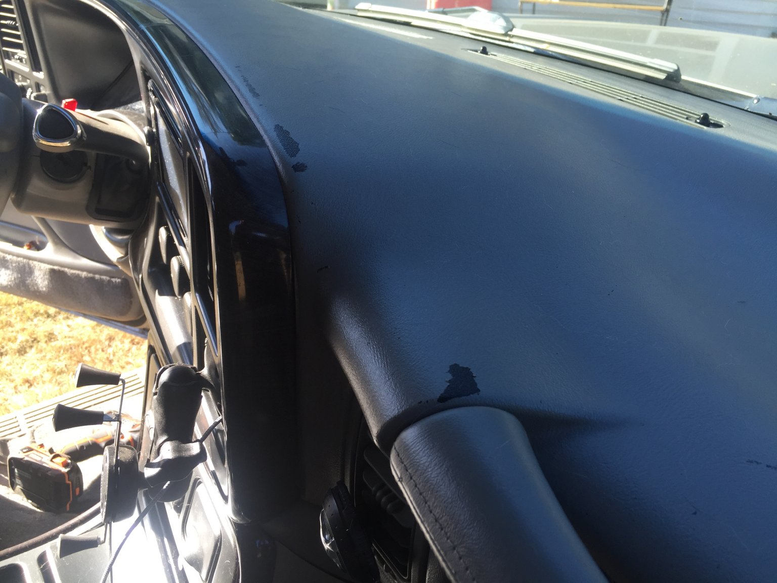

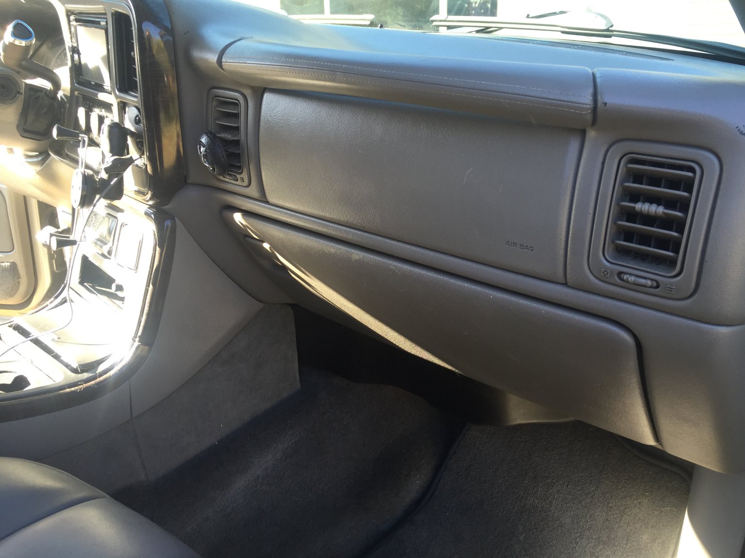

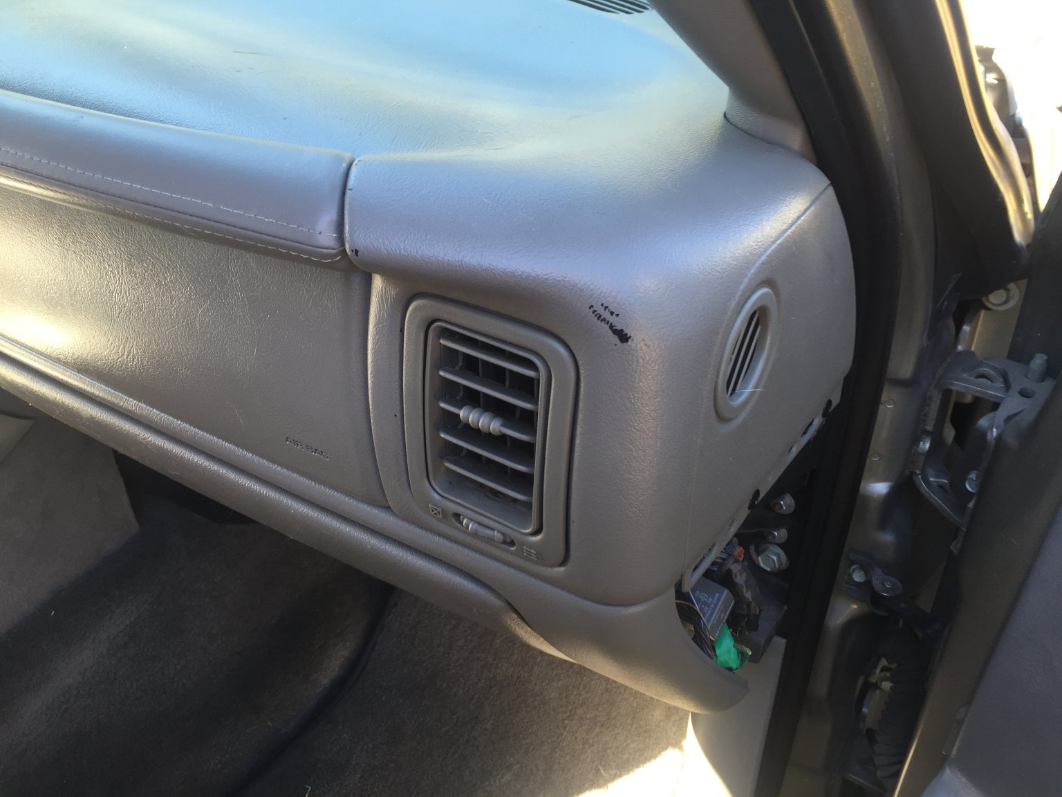

I have also repainted almost all the entire console, as well as the dash and surrounding areas. Here's some before pictures of the dash.

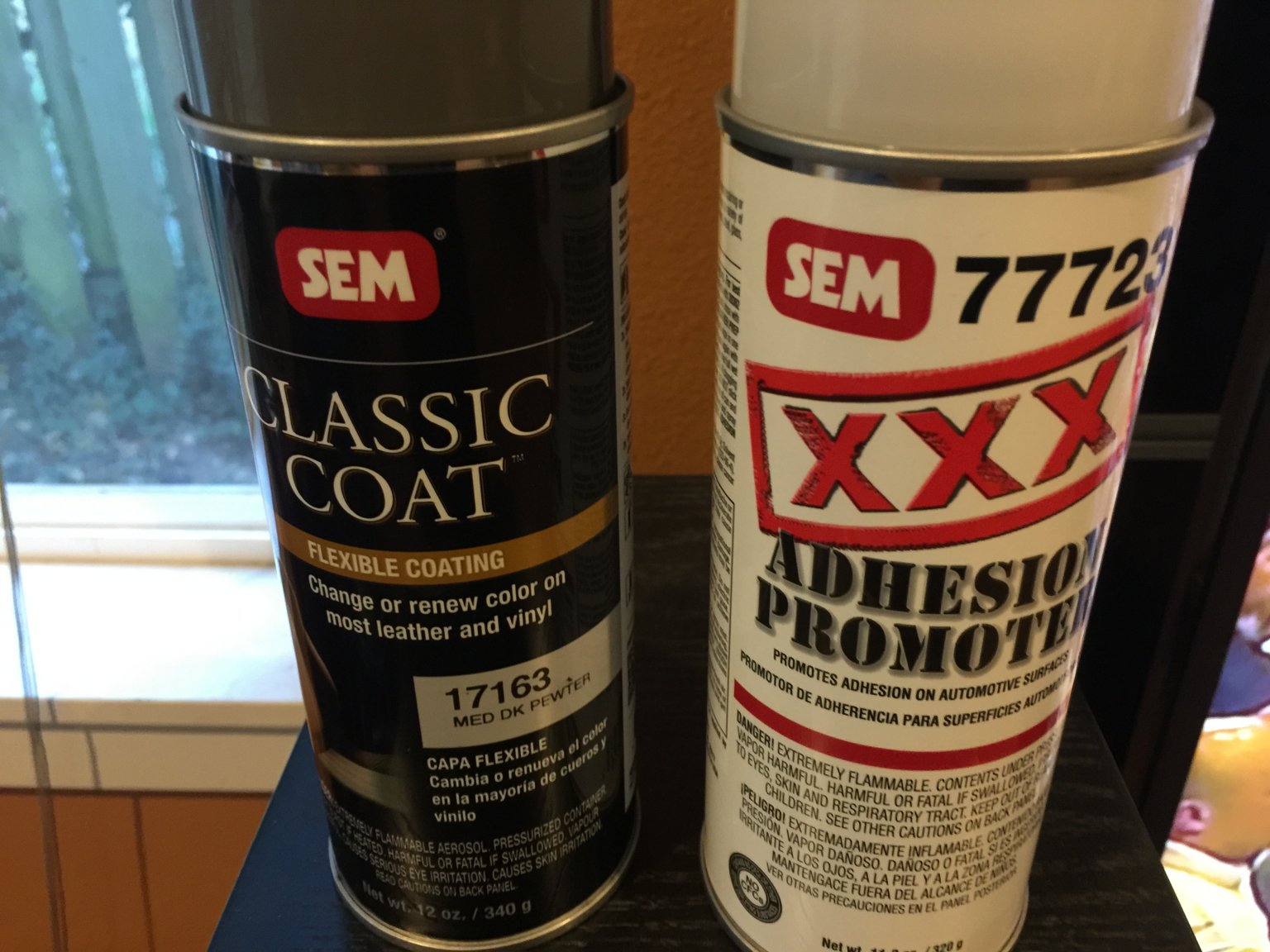

Hey man if you don't mind, what all was your process for everything? I want to do the same thing, repaint it and retain the texture.
52,949
I'm pretty sure it's all detailed in the thread isn't it? I know I talked about removing all the paint on the dash with denatured alcohol and Scotch Brite pads then used SEM adhesion promoter and sprayed with SEM paint and clear. The stuff that wasn't peeling I just cleaned with Dawn dish soap and Scotch Brite pads and followed the same process as the stripped parts.
