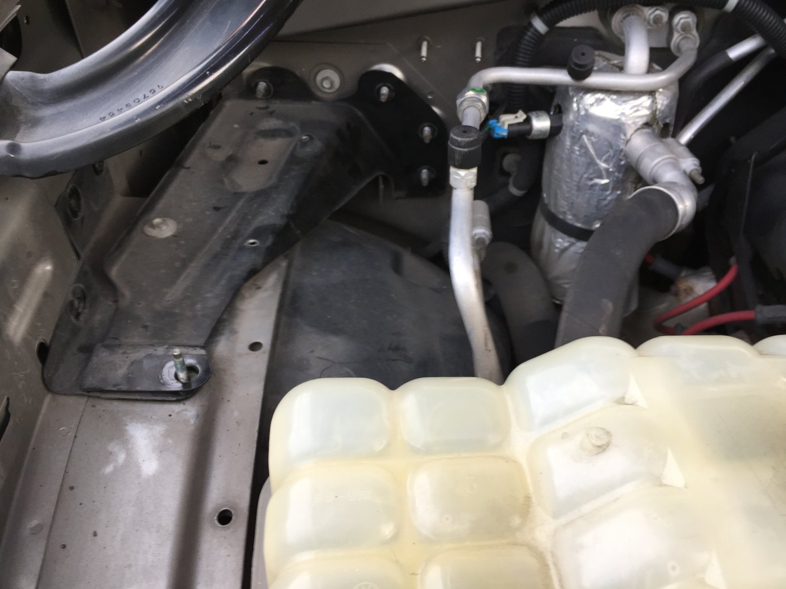

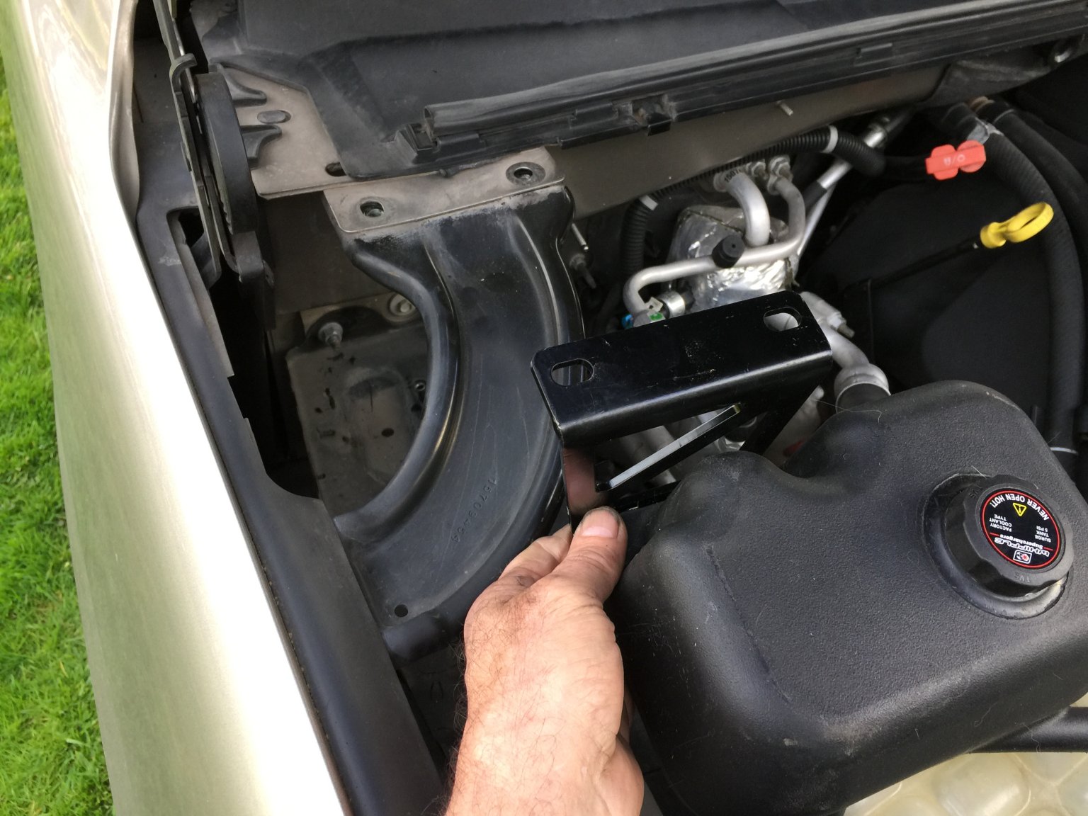

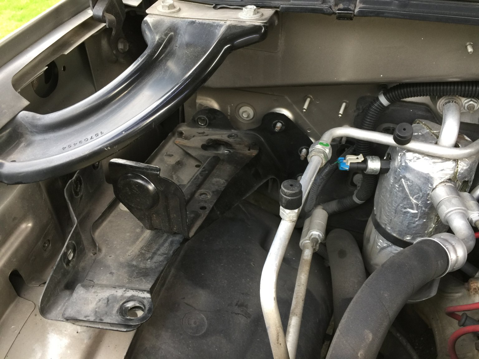

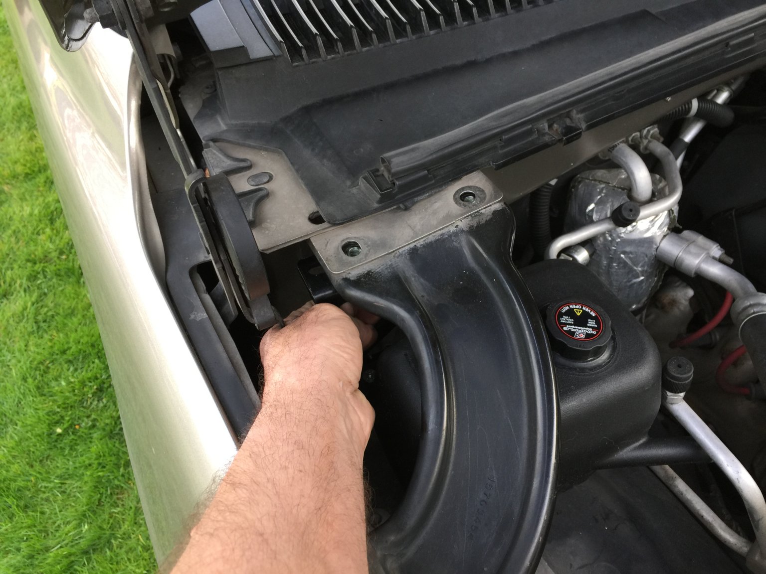

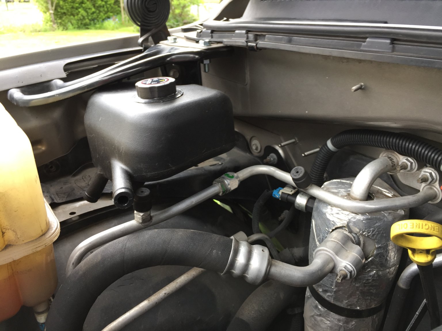

I've been reading and re-reading the Whipple instructions so I can be ready when the time comes. I was checking today to see if there's anything I can do ahead of time that doesn't require wasting my time taking things apart that will need to be taken apart later anyway and decided to install the intercooler overflow tank. First thing I realized is it goes right where I had relocated my jack from the rear when I did my sub install. Ok fine, I pulled it out and figure I'll find a place for it later. I know my proprieties lol. I installed the supplied bracket to the tank and when I tried to fit it where it's supposed to go, I can see it doesn't quite work due to my A/C lines being in the way. I think it's because this kit is for an 03-up since they don't make one for an 02. 03's were supposedly the first ones to come with drive-by-wire throttle but mine came with it and so the 03 kit will work for me. Of course there will probably be a few hiccups and hopefully they will be this minor. I have been guaranteed this kit will work so we'll see. So I'll have to mod something to make this work. It's too bad too, the bracket is top-notch stuff. Maybe I can just slightly change it. I'll figure it out tomorrow.

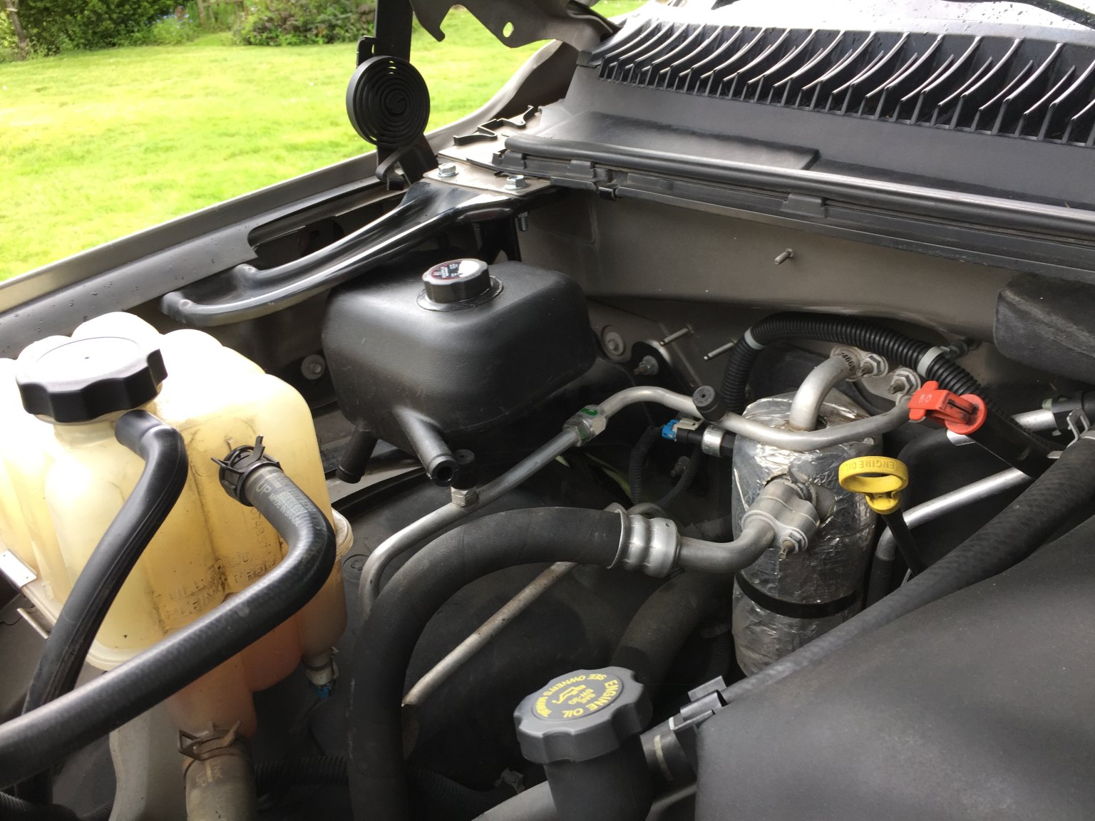

I managed to move the A/C lines out of the way enough to mount the HE overflow tank. It does make it hard to get to one schraeder valve but I can deal with it. I was going to pull the grill and mount the heat exchanger itself but it started pouring rain. I have to admit it's not the best use of space but in most cases that space isn't used. Unless you have a second battery there. Or your jack...

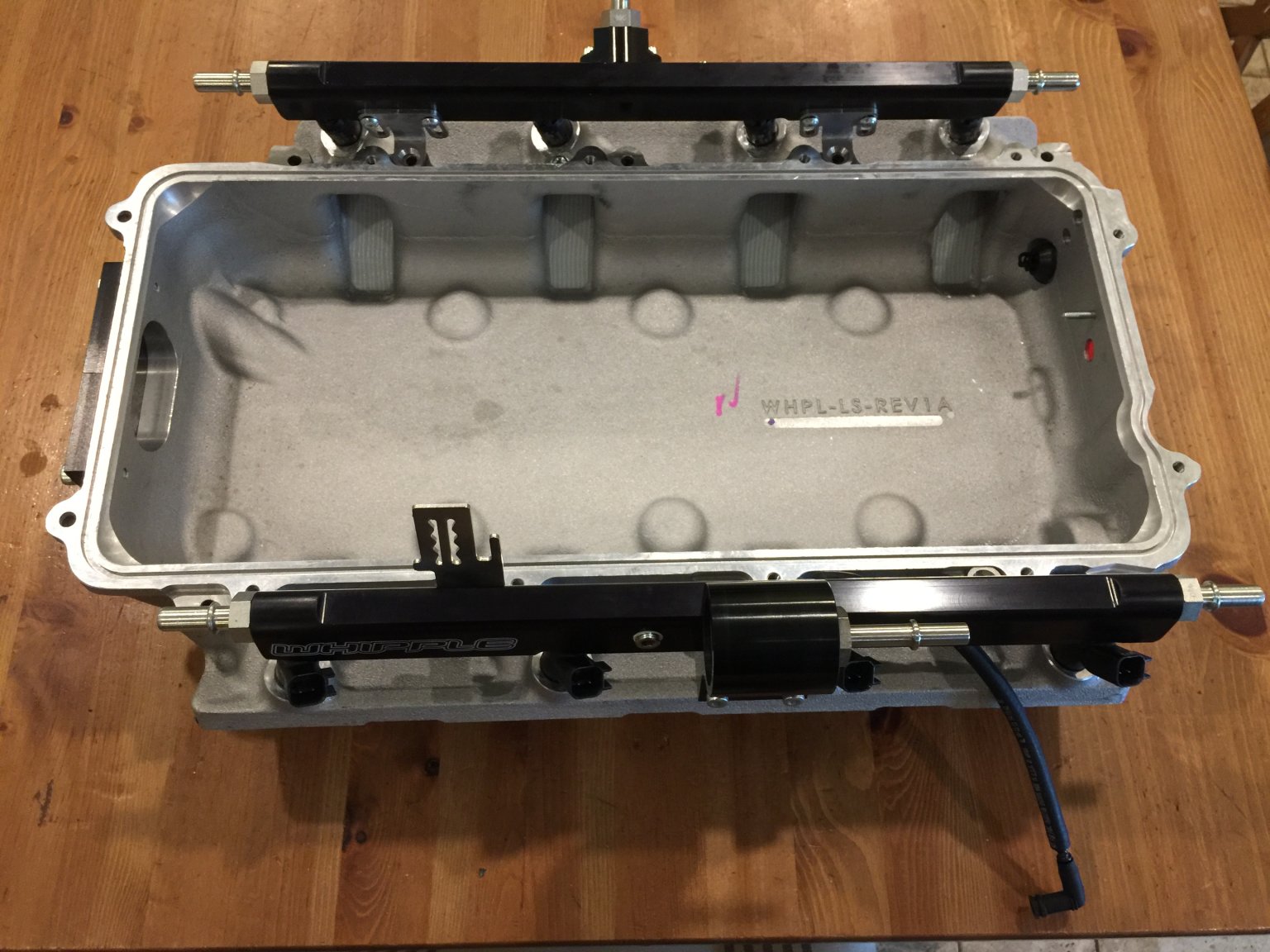

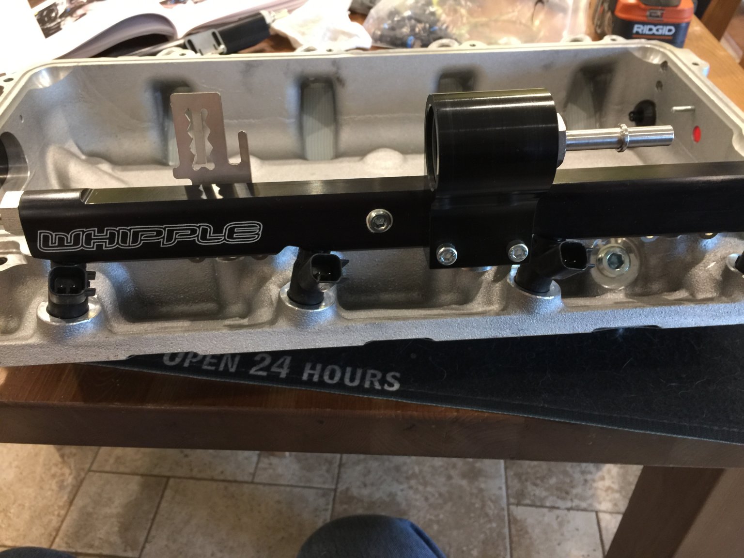

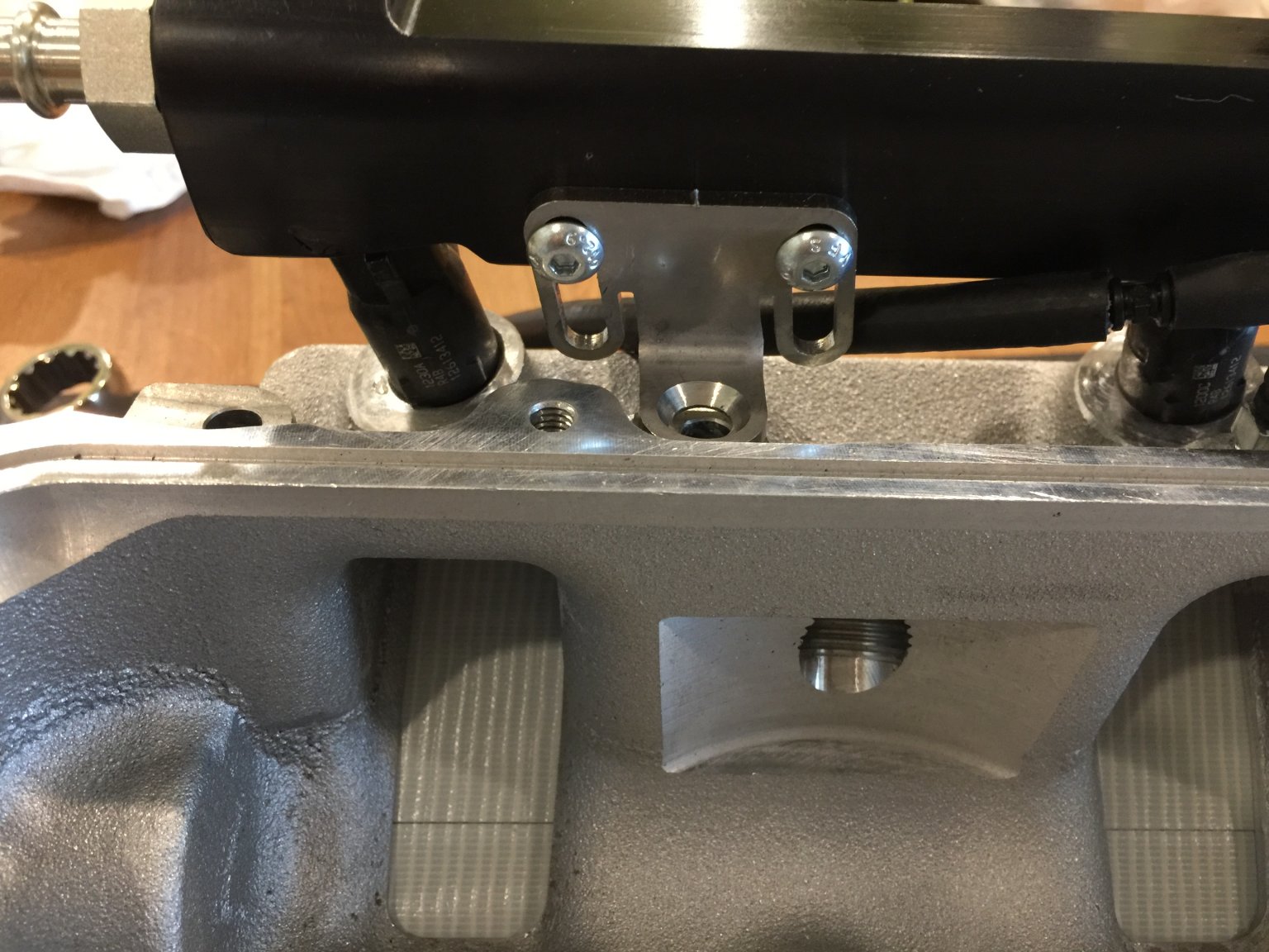

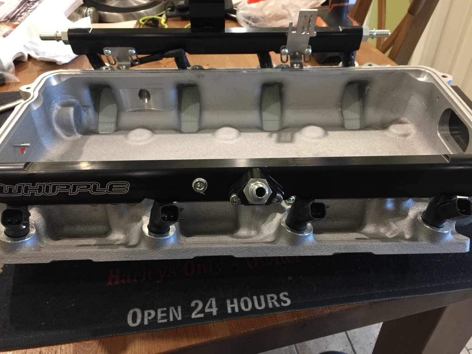

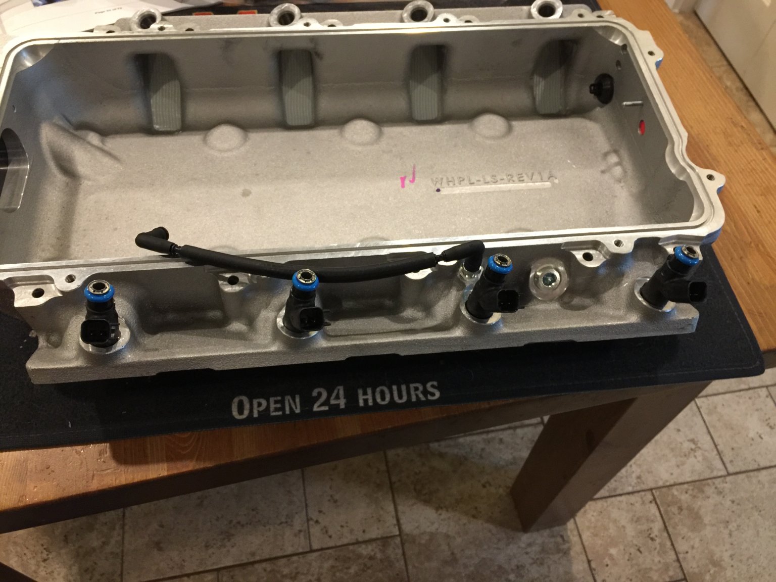

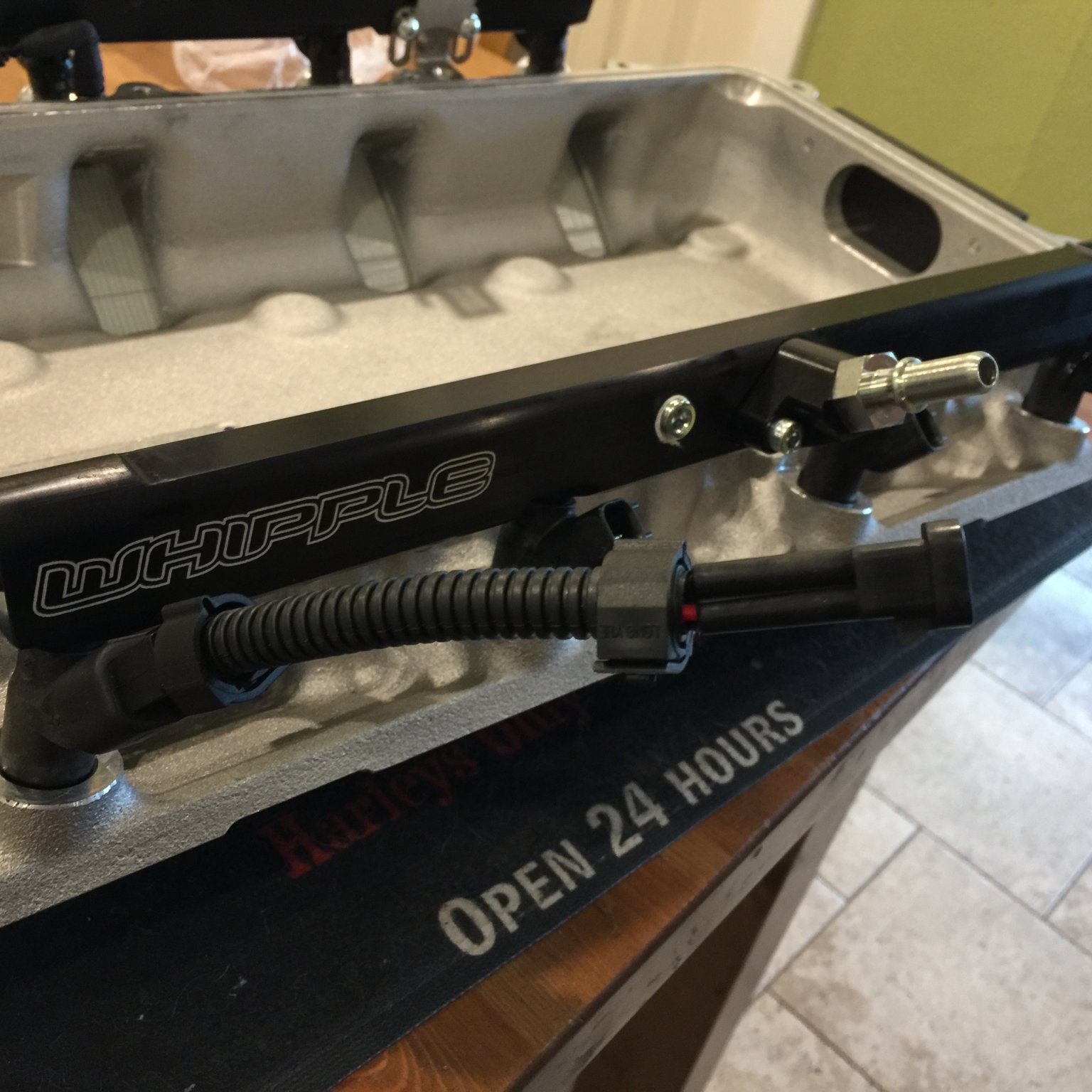

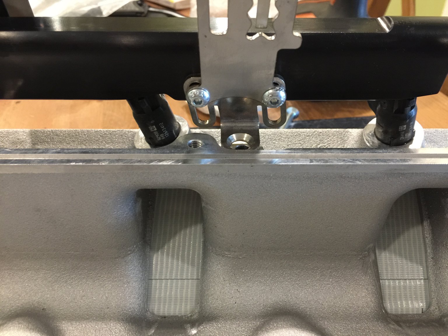

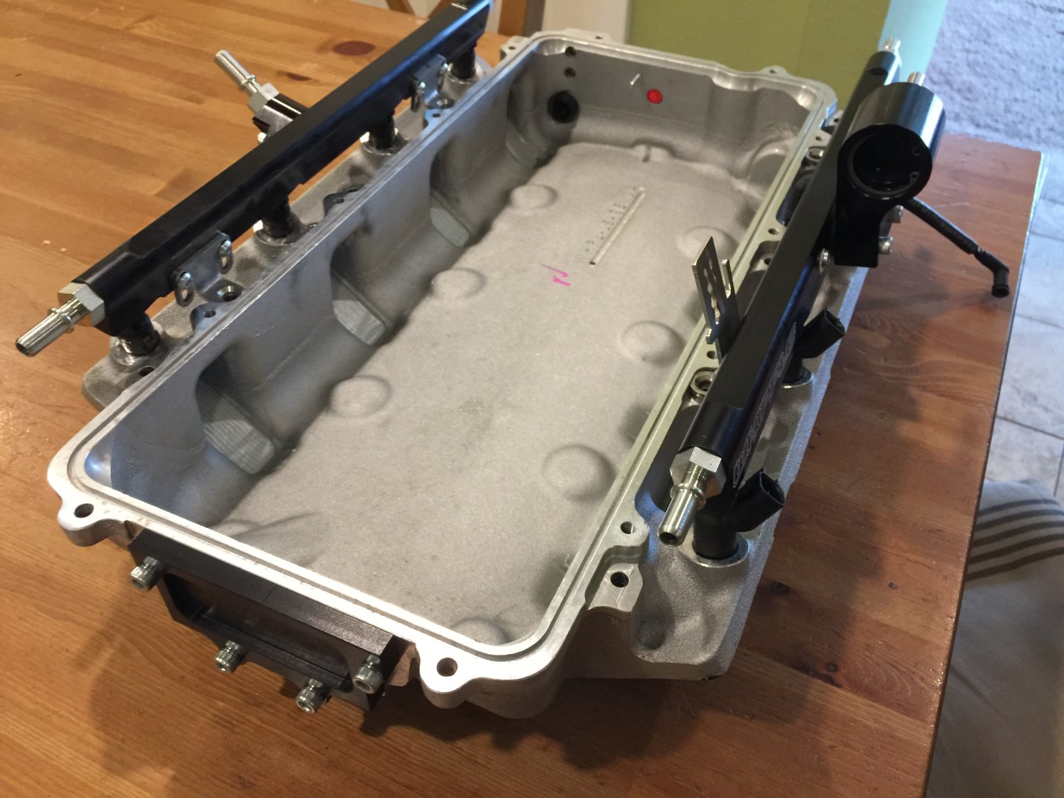

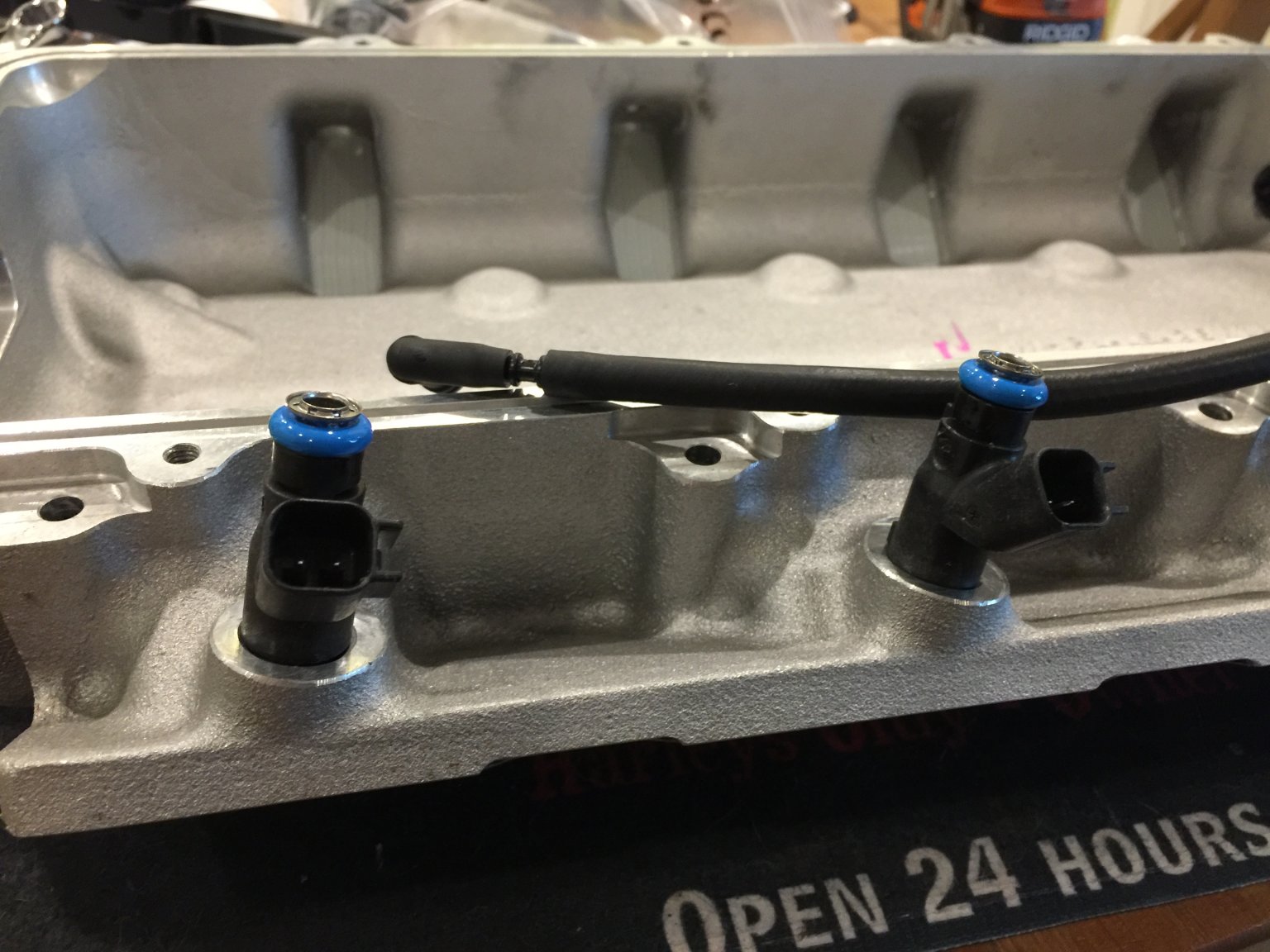

I decided to install the fuel rails and injectors onto the lower intake manifold. In the entire 72 page instruction manual there isn't anything said about this step other than to install the lower manifold with them on it. It was pretty straightforward though although I was a bit confused when I installed the first fuel rail and the mounts were 3/4" above the mounting surface. Then I saw they were adjustable. I believe the idea is to leave them up a little so that when you tighten the install bolts it pulls them down tight, so I left a gap of about 1/8". The bolts that hold the fuel rails are part of the 10 that are used when installing the lower manifold.
52,956

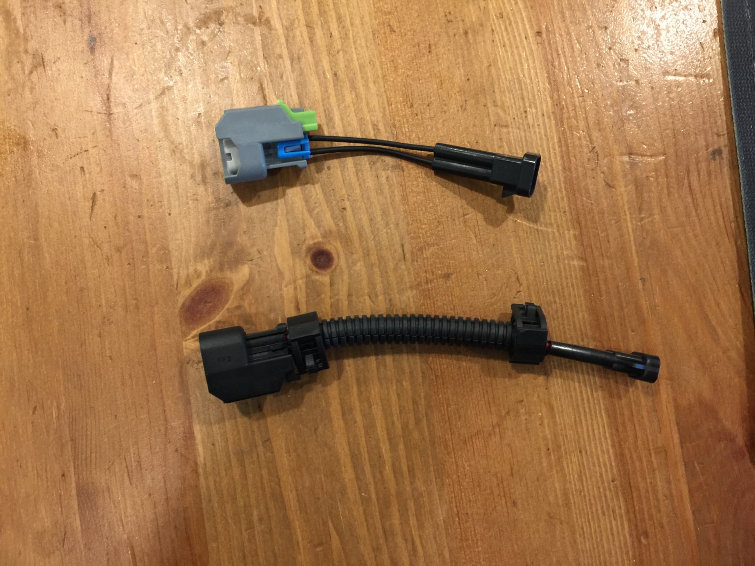

In the first pic here you can see the adjusting plate. I had ordered harness adapters to connect from the EV6 on the new injectors to the Multec 2 which are on my truck. I didn't know Whipple was sending me a set so I have extra. I like the ones I bought better though since they have split loom so I'll use them.
