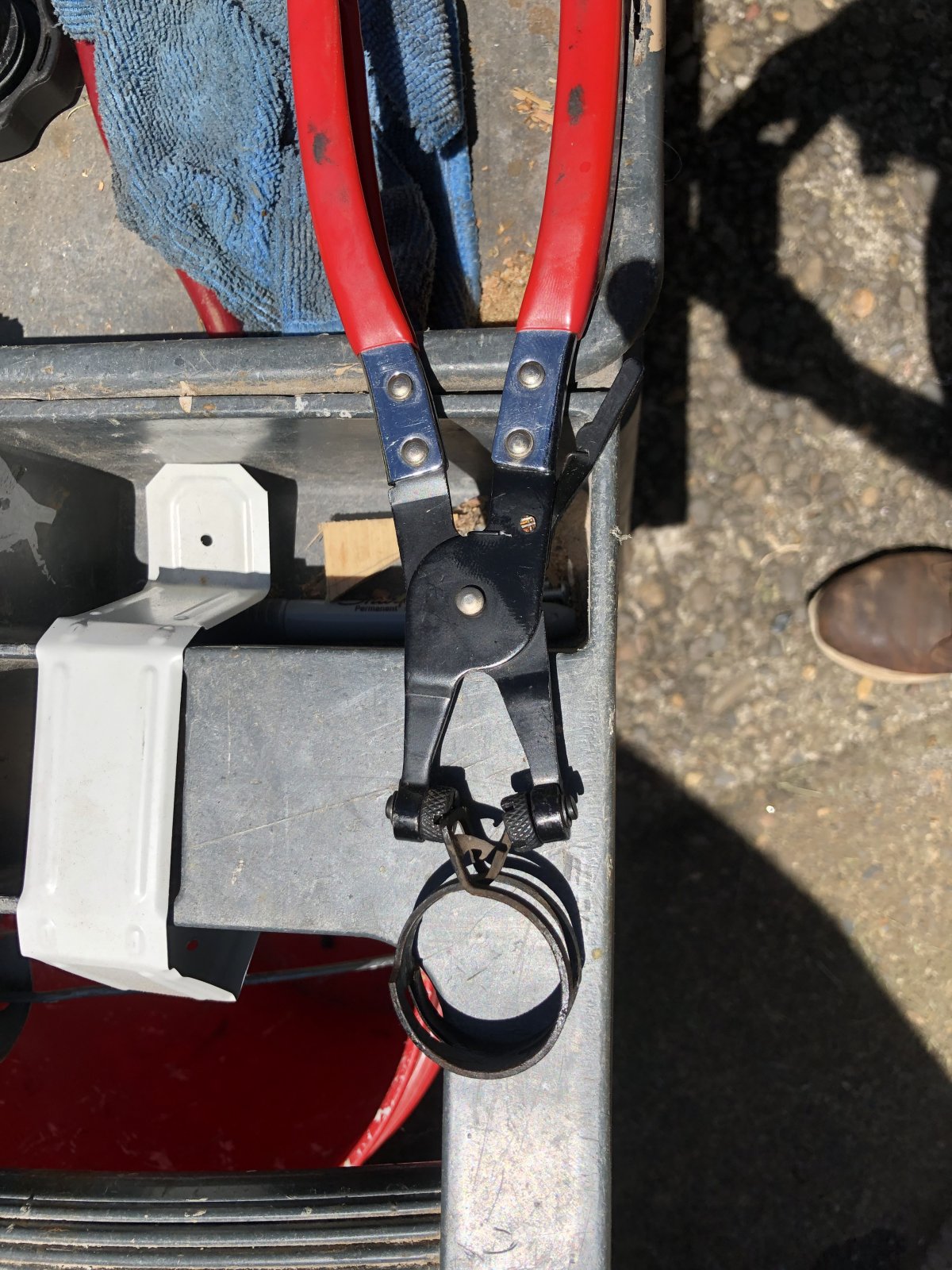

Those are some of my favorite tools. I always hated spring clamps until I bought a couple pairs of pliers specifically for them. Now it’s ridiculously easy to remove hoses.
What brand is yours?

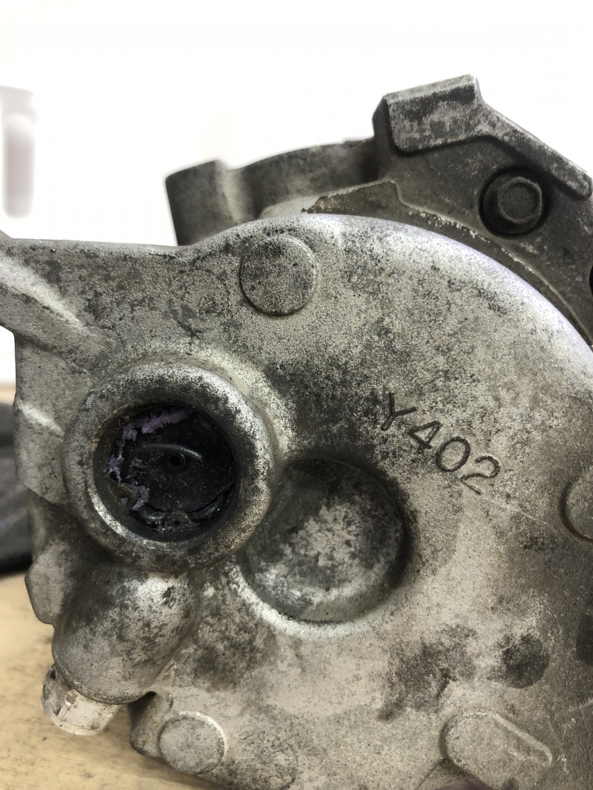

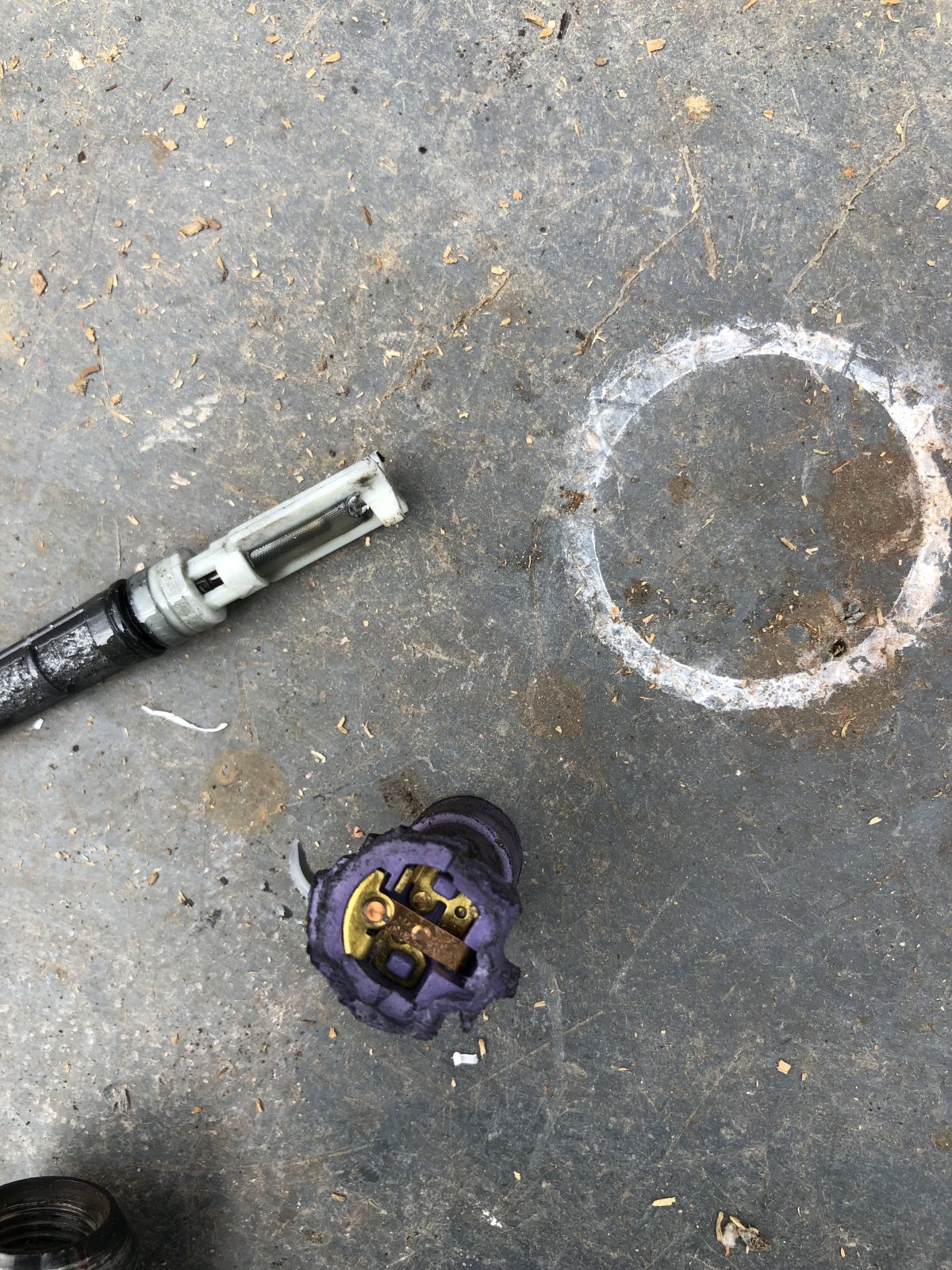

Well I’m in the process of replacing the AC components since it quit working. Im doing the compressor, accumulator and condenser. I started today and discovered the high pressure switch was blown off the back of the compressor and there’s metal fragments throughout the system. There’s not even any oil in the compressor. So it looks like I’ll be doing a complete system flush front to back. Not looking forward to it. The orifice tube is packed with metal. This sucks. Seems like it’s always worst case scenario lately.

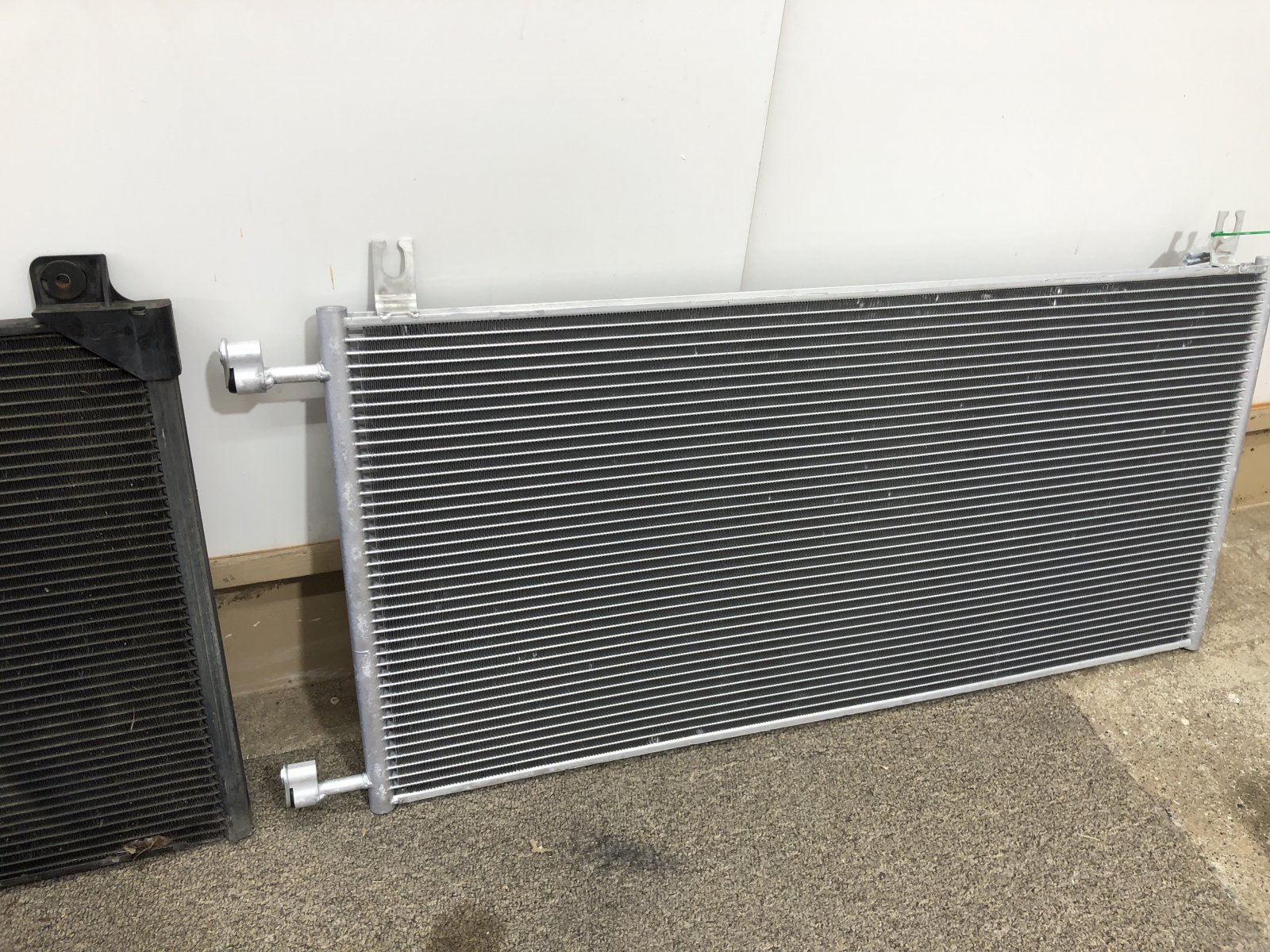

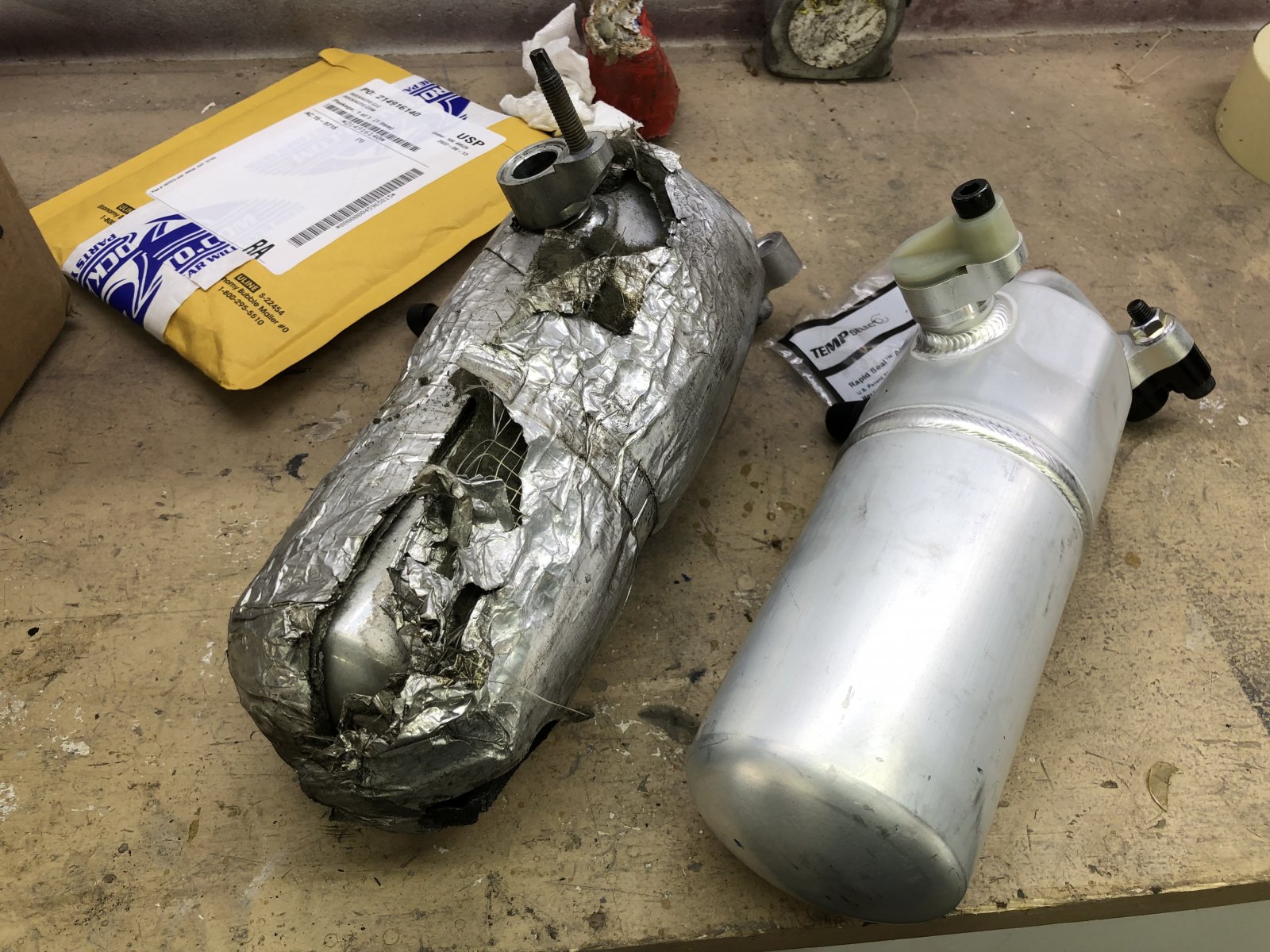

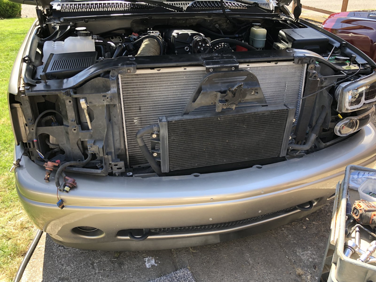

I removed the condenser and accumulator today. I’m not in a hurry to get this done and it’s pretty hot outside lately so I’ll take a couple three days to do this and work when it’s cool. The new condenser is from CSF, they say they’re an OEM mfr. It was $95 as opposed to over $200 for an AC Delco. It measures about 1/4” shorter but everything else is the same. All data states you just need to pull a couple bolts on the top of the cord support and remove the condenser but I had to do quite a bit more. Not too bad though, these trucks are super easy to work on.

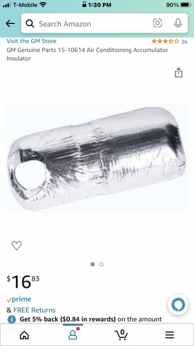

I installed the compressor yesterday and forgot to get a pic. It’s Denso OEM. I’ll have to pull the wheel again to blow the lines out, I’ll get a pic then. The accumulator is Genuine GM OEM. The insulation blanket is pretty rough. The back half isn’t bad so I hit it with brake clean. The front half I ordered from Amazon, 2 day delivery. The one I ordered states it doesn’t fit my truck but I cross referenced the OEM #15074674 with this 15-10614 so I know it’s right.
The front lines will be easy to flush. It’s the rear ones I’m concerned with. I’ve seen videos of guys just blowing them at the firewall and having the fluid come out the return line but I’ll be disconnecting them at the rear and cleaning them separate and cleaning the rear condenser too.
Anyway that’s where I’m at. Next will be flushing the lines and then assembling everything.
