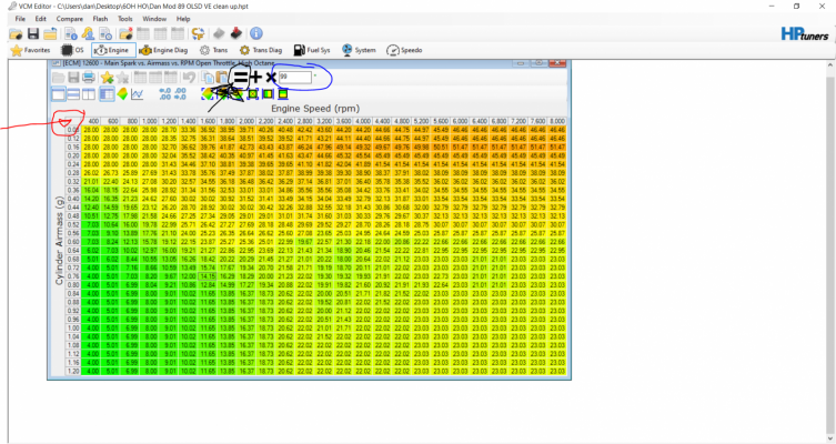

1:Double click the corner that is circled in red, this should highlight all the cells in the entire table.
2:Then go up to the box circled in blue and type 99
3:Lastly, click the equal sign circled in black which should make all cells 99
This will give your truck maximum spark for moar powa!

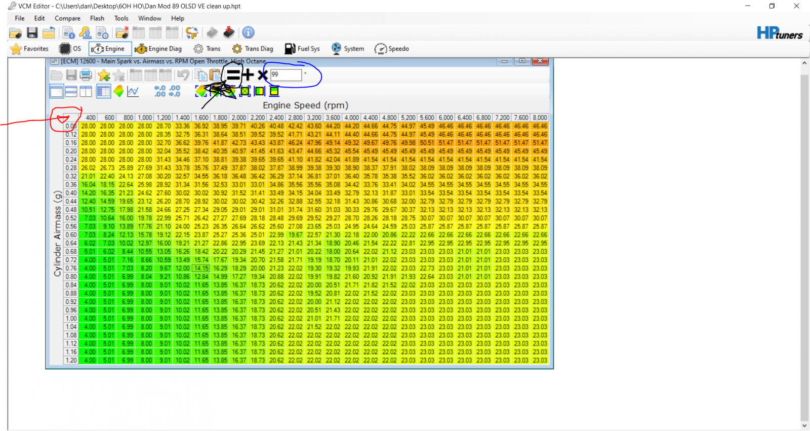

52,954

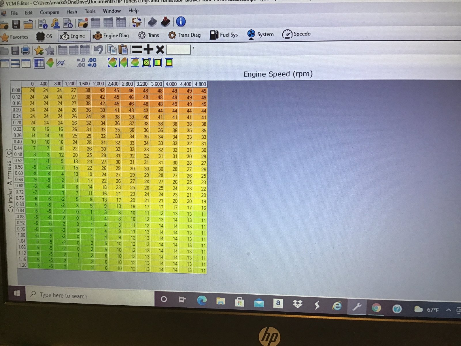

Is this a real thing? BTW I haven’t even figured out how to see the tables. Do I need to log first because when I open up my tune file and use the navigator all I see is a tree, no tables.
52,954
I just see this. I’ve looked at GRG’s videos but I don’t see anything that shows the very basics.
Edit nvm I see now. I just did that and flashed the tune. Now my truck won’t start.
