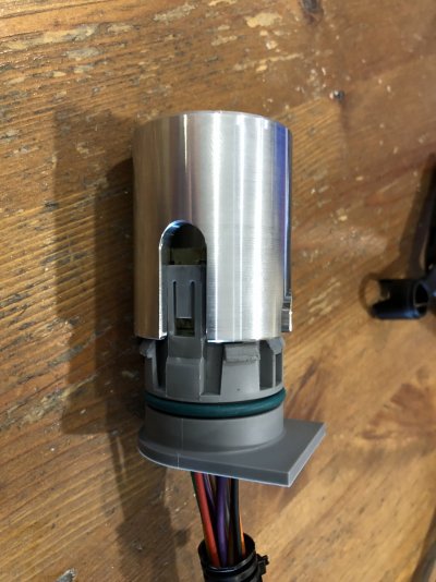

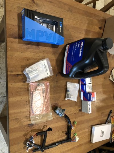

I got the harness removal tool (thanks @pwtr02ss !), the harness and electrical components kit, fluid and the Mpvi2+ (which I’ll be returning) today. The vehicle side connector will be here Saturday. It’s another mini heat wave here for a few days anyway so I’ll wait until it’s over and then replace everything. The Mpvi2 Pro will be here Monday. That tool is quality, it’s keyed plus it pushes the tabs in just enough.

Glad they got it quickly and it made it. Looks like you've got plenty to work on:)
also, Unlike engine oil, transmission fluid is transmission fluid. I buy the cheapest dexron (x) I can buy. Just for future reference. I've asked a lot of transmission builders and they have all said the same thing. Ask your guy next time you talk to him. Just trying to save you a few dollars in the future
