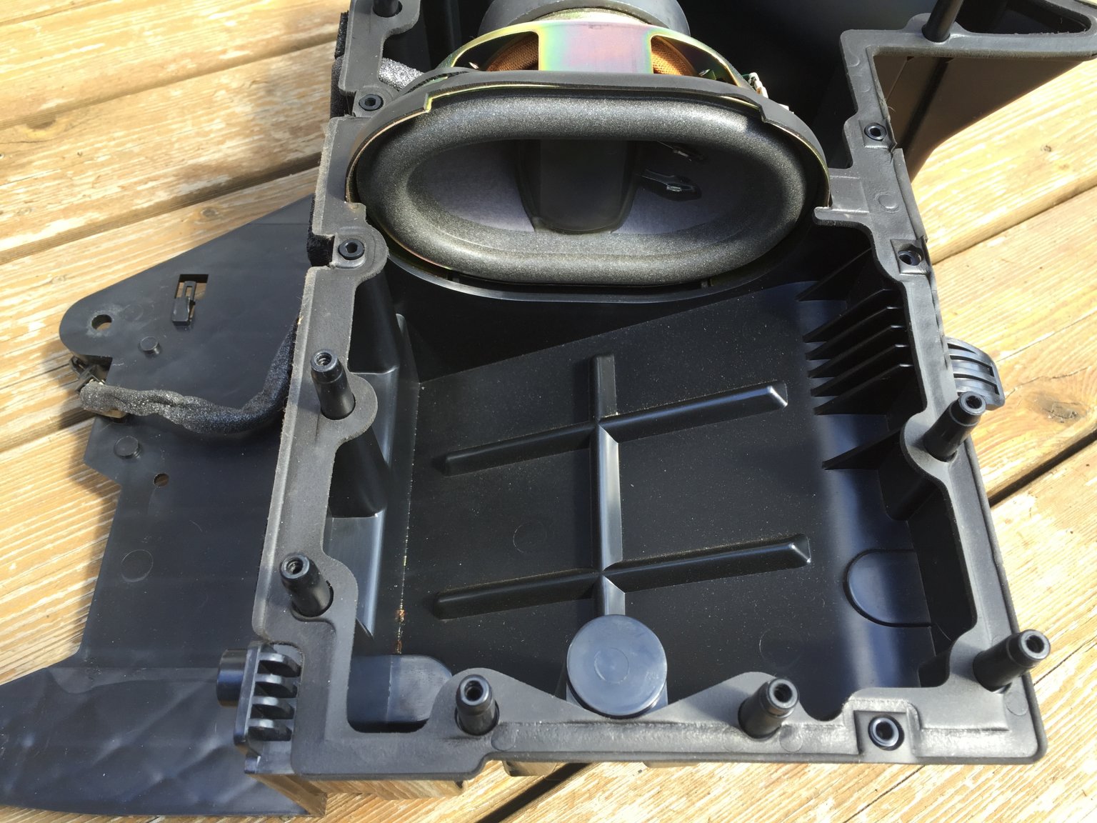

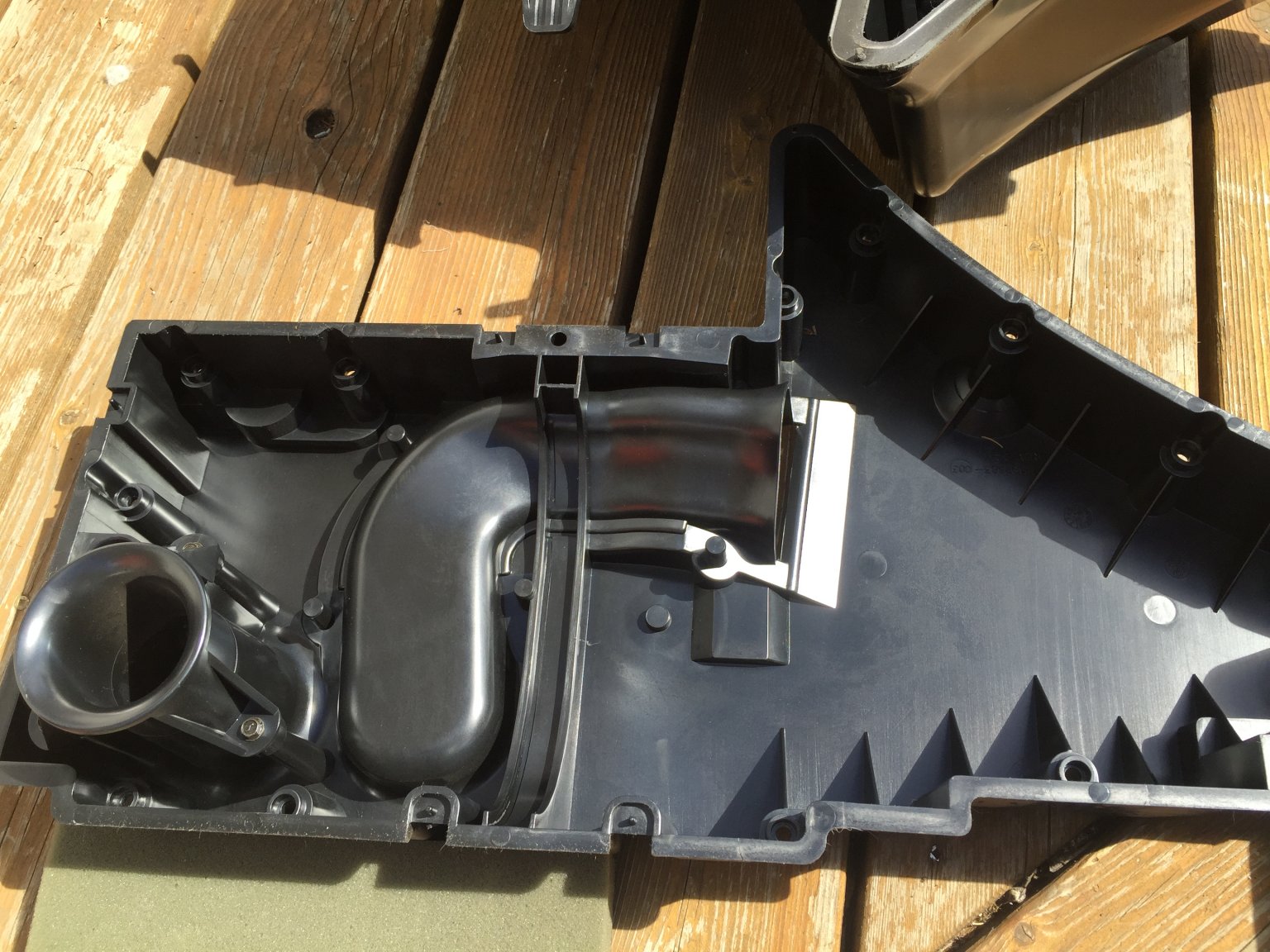

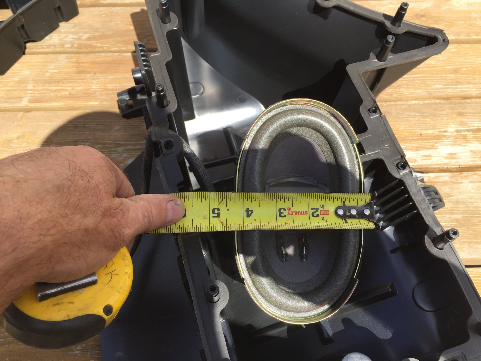

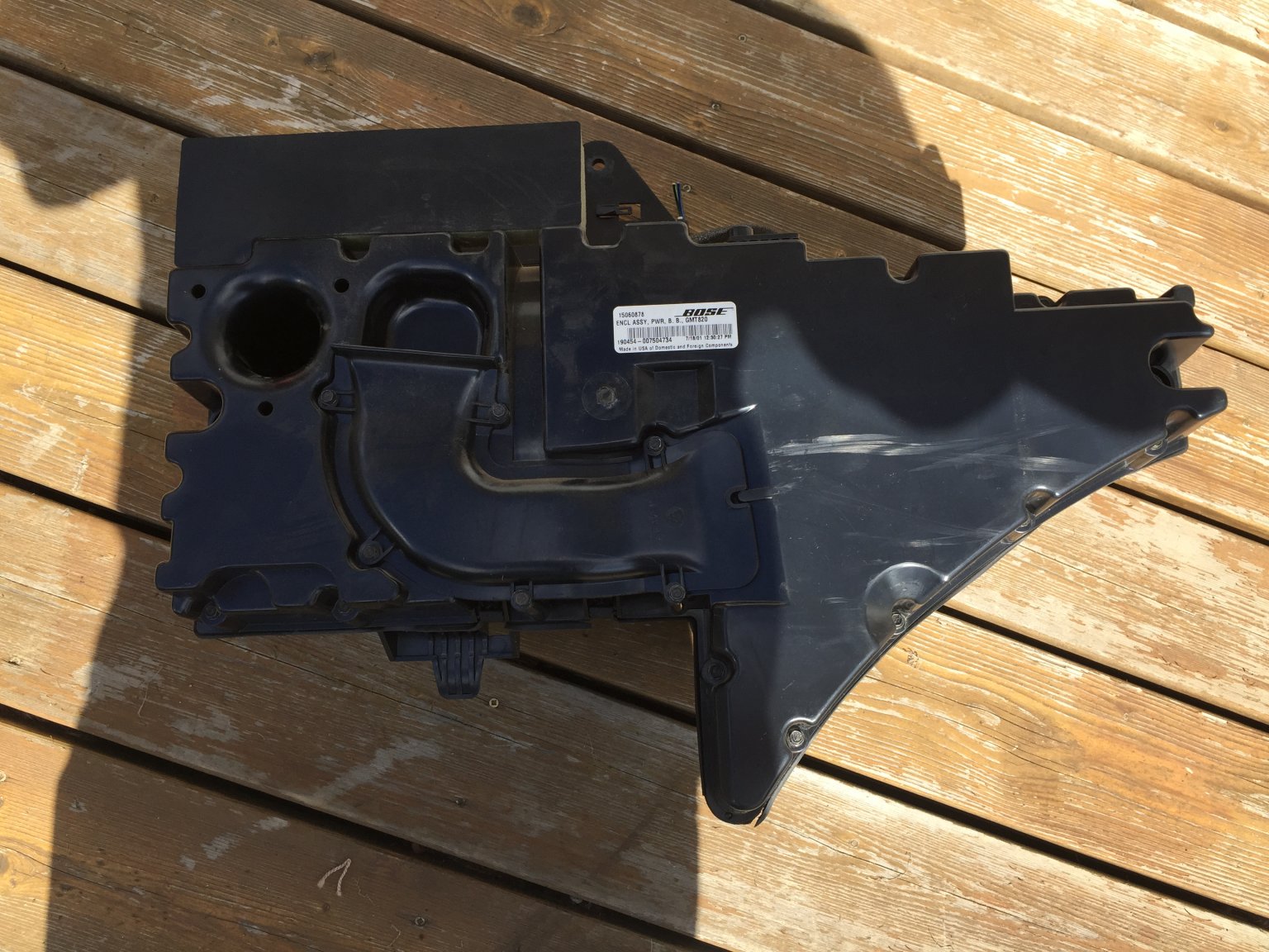

Next I needed more bass. I was running everything off the factory Lux amp, which is the best GM had at the time and is actually not bad. The Denali had the Bose Acoustimass enclosure in the rear driver side quarter panel. I looked into upgrading the sub itself but due to Bose's proprietary system, that was impossible. here's the stock enclosure, with the Bose 4 x 7sub. It has a port where the bass comes out of with a 7th order bypass (I believe) enclosure. The actual sub is mounted in the interior.
Where is the Denali Bose amp located at

If you have 01-02 it sits on top of the subwoofer behind the drivers cargo panel. The 03-06 is under the center console if I'm not mistaken.
My 02 sub/amp

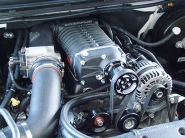

Today I made the hard decision to go with a blower. I narrowed all my choices as to which one, what injectors to use, what else to do while I have the intake off, and how to obtain the tune. After a dozen emails with Justin at Black Bear, talking to members who have blowers and 4l60/65E transmissions and starting a thread regarding blowers, I decided to go with the Whipple 2.3L in black using Delphi 50 lb/ hour injectors which are bigger than the marine 8.1L injectors that come with the Whipple kit which are 42 lb/ hour and more expensive. I had to order wiring adaptors for them but those were only $20 so the injector total was less than $150. Whipple wanted $390 for the others. I'll have room for more boost later if I want it. I also ordered knock sensors and harness, valley cover gasket and oil pressure sending unit so I can replace those while I have the manifold off. My trans is a 4L65E which is the HD version of the 4L60E. It's been rebuilt and has a shift kit and a Corvette servo. I believe it will hold up but time will tell. I emailed Justin and told him I'm ready to order so hopefully he'll call me tomorrow and we can get this going.

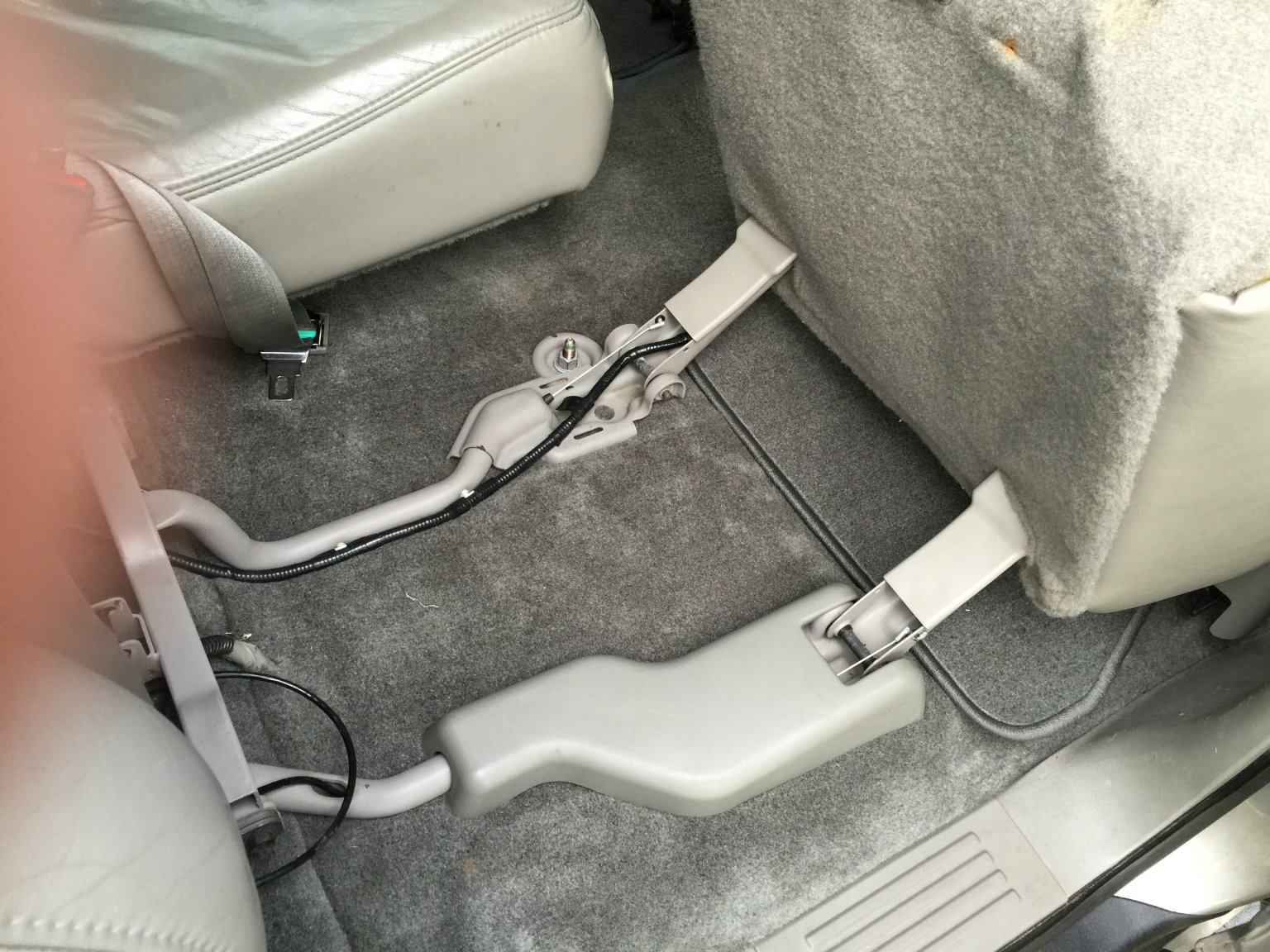

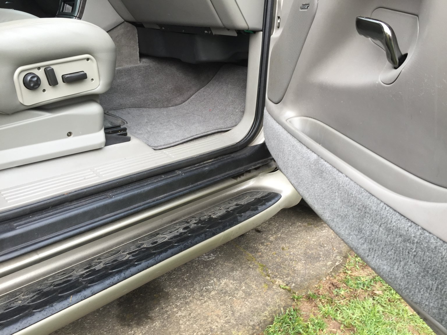

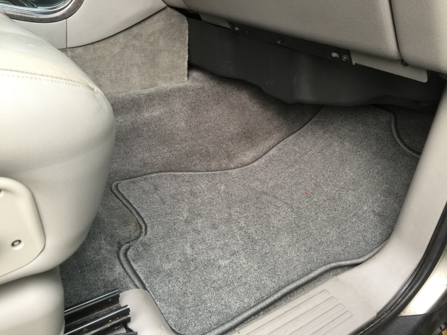

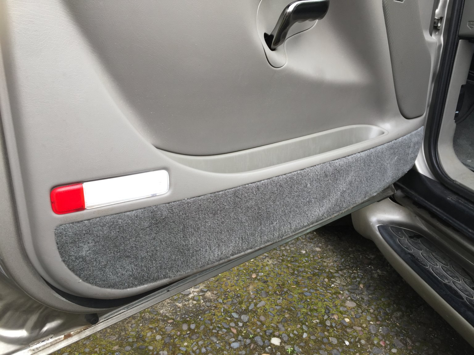

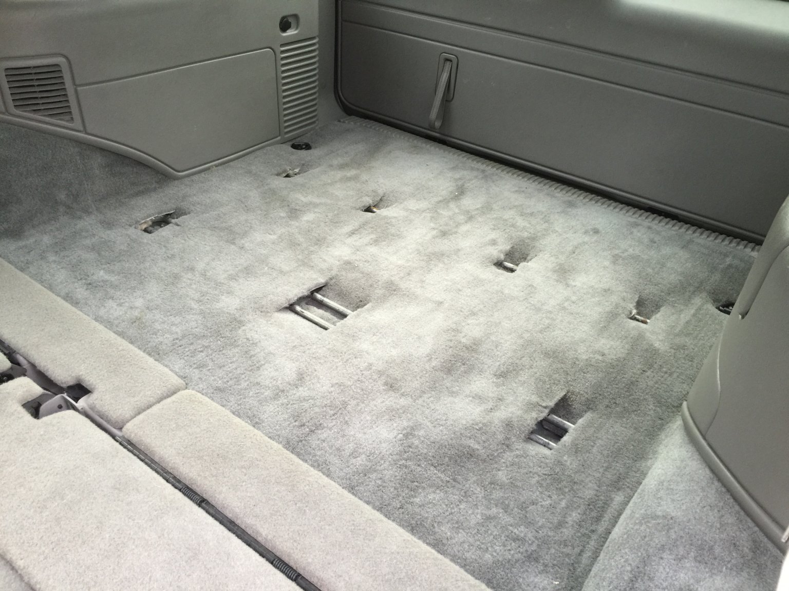

Here's the new carpet. I also ordered a bit extra carpet and did the bottoms of the front door panels. The carpet was not too bad, cutting it was a ***** due to the mass backing I ordered it with. I opted to just cut slits where the bolts came through so the areas around the seats looked cleaner, instead of making cutouts like the factory stuff had. I was able to get the nuts started and then tighten things down. It came out real clean. I ended up buying a matching rug that fits the rear cargo area perfect. I needed the cutouts because I use my 3rd row seats occasionally. At this time, I also removed the speaker grills from the door panels and painted them with matching SEM 17163 paint.
Where did you order the carpet from, and how much of did it take?
