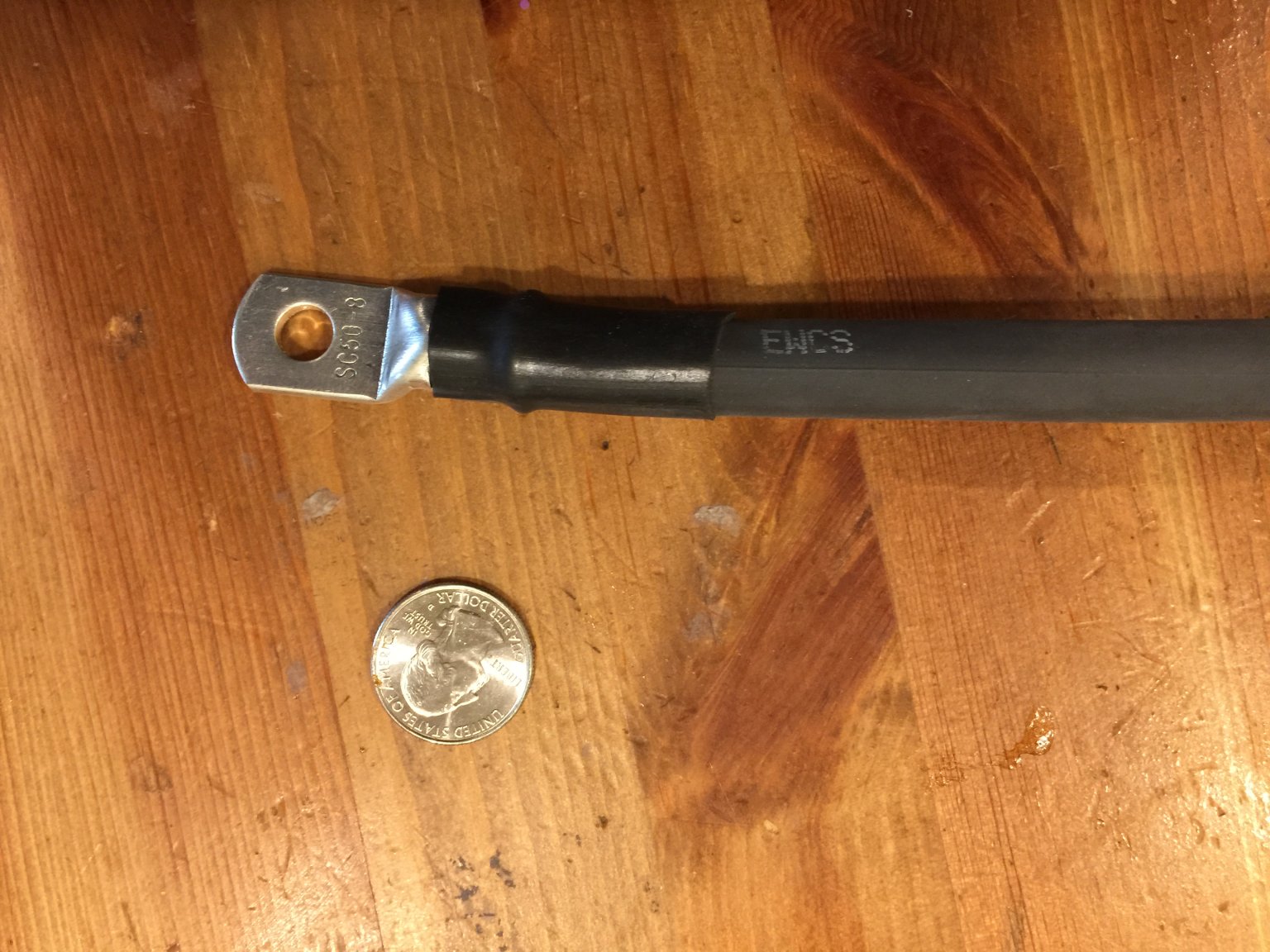

I did the Big 3 last week but didn't really take pictures of the whole process, just these shots of the wire and connections I used. I used 1/0 welding wire and tinned copper lugs. For crimping I went to Harbor Freight and bought their hydraulic crimp tool, then after using it to crimp the few connectors I needed, I returned it. Worked great!
Did you use a certain write up or how to for this one? What wire did you use / where did you buy supplies?
52,949
I just did a Google search for the how-to on a Big 3 upgrade an a Tahoe/Yukon. I bought 10' of 1/0 welding wire and tinned copper lugs off Amazon. I think @TheAutumnWind was the one who provided the supplies info.

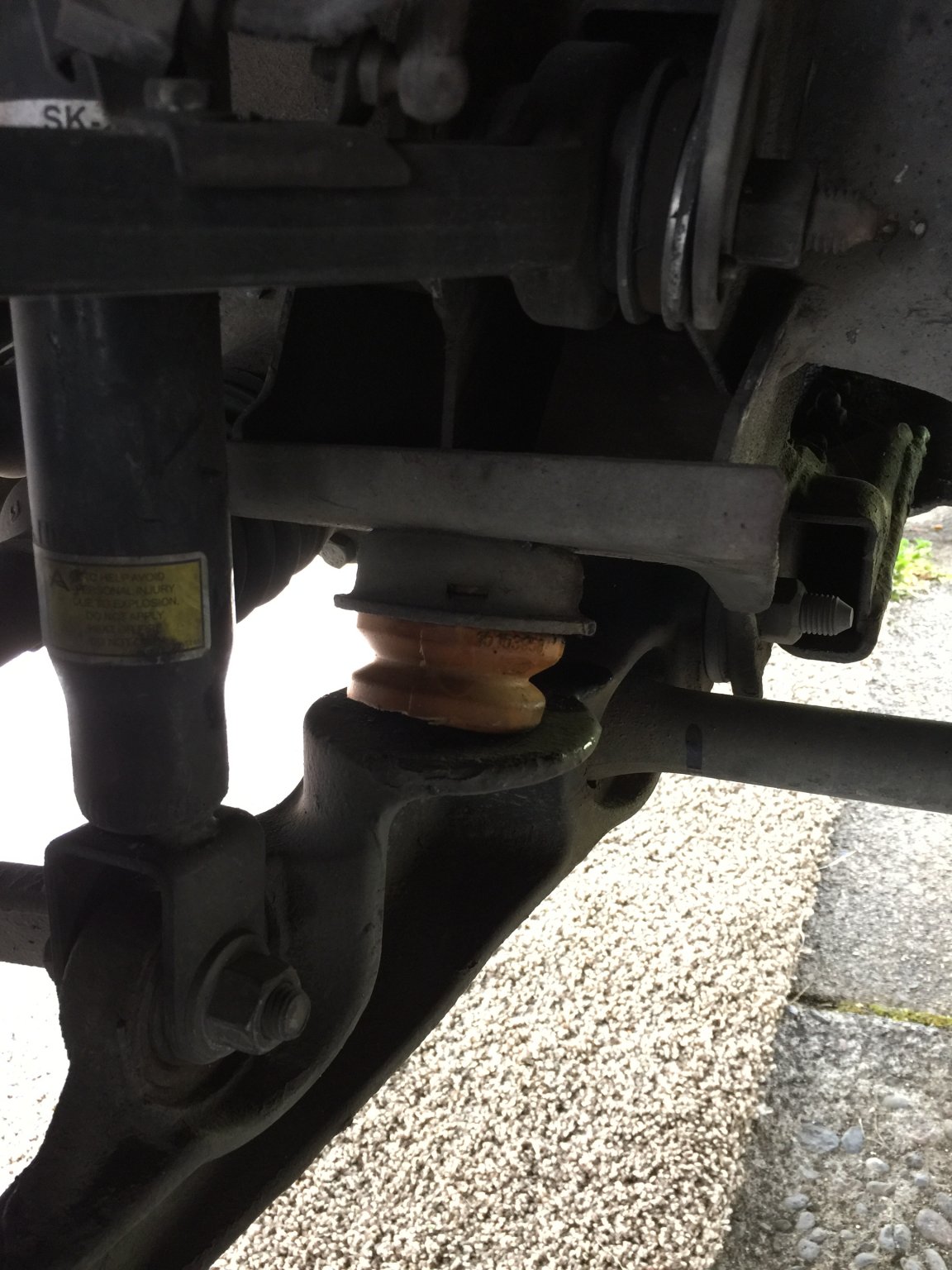

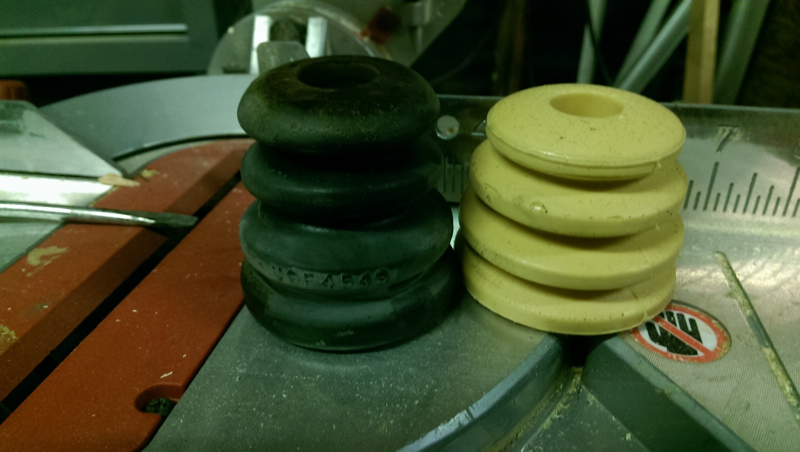

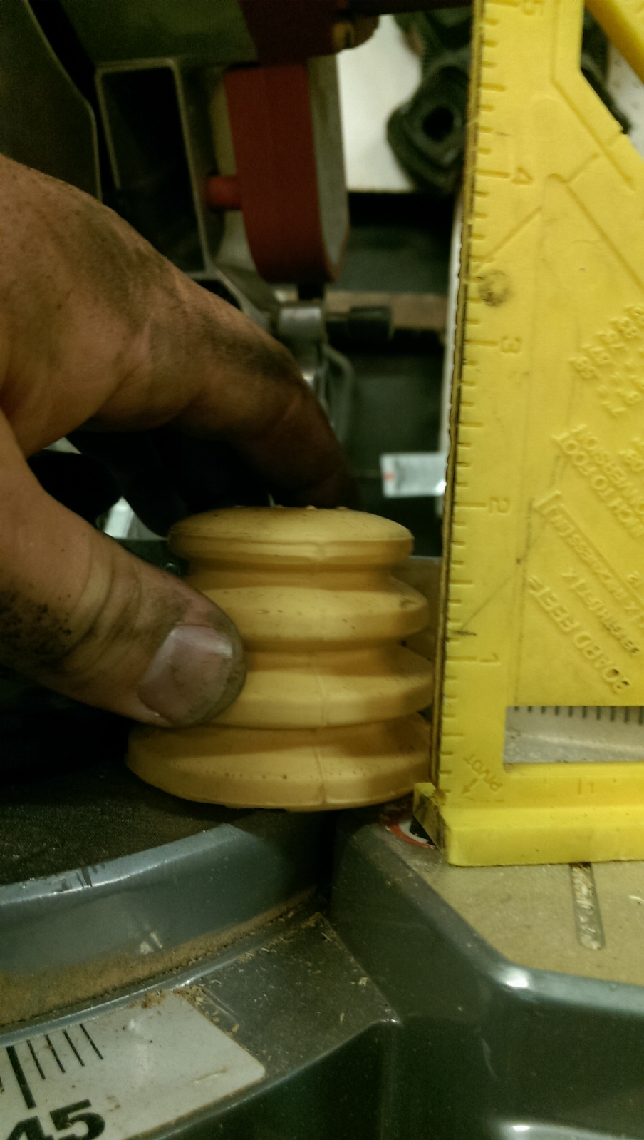

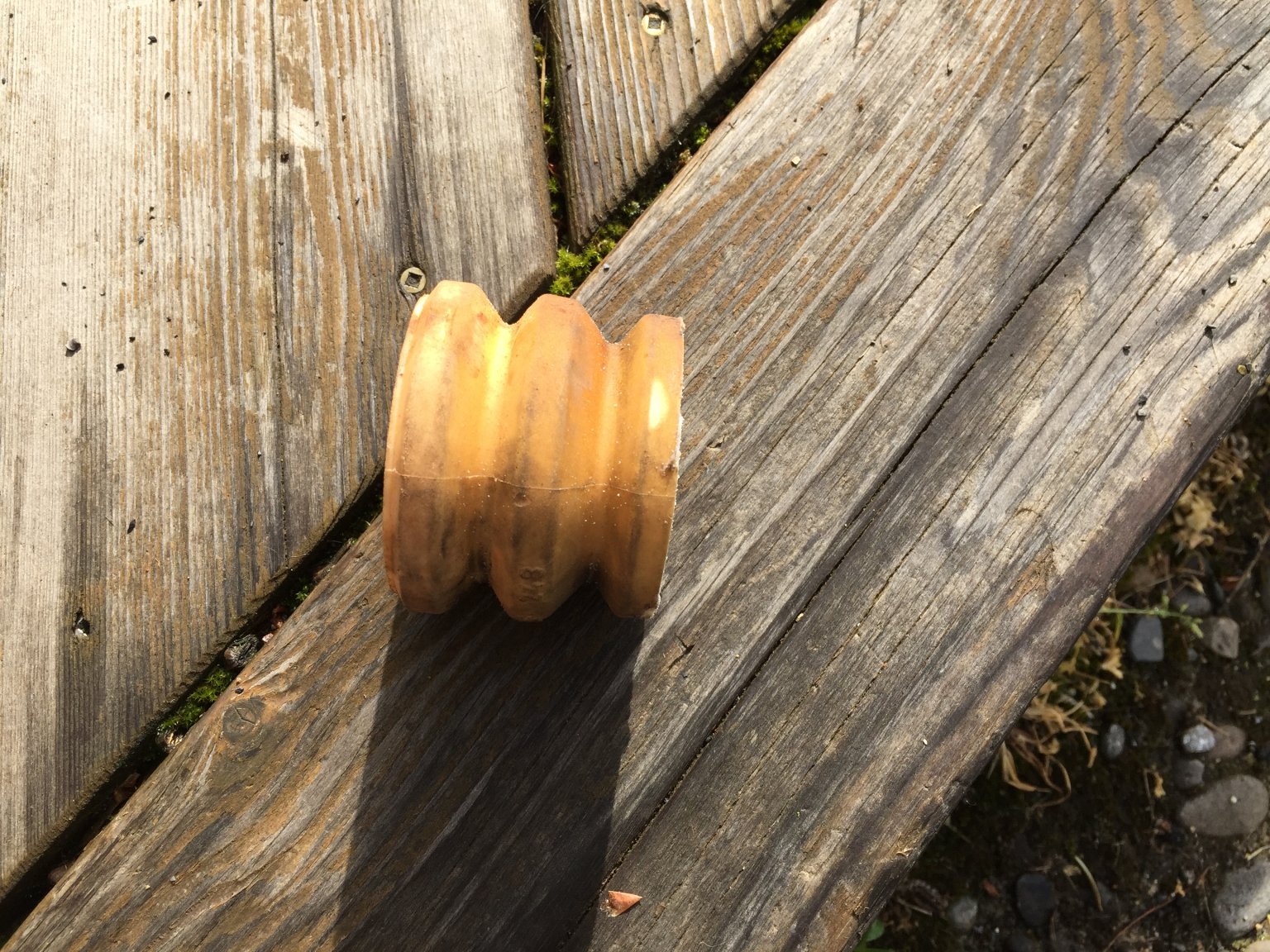

I ran shorter ones. Posted about it recently:
FYI I had to cut off the bolt on the bottom of these, but then they fit right in just like stockers.
I think the z71's are a touch stiffer then the other ones that look like a beehive.
I know your not lowered but...
I ran these when I was lowered ~1.5" with a crank and they were perfect:
https://www.amazon.com/gp/product/B003EP2OD4/ref=oh_aui_search_detailpage?ie=UTF8&psc=1
worn stockers vs those.
