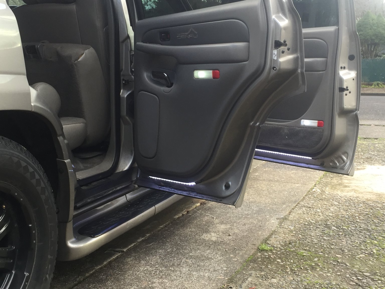

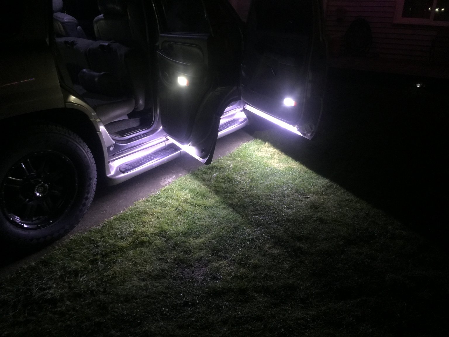

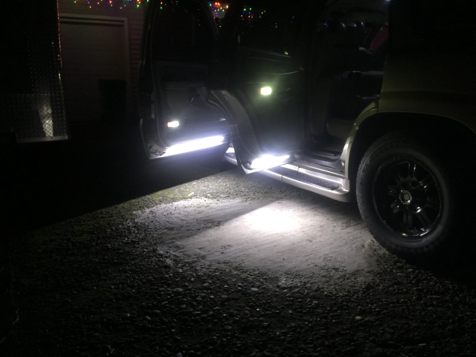

Here they are finished, with a couple night time shots. They really light up a large area on the ground.

I want to do the same with the LEDS but under the running boards. Never thought about putting it under the door. Are they wired to the door latch?

They're wired to my interior door lights which come on with the dome lights or keyless entry.

Dont you have interior door lights? That's the easy way if you do since the wiring for them is right there. The longest run of wire was the rears and it was only about 16". The fronts were only about 8-10" of wiring.

Ebay. Be sure to get waterproof ones. These came on a roll of about 15' and I cut them to length and soldered leads at those points so I could make as many separate strips as needed. Peel and stick on the back. Did all 4 doors and still have 4' left. Plus I bought another roll for under the hood. http://www.ebay.com/itm/252372982694?_trksid=p2060353.m2749.l2649&ssPageName=STRK:MEBIDX:IT

That looks so clean. Lights up that ground nicely:thumbsup:. I wanna do the same but on the fence of how I wanna execute it.

Yeah I cleaned the paint with denatured alcohol and then preheated the metal with a heat gun before sticking the lights on. If I have problems I'll use 3M VHB tape. I did take the door panels off; I used heat shrink on all the wires up to the point where they joined the factory wiring which was wrapped in black tape. I peeled the factory wrapping back and inserted my wiring in and then re-wrapped it. It looks factory that way. Soldered joints of course.

Damn those lights are badass!color looks excellent and lights up like a Christmas tree! Sweet mod! I'm gonna do that similar but underside of my running boards. Will be a hell of a lot harder to run wire for me though haha.
