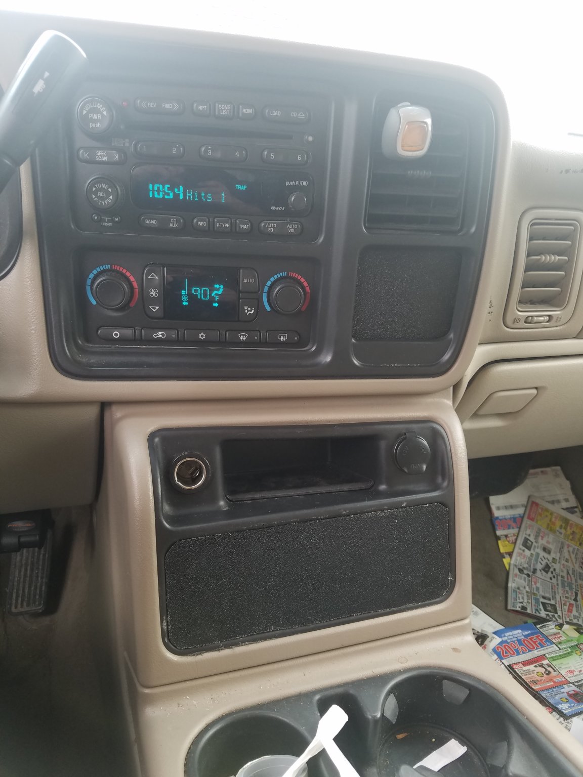

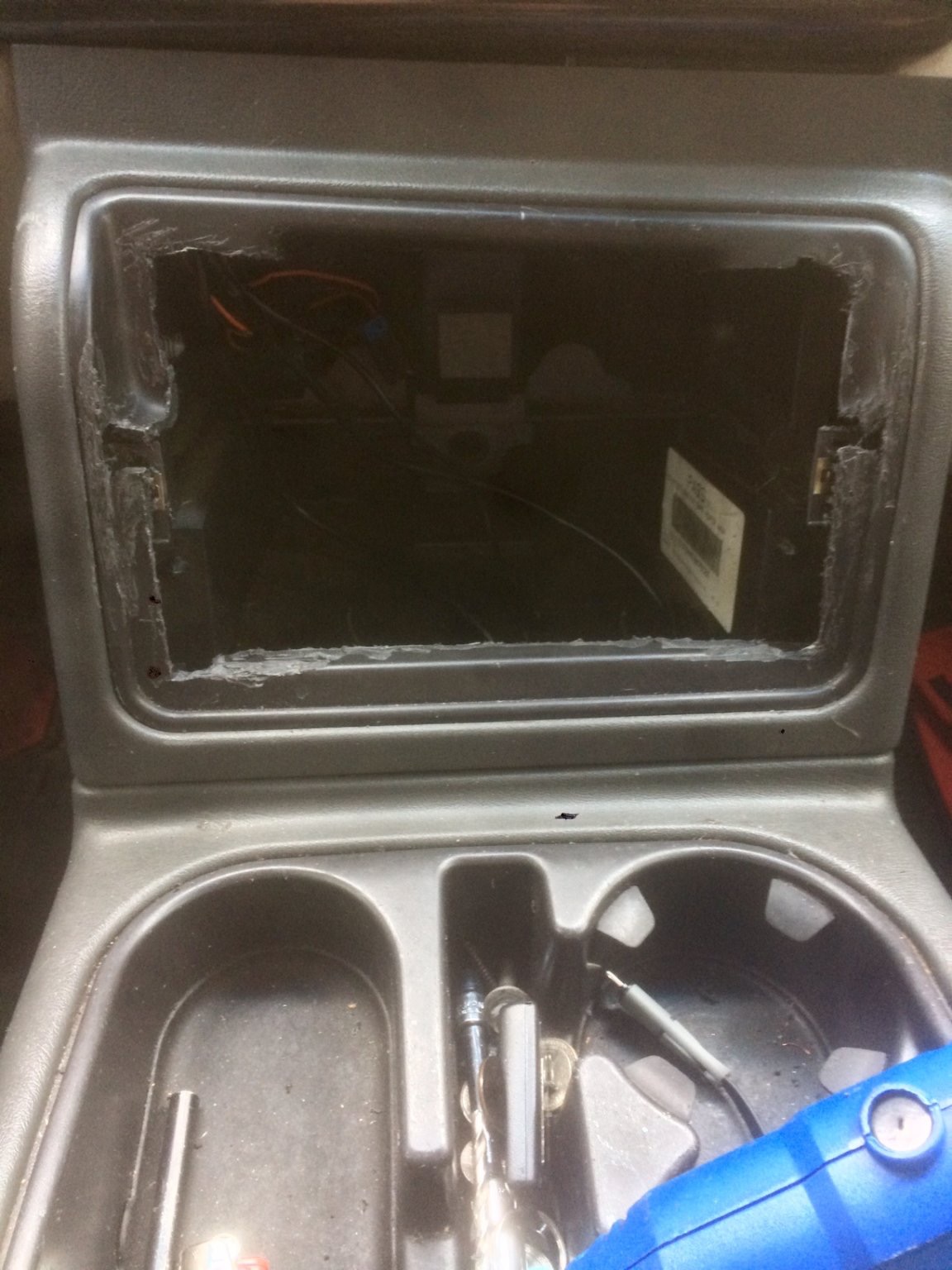

So first I removed the Onstar buttons some of you may have a cubby there just remove that also so that you can run the wires threw the opening.

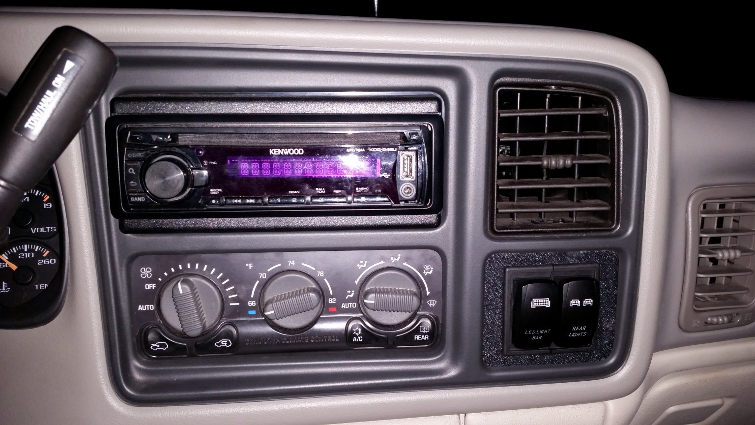

I cut the square out of the ABS plastic to size to cover the opening on the Dash trim piece not the dash it self and then I cut out the hole for the switch housing. Then I hot glued the plastic to the dash trim piece I did it this way cause there wasnt an easy way to mount a flat plastic to the dash itself.

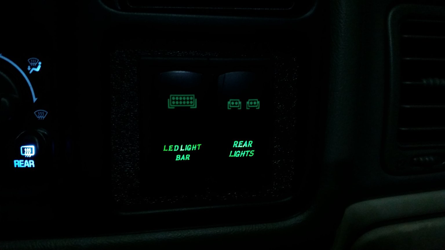

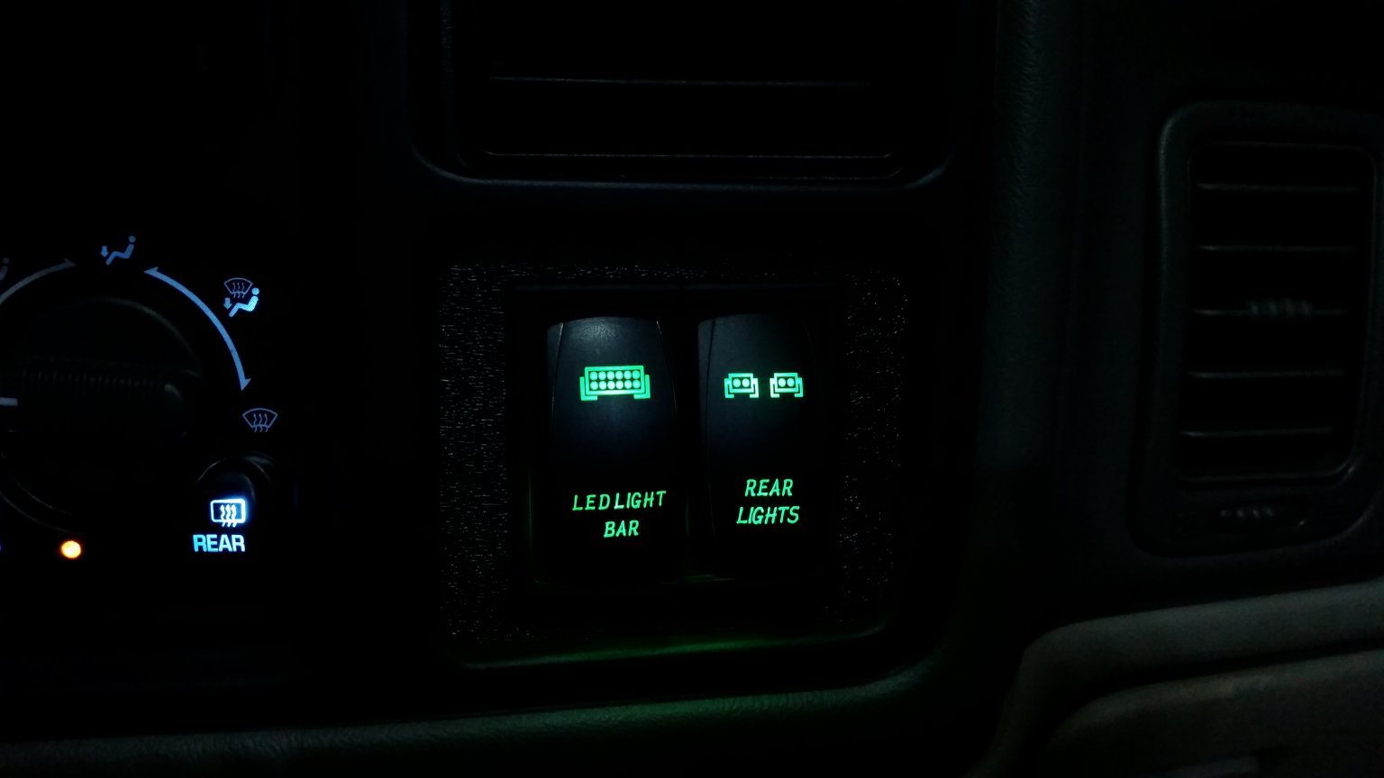

FINISHED PRODUCT.
TOP AND BOTTOM ILLUMINATED WHEN SWITCHES TURNED ON
ONLY BOTTOM HALF OF SWITCH ILLUMINATED CONSTANTLY
