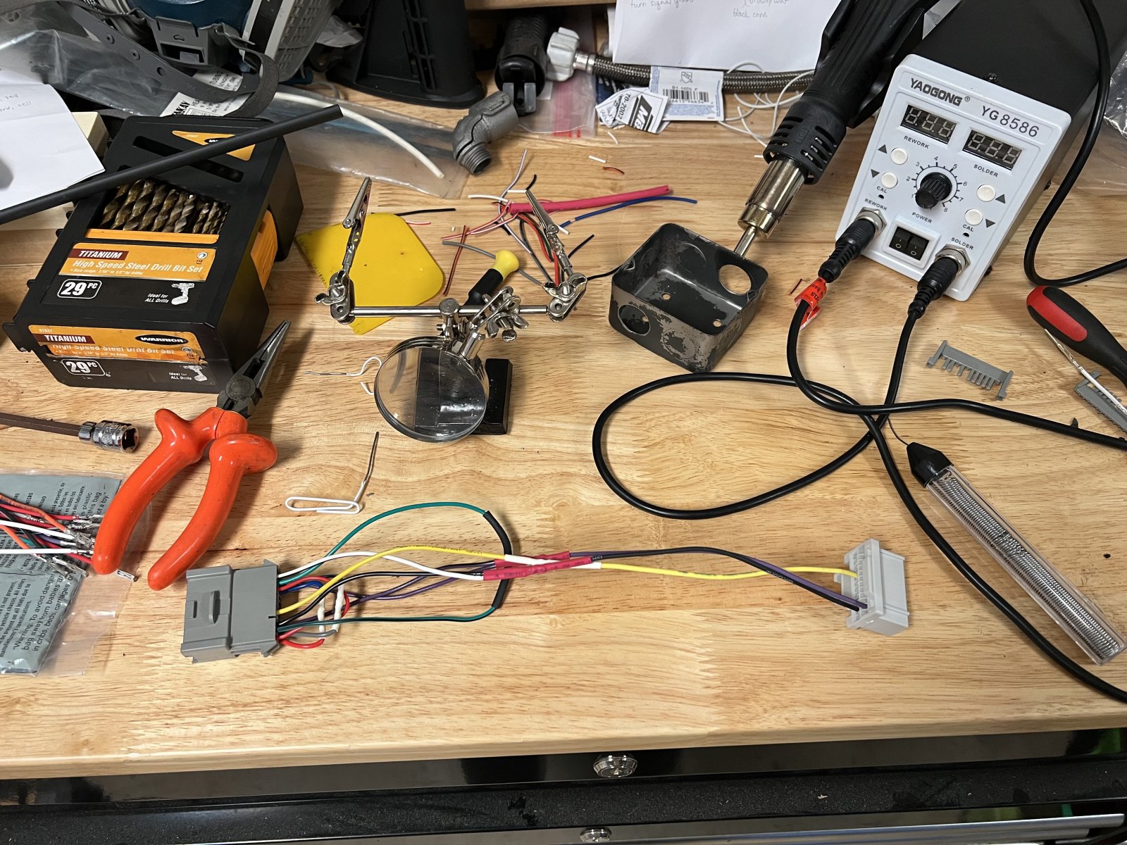

This weekend has been busy and terribly unproductive…
Planned on picking up the parts turd, couldn’t get my uncles trailer… I at least went and paid for it, seen it in person. It’s in better shape than the original turd! Couldn’t get it home today.
Tried to do the factory amp bypass
Once again- action taking place at the soldering station, as I use magical skills to create an electrical gizmo of epic proportions! But one of my connectors was missing TWO DÂMN wires/pins- so I can’t complete this bîotch…
FedEx is also slowing my weekend progress by parading my rock auto order around the country before hopefully bringing them to rest at my doorstep.
Also, It’s hotter than a four balled tomcat in my garage.
Maybe good luck will befall upon me tomorrow.
