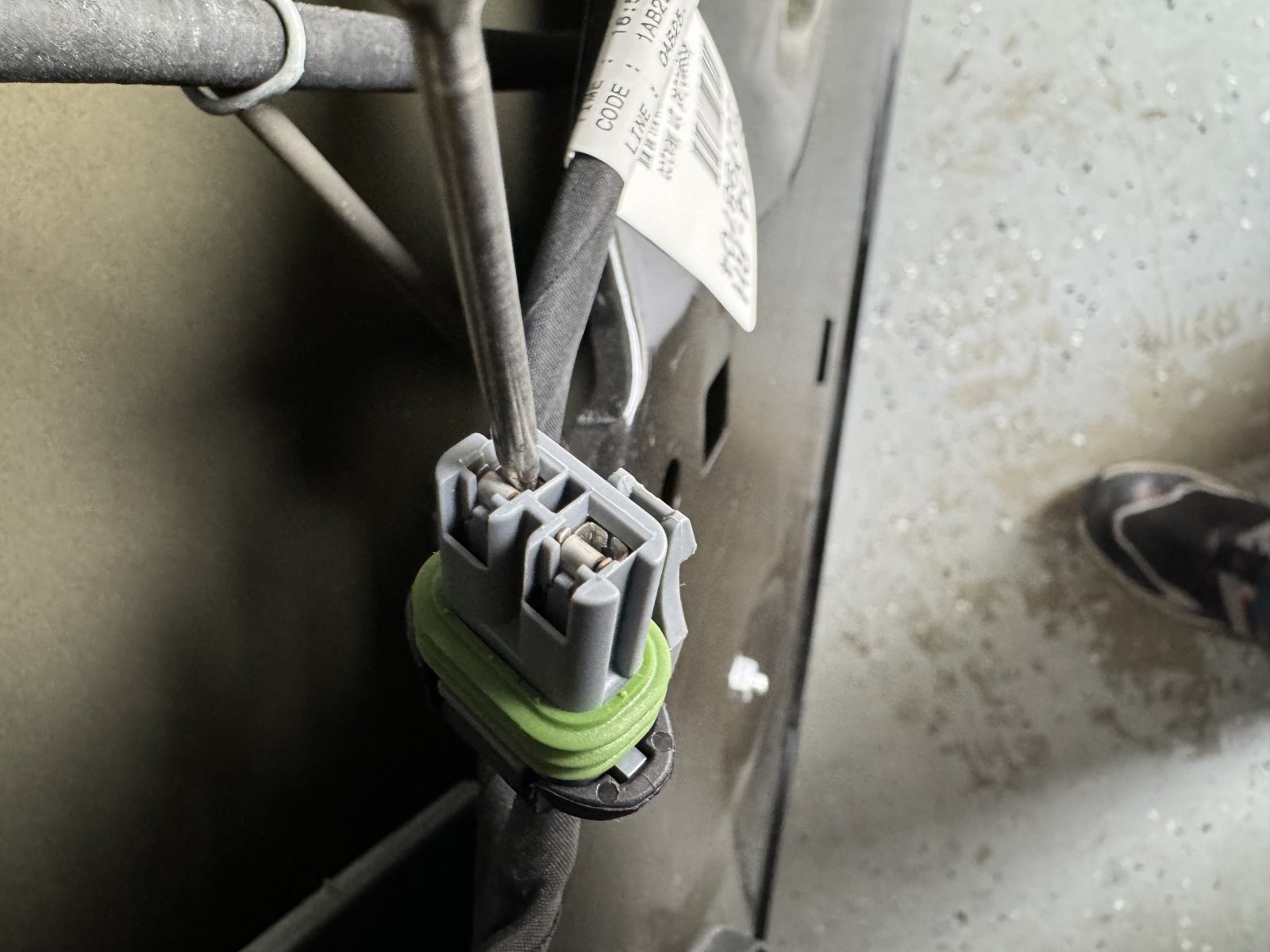

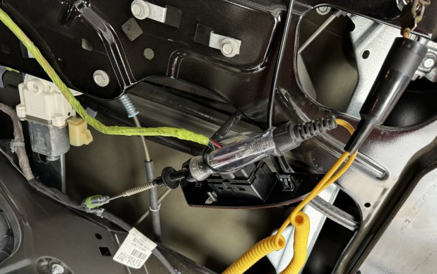

OK. So today, my other kid did not hear a sound next to window motor (w/panel off).
I don’t know if I am doing this right, but I got no light, w/ignition on, trying this pin and the one next to it.
Any other tests I should do before door panel goes back?
I also tested the power on & the RR door switch.
thank you

What year are we working on, or did I miss that? Some of these within the same body style have somewhat different electrical systems.
Have the appropriate fuse(s) been verified as having power going through it?
thank you
It wouldn't light up moving the switch back and forth?

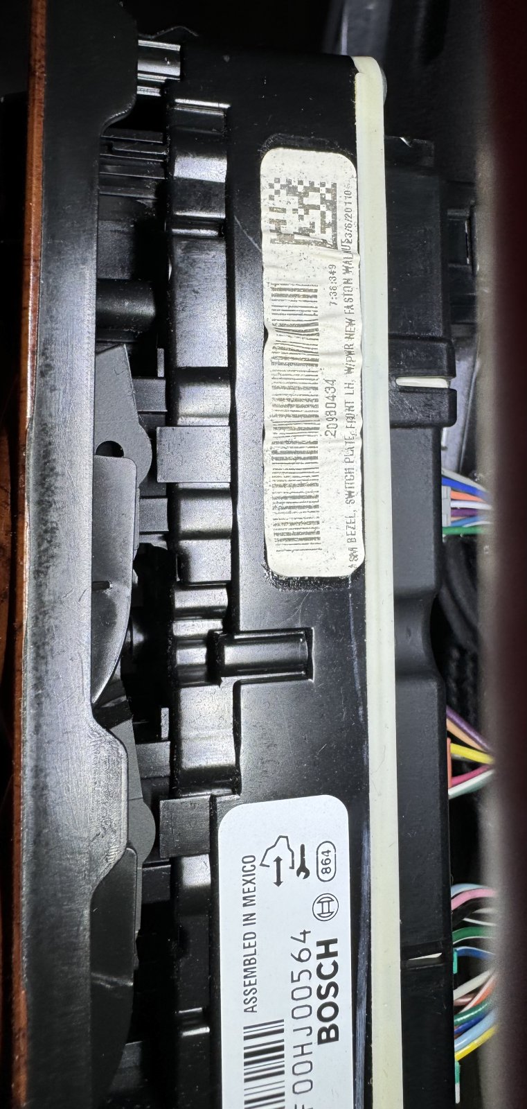

So clean under driver Switch.
Did not take apart, no dried soda or gunk.

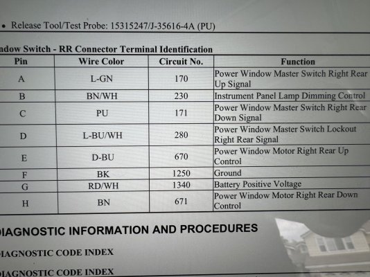

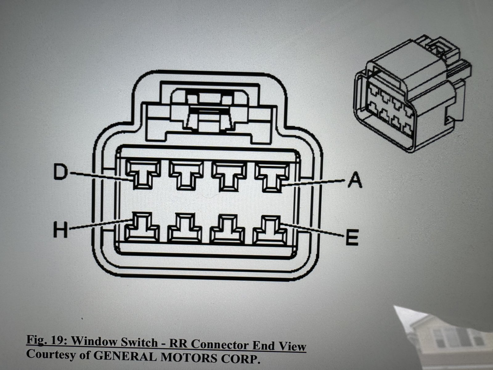

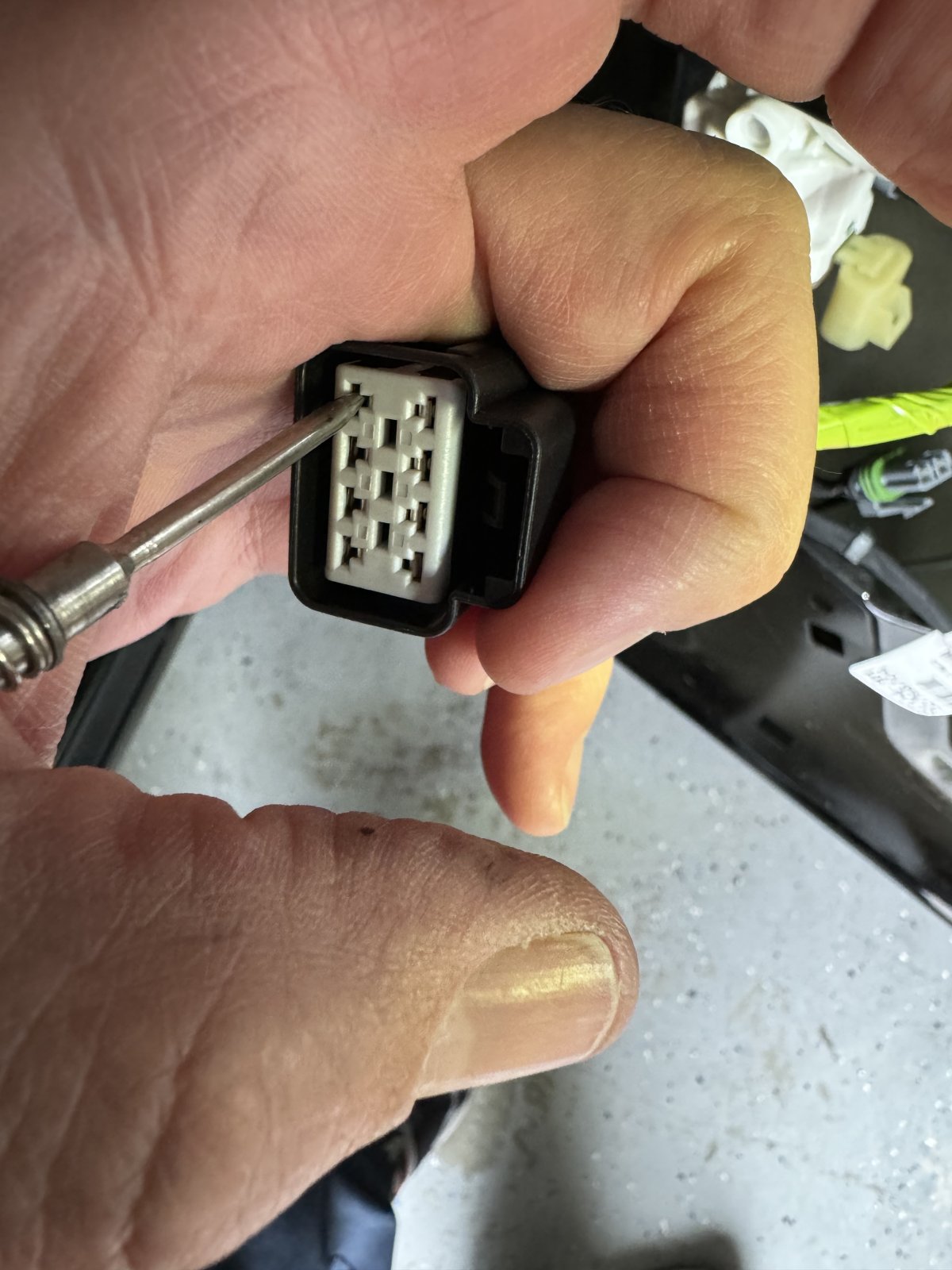

89Burb, great link. Inside incoming harness for switch. I did get power for going up. No power for going down.

OK, I think pg. 642 is right for RR and 641 is LR.
What the heck is that a drawing of? I see the ”BCM” for Body Control Module.”

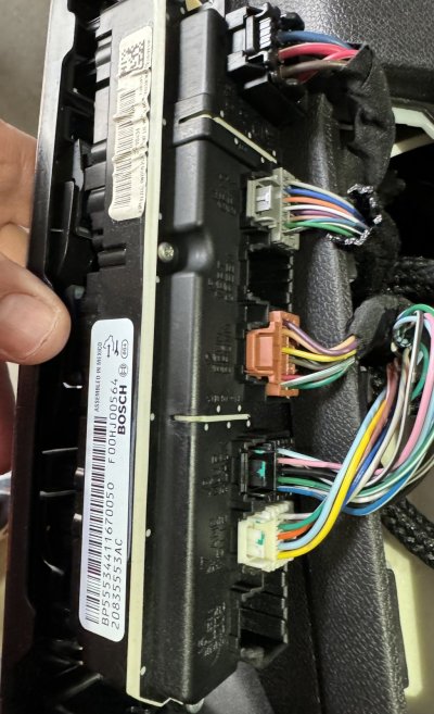

Just watched this video on BCM replacement on a 2007. Do I need to go to a dealer? I don't have a non-Apple computer.

BCM question here. If my BCM hasthis problem, can a dealer just reflash it and all will work? Or do I need to buy another one?

I'm surprised to see this issue on such a low mileage truck. The BCM stuff is above my education level.
