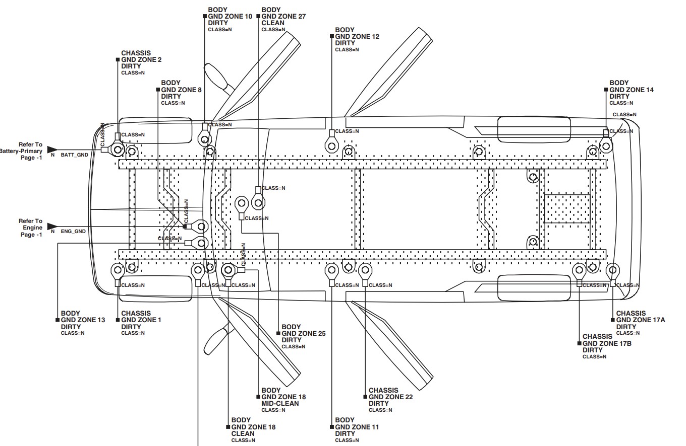

Looks like rear left and rear right windows use different grounds.
Zone 11 and Zone 12. Zone 12 ground might be worth checking.

2. OK, Mike71. Great schematic and information. I will check those first today. I am starting to read, these years have electrical & grounding issues it seems.

Hello. Does anyone know where the zone 11 and zone 12 are on the car? I did not see them under the car. Are they behind the B-pillar plastic?
Thank you.
