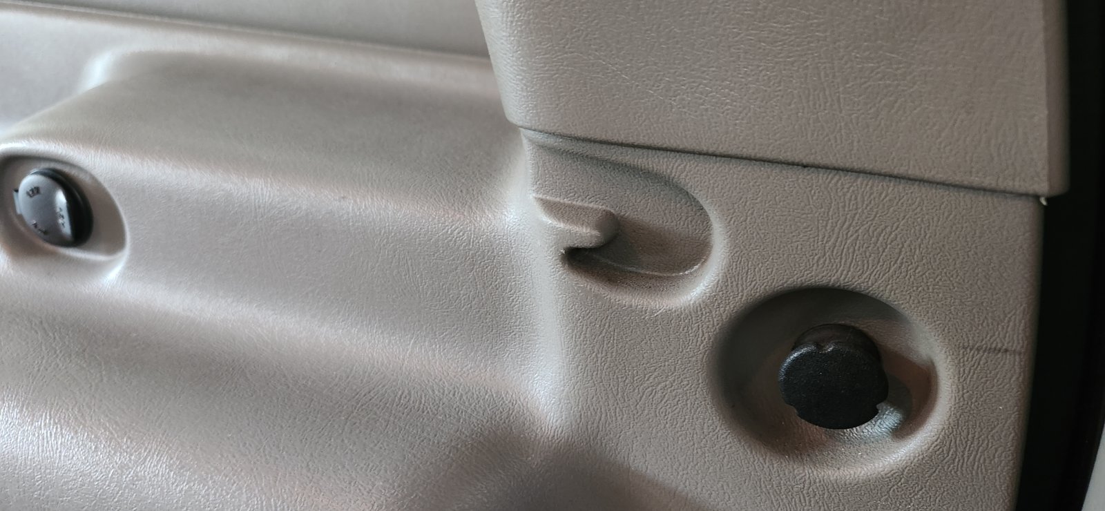

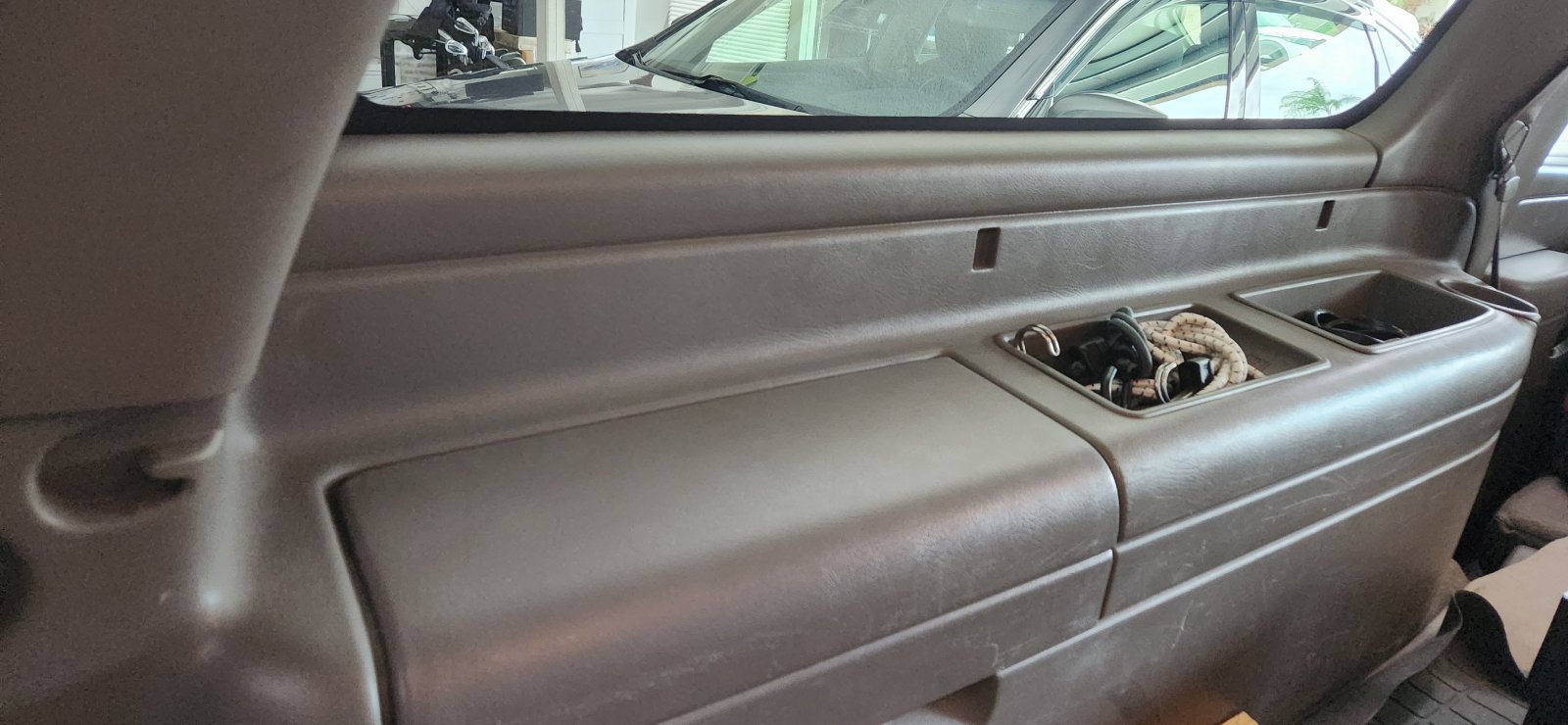

What does the rear 'catch' look like on yours?
Mine is an '05 XL...
I have 2 choices, where to put the forward 'catch'...... then the rear 'clips' to this shape.
Pics are of left / right side....

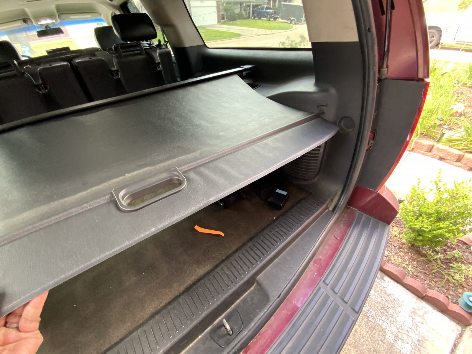

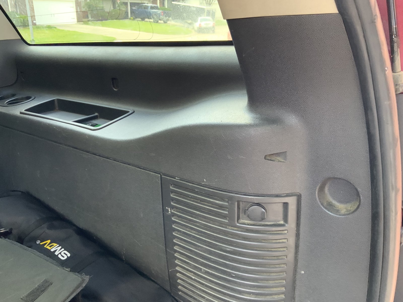

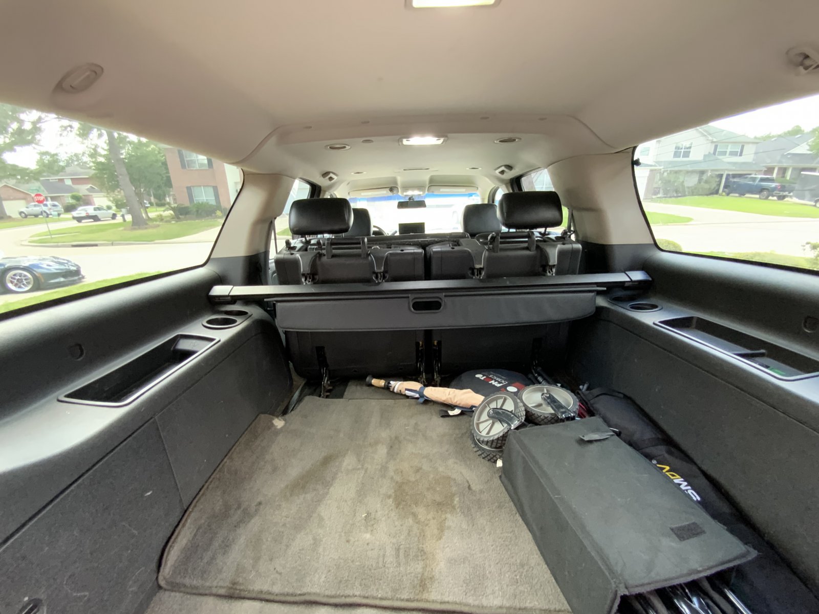

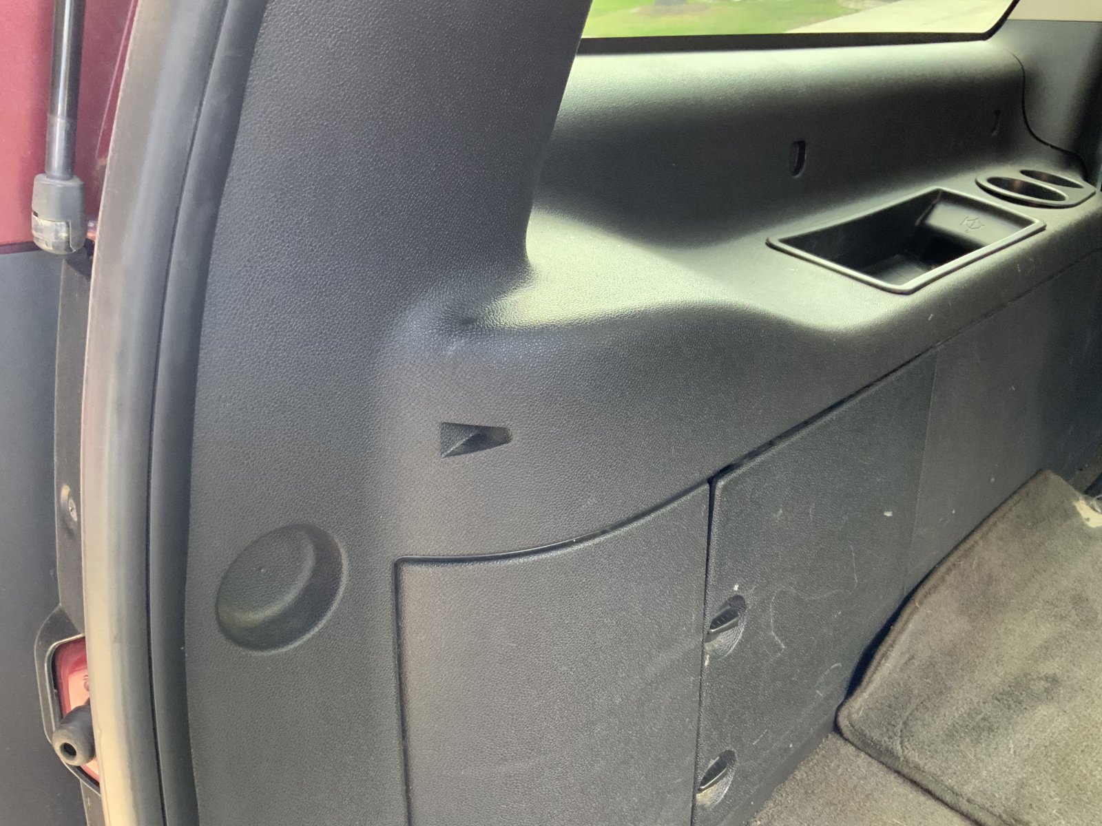

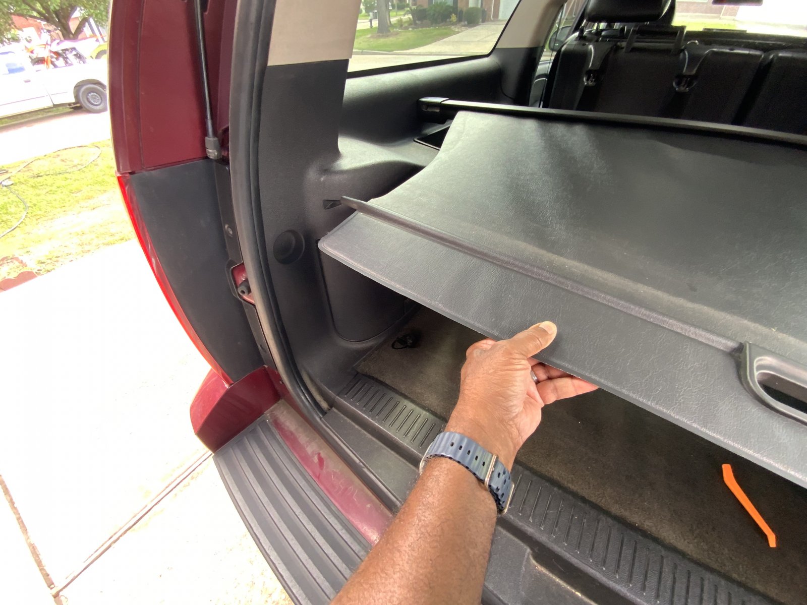

Here are photos of the retractable shade fitting in on the sides, but the ends just dont match up. What am I missing?

I have an 07 Suburban LT. I found the cargo cover on Marketplace.
What you are missing is a powered lift gate.
The cover you have is for the powered lift gate model which has a motor tucked up inside the driver's rear quarter panel making the interior trim stick out a tad further on that side. Unfortunately you have the wrong cargo cover.

Bummer.

Dang That sucks. Back to the drawing board.
