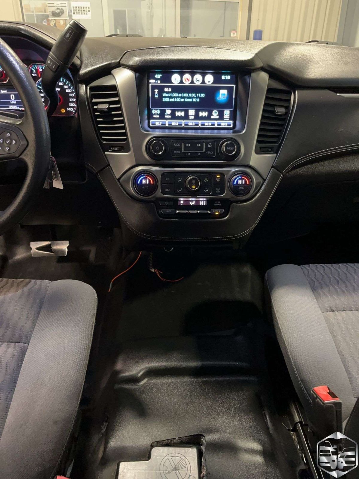

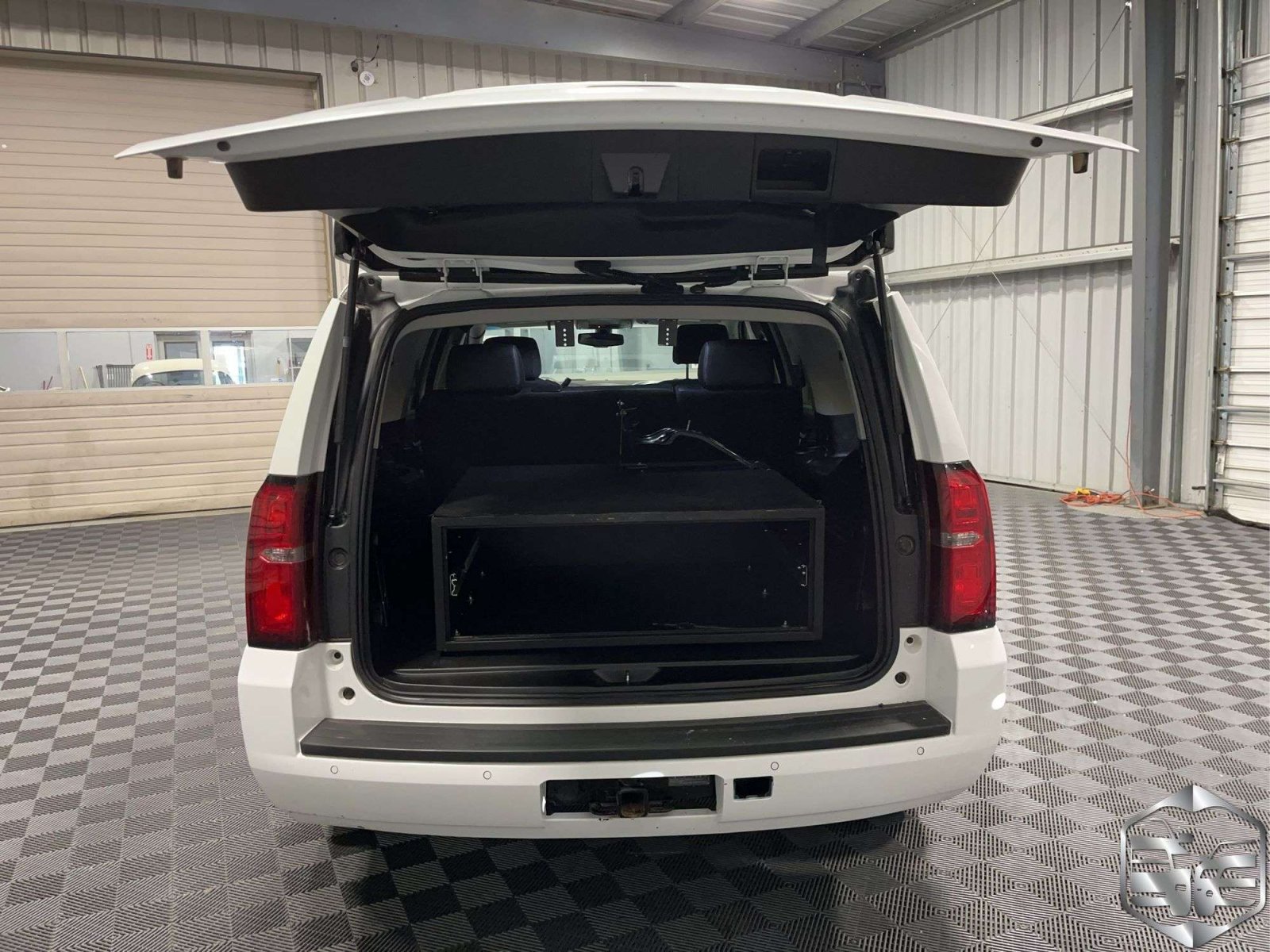

Good afternoon - Sounds like you may be getting these conversions dialed in. I just purchased a 2019 SSV this last weekend. I'm starting with the center console. Were you able to figure out what all the wires were for? All I have is a cut bundle. Is there any other tips or tricks you have come across? What did you do with the roof mount light rack plug and mounts. It also seems as the 4 sensors in my bumper have been pushed in - at least I'm hoping they are still there. Did you do anything for adding back in the 3rd row seats? Any advice would be super helpful. I did download the PDF for the 2019 Tahoe Special Service.
