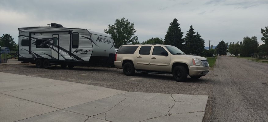

I should also note I plan to install new rotors and brake pads on all 4 corners.. This is a daily driver that also tows our toy hauler (roughly 8400 lbs loaded)
Other key information.. 2008 Yukon XL 2500 4x4. 6.0... as of now all stock.
