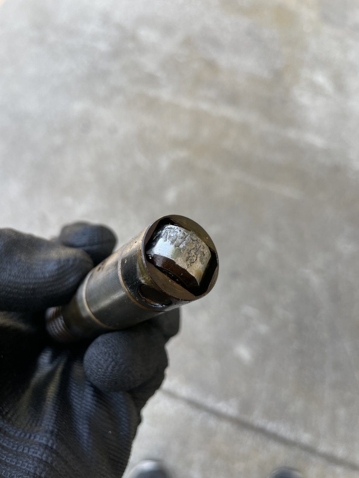

#2 exhaust lifter. Think this is it?
rockdogz
rockdogz
Aug 20, 2011
56
35
You mean #4?
#2 isn't an AFM lifter, like you have in your hand.
Is it collapsed?
Edit: and, yes, it IS a problem, if not THE problem... :(
Yes sorry I meant 4. It’s not collapsed so I’m suspecting it ate the cam lobe since I can’t think of another explanation. Going to inspect it next.

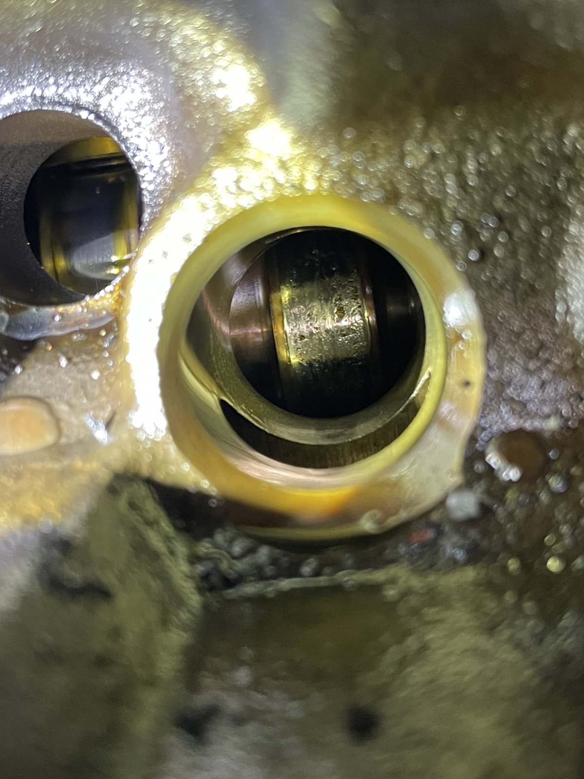

Doesn’t look good, I suspect the lobe is gone. Think I can get away with just replacing the cam?
52,954
I would think you’d be ok with a cam and lifters. You did get a bit of metal in the oil but it’s not much and the filter should have caught it or the pickup tube screen. I’m no expert though so hopefully someone with more know how will chime in soon.
