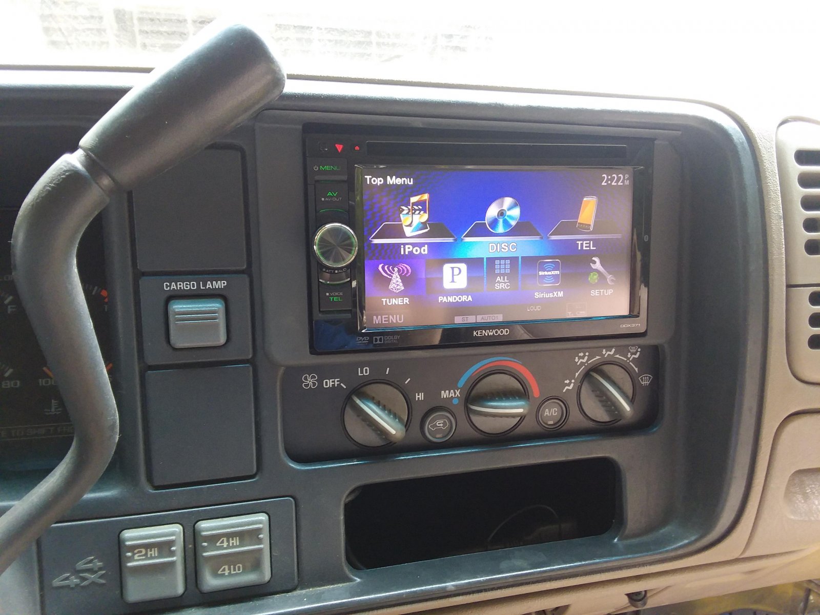

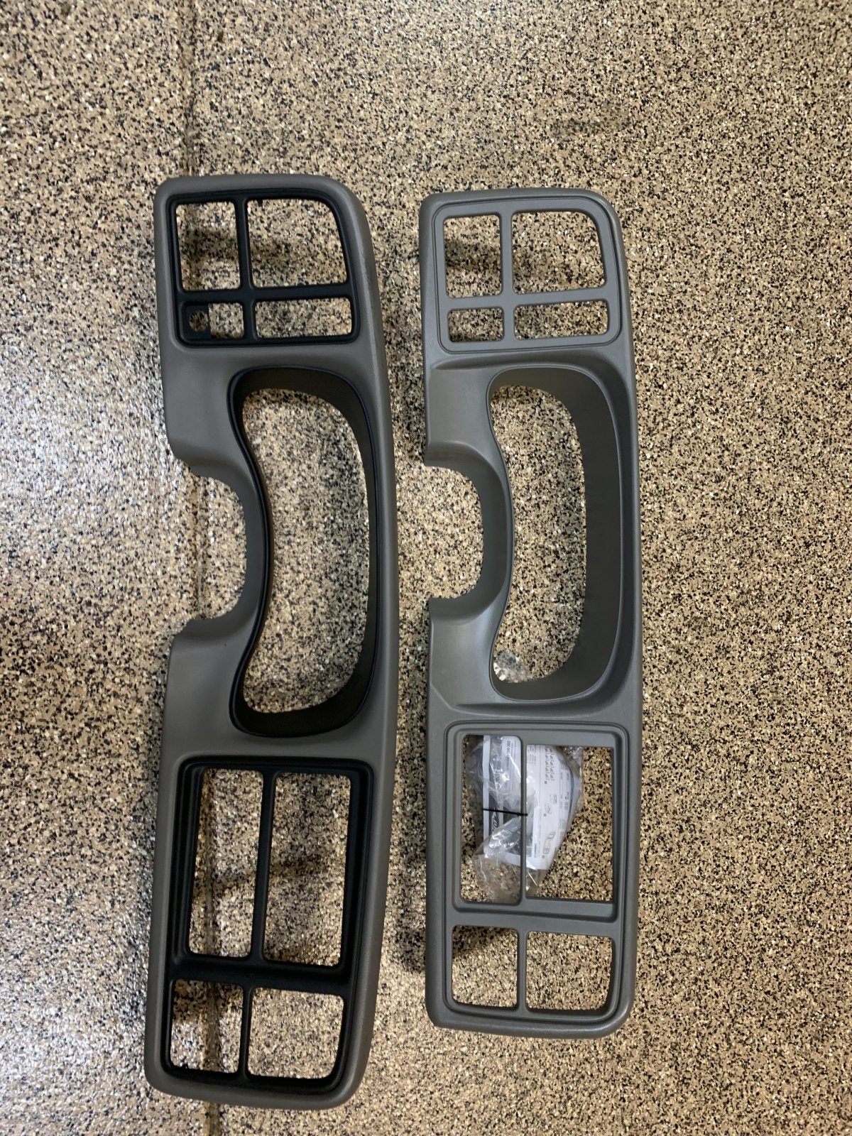

The problem is the double DIN size. These aren’t my pictures, but you would either have to fit a trim surround bezel on the new radio, cutting the factory bezel a bit…

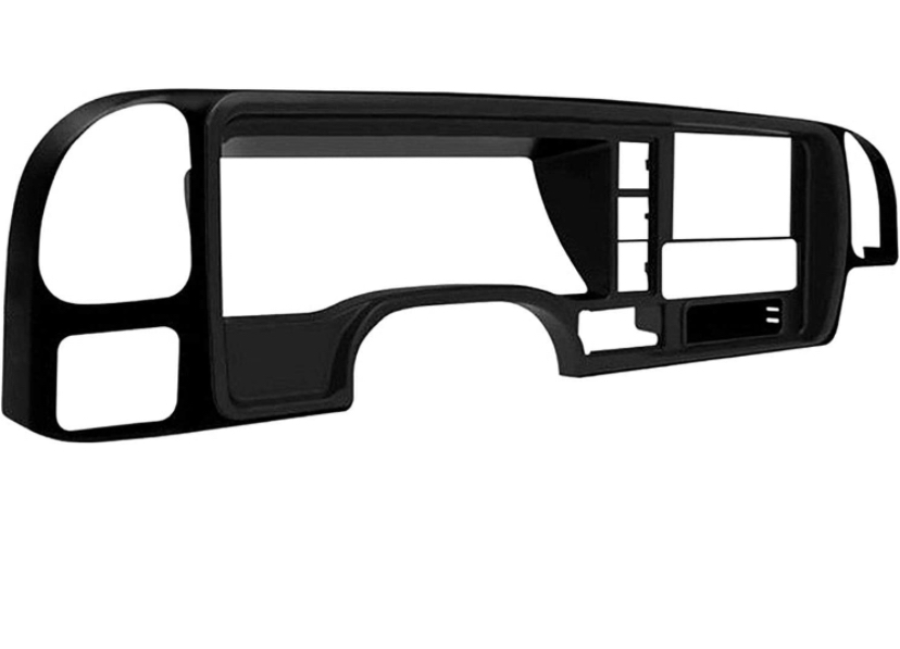

…or buy a new bezel. Metra DP-3003 is one and there are plenty of other manufacturers to chose from. That bezel (paint to match) has the opening sized for the double DIN so that you don’t have to cut out the plastic horizontal piece between the radio and HVAC control.
Metra’s kit includes a template for cutting new holes to lower the a/c control. Otherwise, the top of the labels are obscured:
I put one of those Metra bezels in my son’s 98 a year or so ago but didn’t take any pictures of it. The supplied clips were junk and I had to reuse some of the factory bezel clips though not all would fit onto the Metra panel. And so, it didn’t stay on all that well and we’ve since sold the truck. For the price ($150?) I thought they could have improved on the clip attachment points.

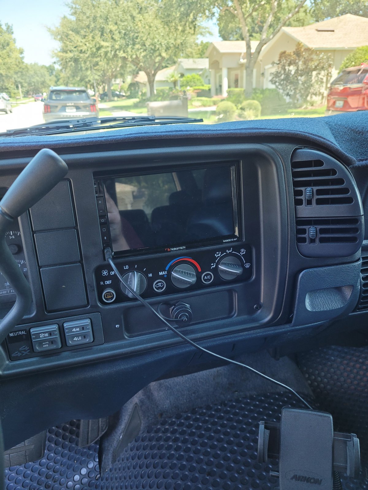

I put a double din in my 99. Had to get a new dash panel and I had to trim some plastic inside the din area. Hear is the finished product.

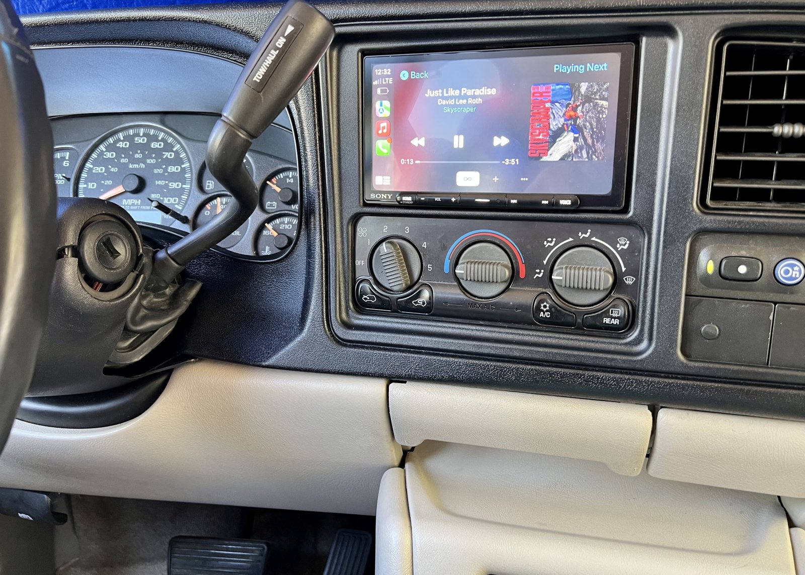

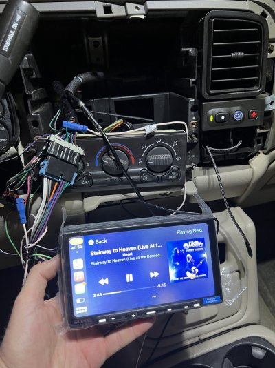

Sony w/out CD player fits in the dreaded 1.5XDIN space well because they are relatively shallow, but you will need a new Bezel such as this Metra. Don’t forget to change your speakers, they are likely blown and disintegrated. Crutchfield is super helpful.

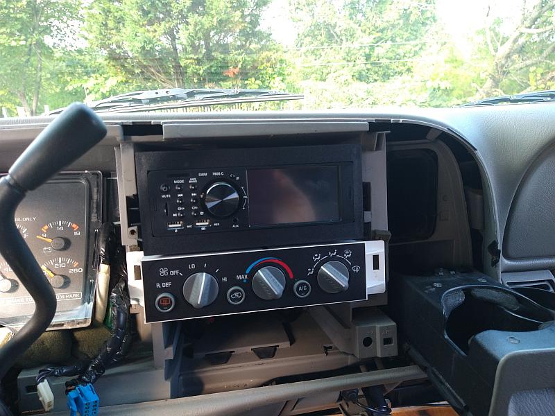

Got a little one Din thing with a backup camera and a trim ring for it that is supposed to be a direct fit. Don't really care much about the speakers. My hearing isn't that great and I may not have music playing anyways.

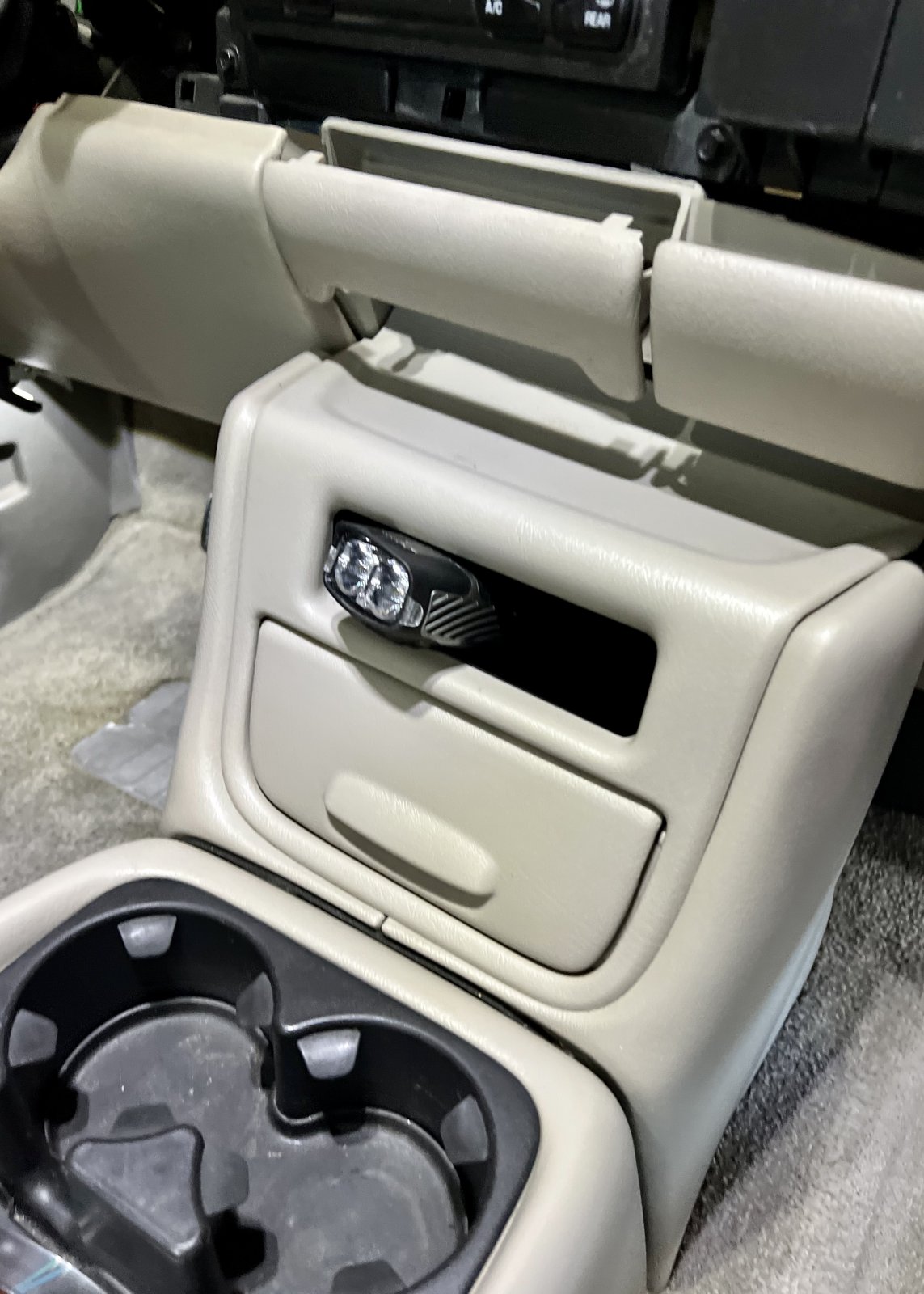

But now I'm wondering about the CD player and what might fit in that hole. Since I have to pull the dash apart again to do the radio, I'll probably remove it. Maybe some kind of auxiliary meters?

Pack of cigarettes or 2

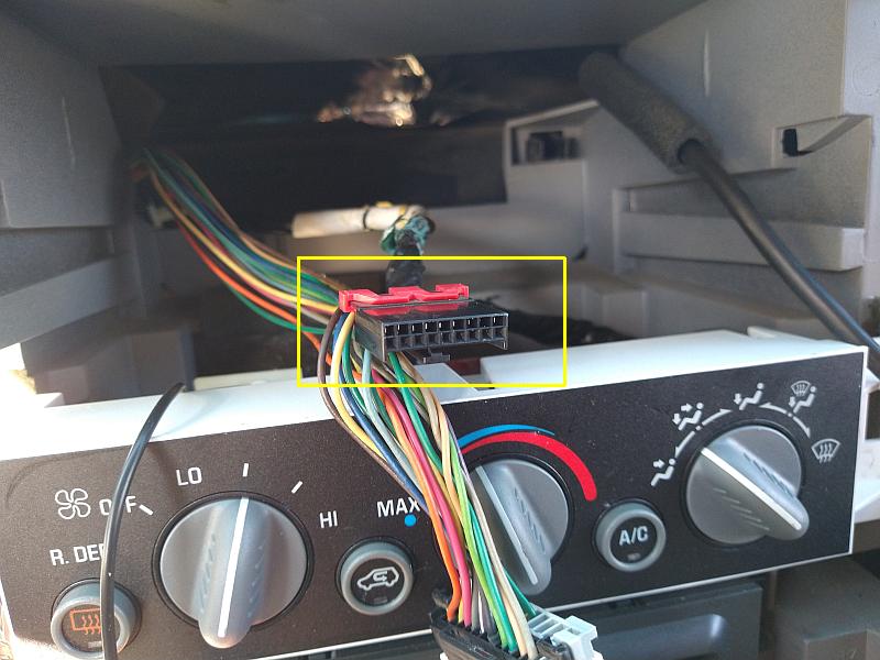

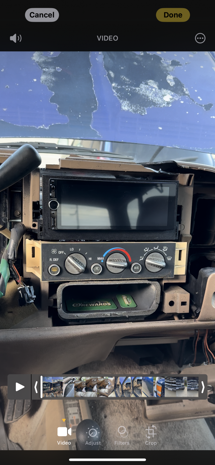

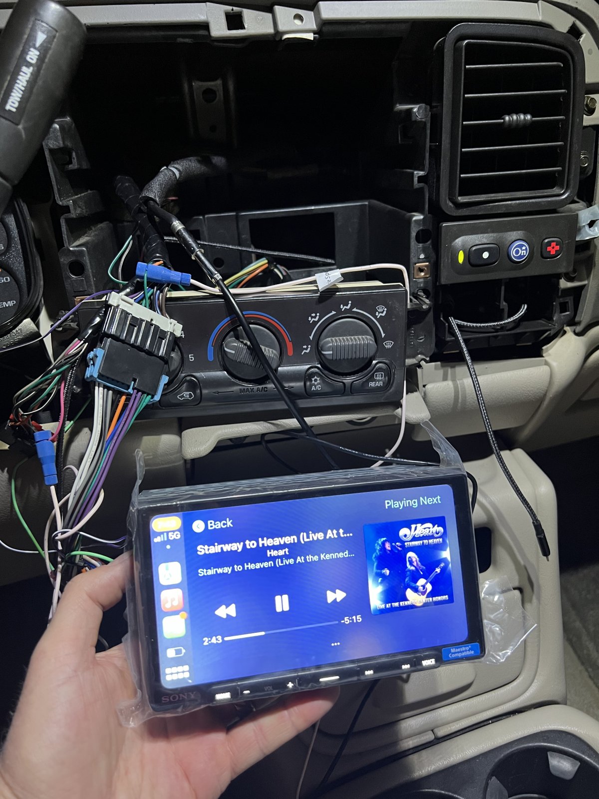

In process. Will get another shot of it powered up later. I was going to ask what that other connector was, but there was another one just like it plugged into the CD player, so that seems to be it.

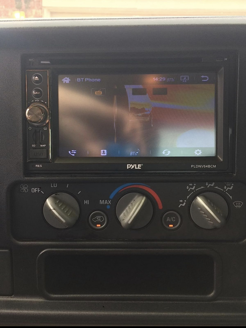

late but posting for people who might be curious in the future:
i have a single din screen installed on my rig. honestly depends on what you are looking for. although, mine was stolen a couple weeks ago so im replacing it with something more boring. but once im in a nicer area ill definitely be adding the carplay style radio again.
