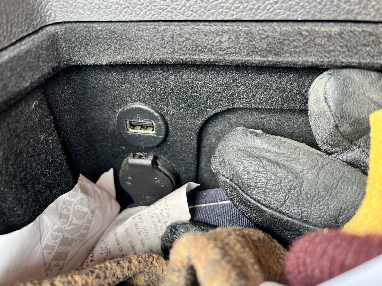

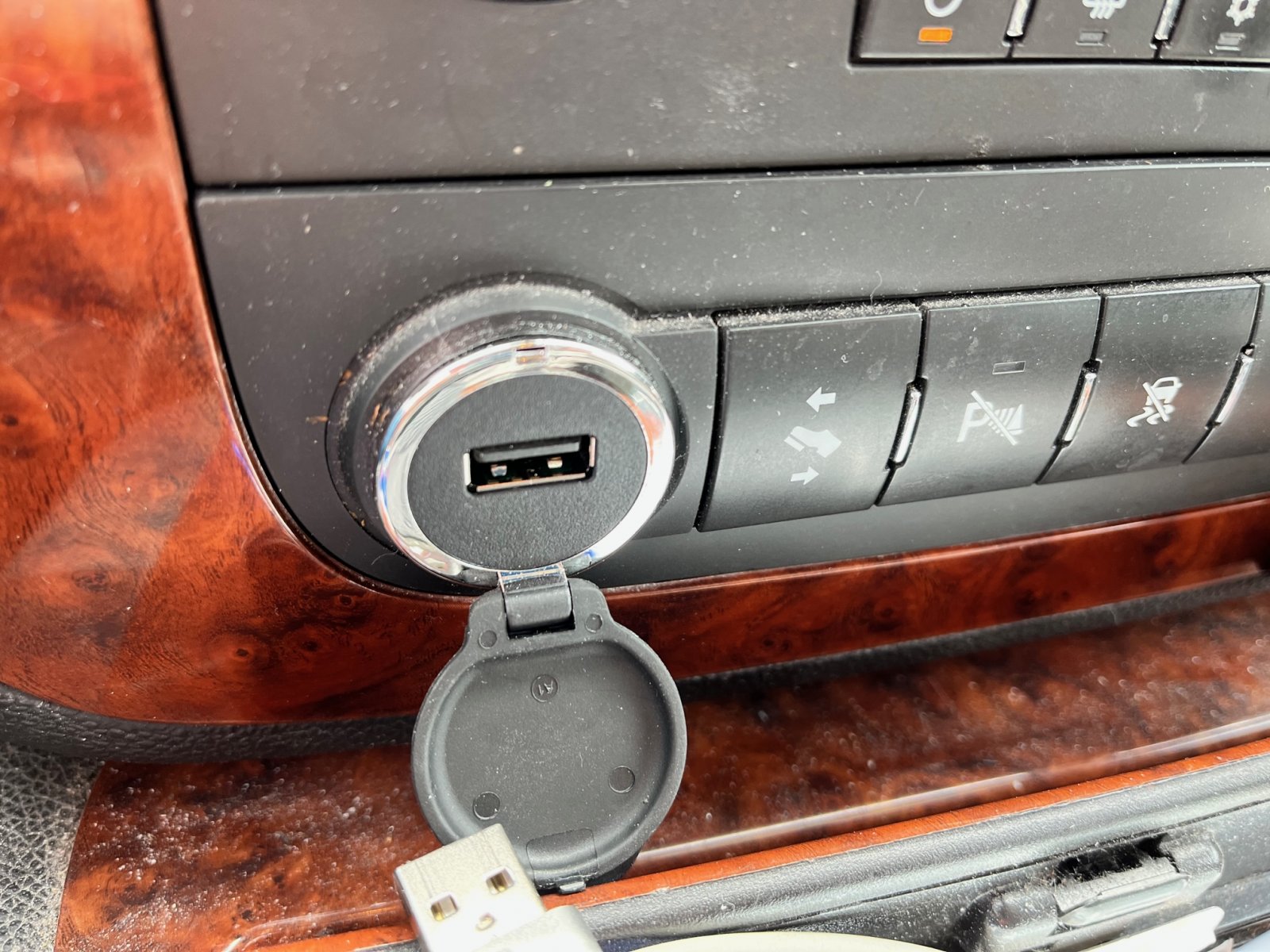

1) It Added 2 USB ports, one is for your phone, the other is for a USB Drive.
a) The USB for the iPhone does not seem to read a USB drive, and the USB port does not read my iPhone. Not a big deal,
b) I put the USB drive in my center console used a cord like this: https://dynavinnorthamerica.com/pro...~mk_chevrolet~lz_tahoe&variant=40776606679190
c) I installed a Factory USB drive in the Left Cigarette lighter port from a 2013 Silverado, I believe this is the one https://www.ebay.com/itm/1314456619...422996&hash=item1e9ac5a0d7:g:JekAAOSwYHNh5w3W , You will also need a USB A (male) to USB Mini B (male) cord, I recommend the shortest one you can find.

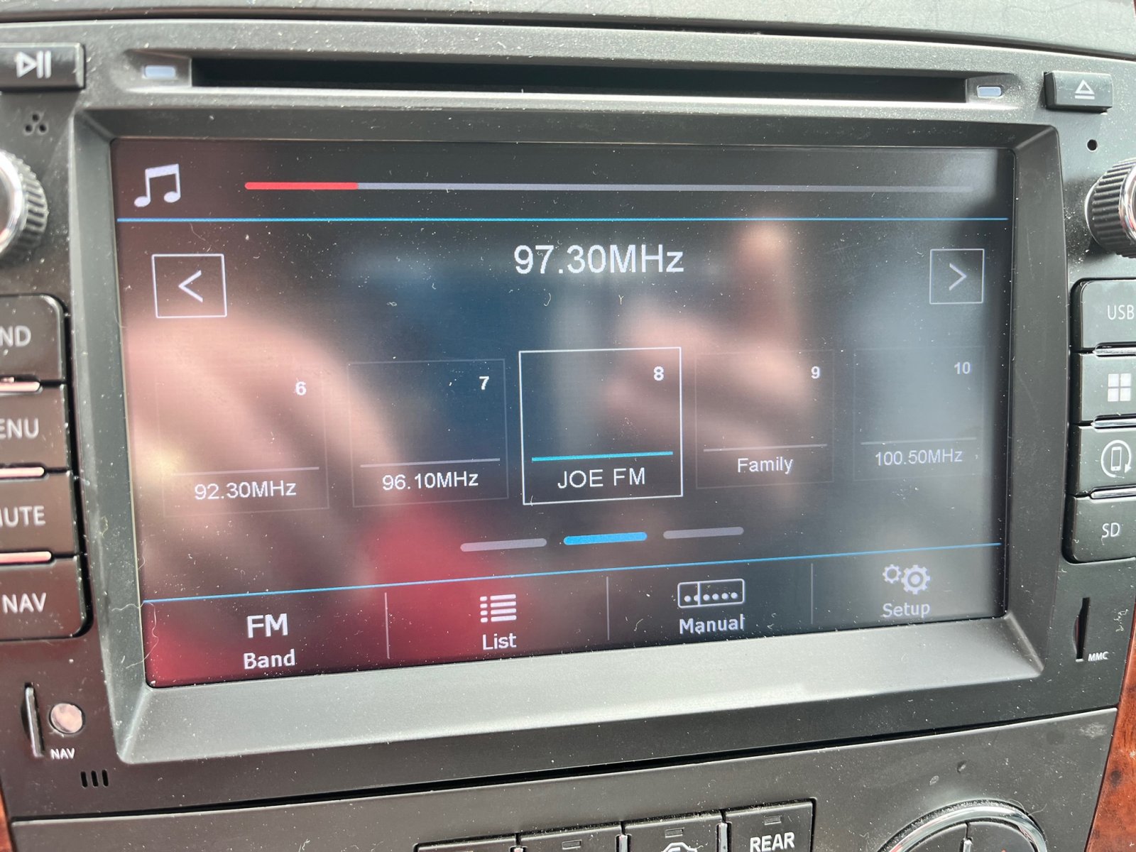

7) Once I got poking around the unit is pretty self explanitory and reasonably intuitive. Things make sense for the most part.

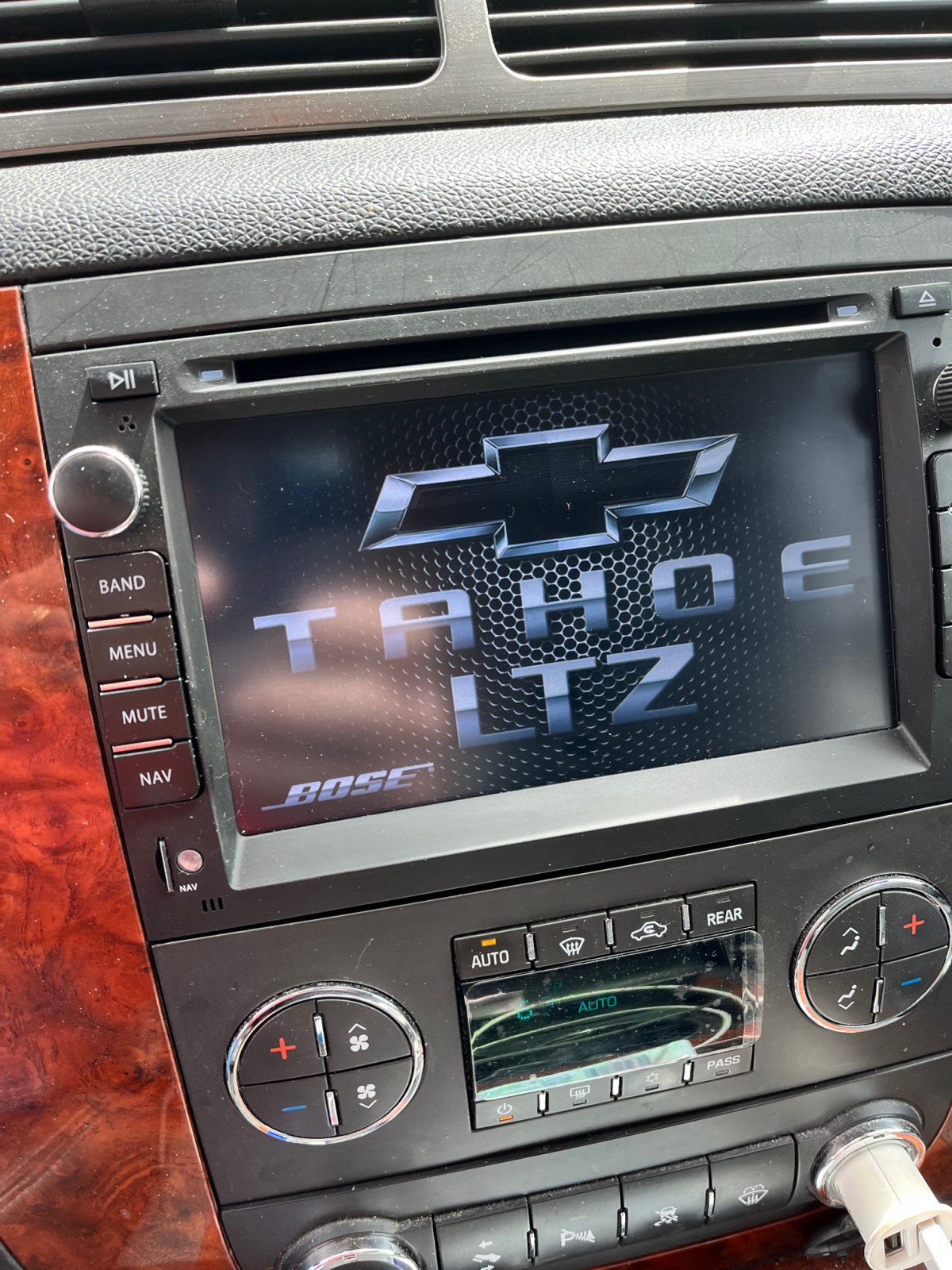

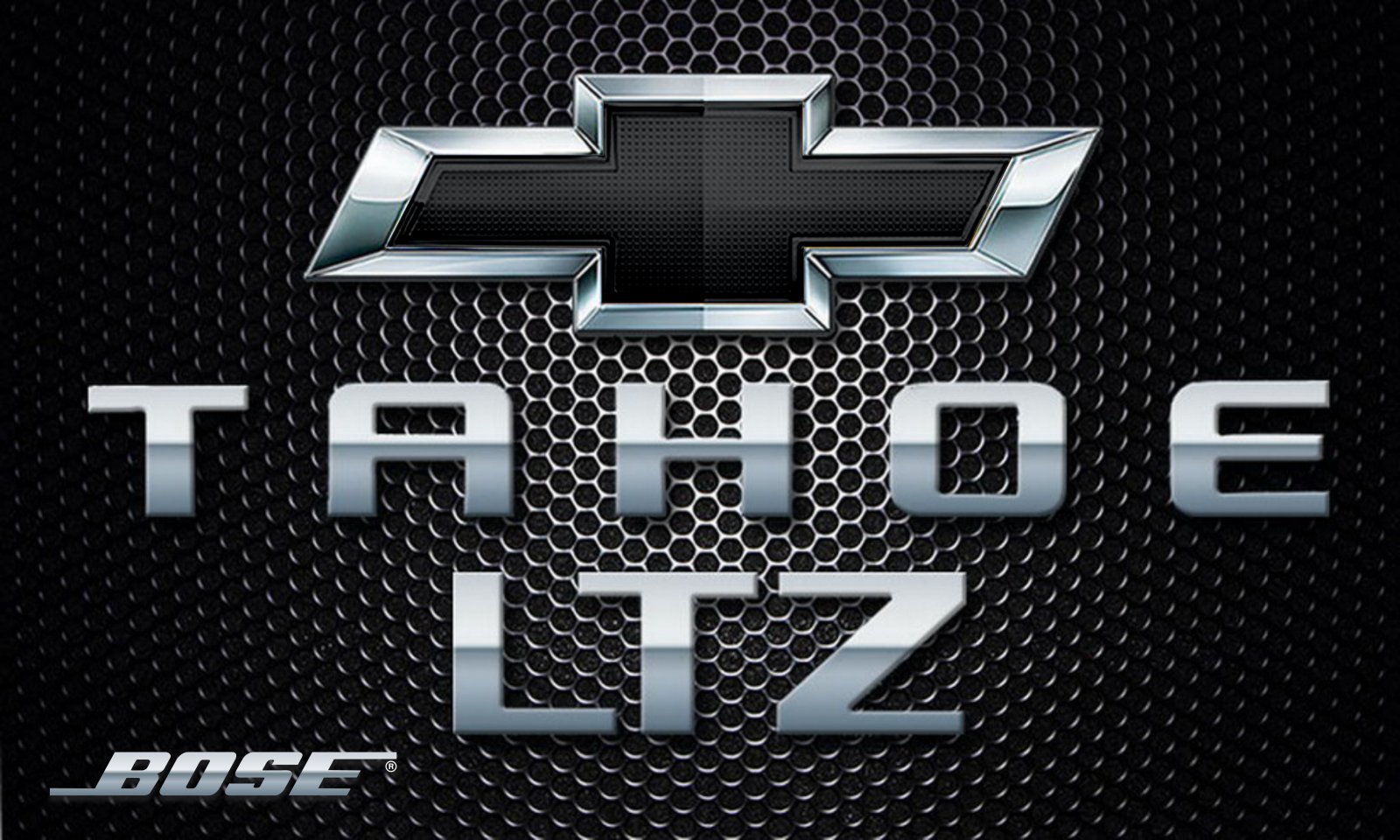

8) I was able to add a custom splash screen using a .jpg file, one that I made (I modified one from ADC Mobile).
9) You can adjust the volume of the chimes, the triple ding when you lock the door (more on that one later) the click sound of your blinker (More on that later), the key in the ignition chime, seat belts chime, the chime for the reverse sensors etc. You can only adjust ALL of them at one time, not individually.
10) When starting the Car the radio does not blink off and back on, it just continues to work.
11) It has an internal 15GB Hard drive you can put music and I assume videos, you also store your splash screens there.
12) You can upload music and images from either the Micro SD card slot or the USB port to the Hard drive.
13) There are controls for "Loudness" Bass - Mid - Trebble, and a full EQ, so you can tune your music to how you like

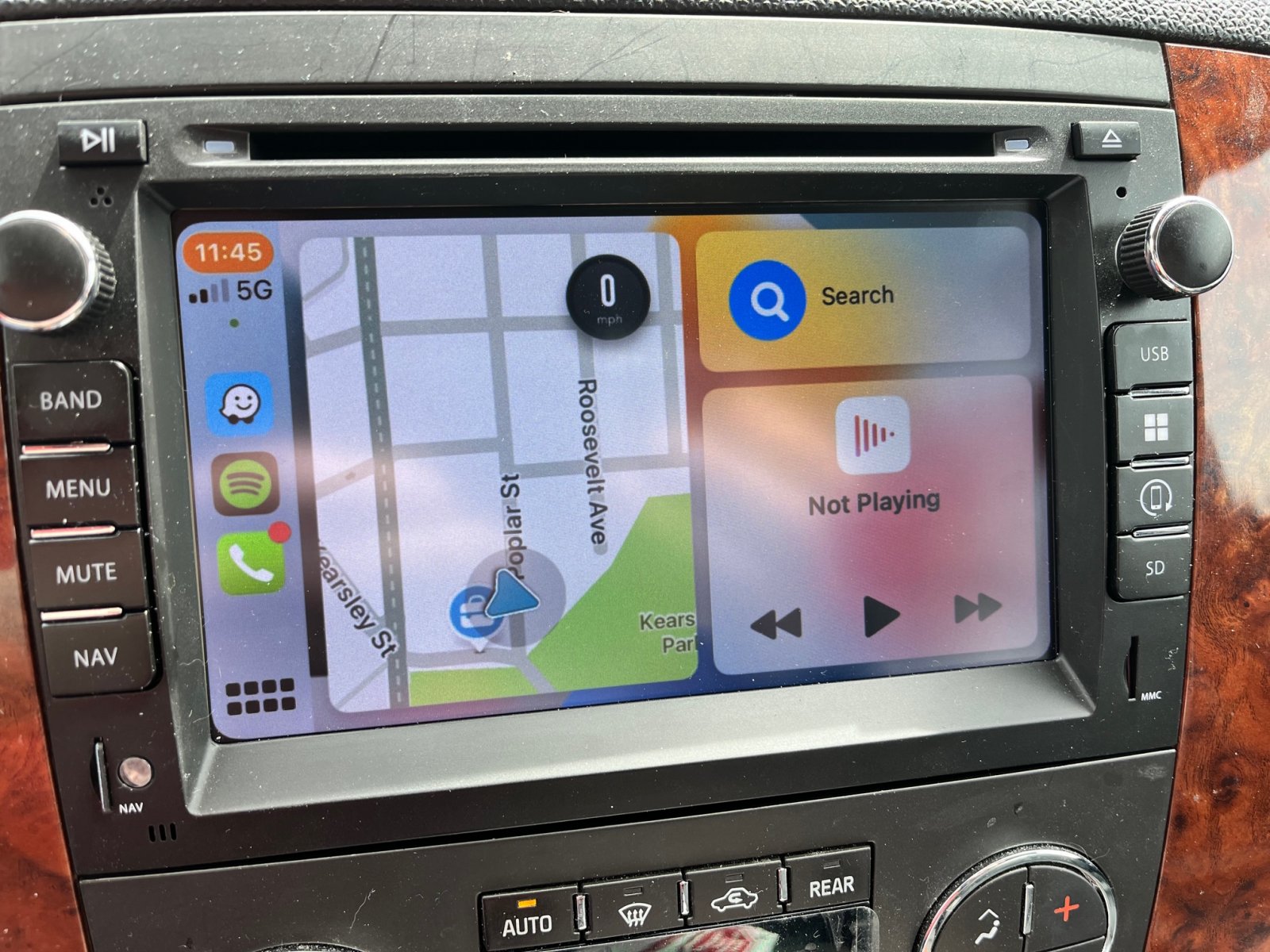

15) Apple Car Play works great, unfortunately it is not Bluetooth, it only works thru the phone USB.

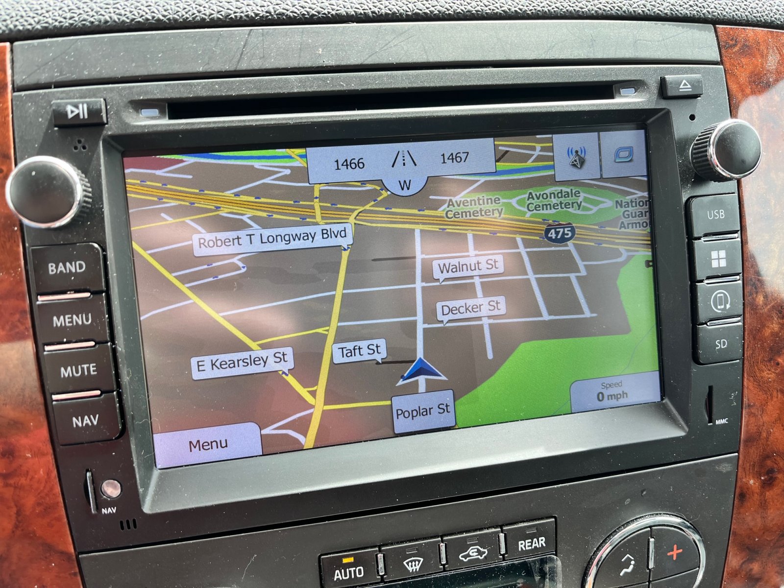

5) Once the radio is on, when you first push the NAV button, it takes about 10 seconds the FIRST time to get into the nav screen, after that it has no issues. Problem is, every time you turn off and start the car, it takes another 10 seconds to reboot.

7) Connecting the USB-iPhone sometimes takes about 15-20 seconds to connect to Car Play.
