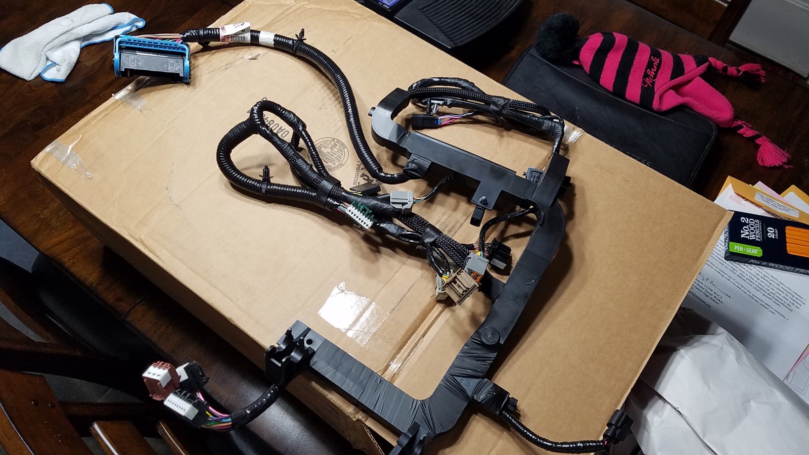

This is the wire harness in the front driver seat of an 09 SLT Yukon. Rather intimidating, but it was not bad at all.
