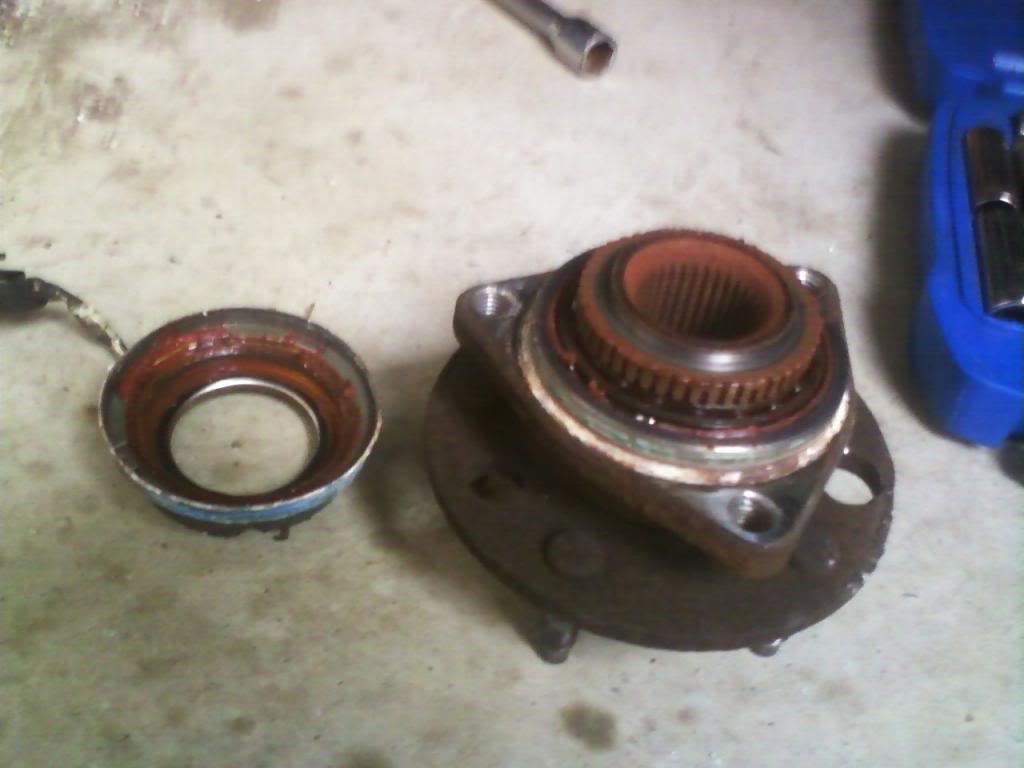

ive torn hubs open, the ring gear inside gets rusted up and the sensor cant read it no more a lot of the time.
this one was making the car pull left pretty hard all the time. was leaning towards a bad brake line or caliper till that all came off and it was super hard to turn it.
