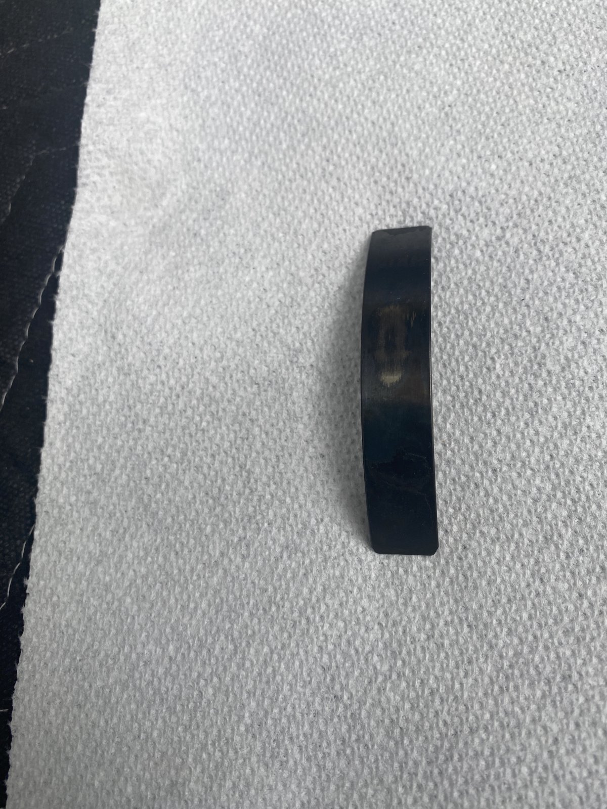

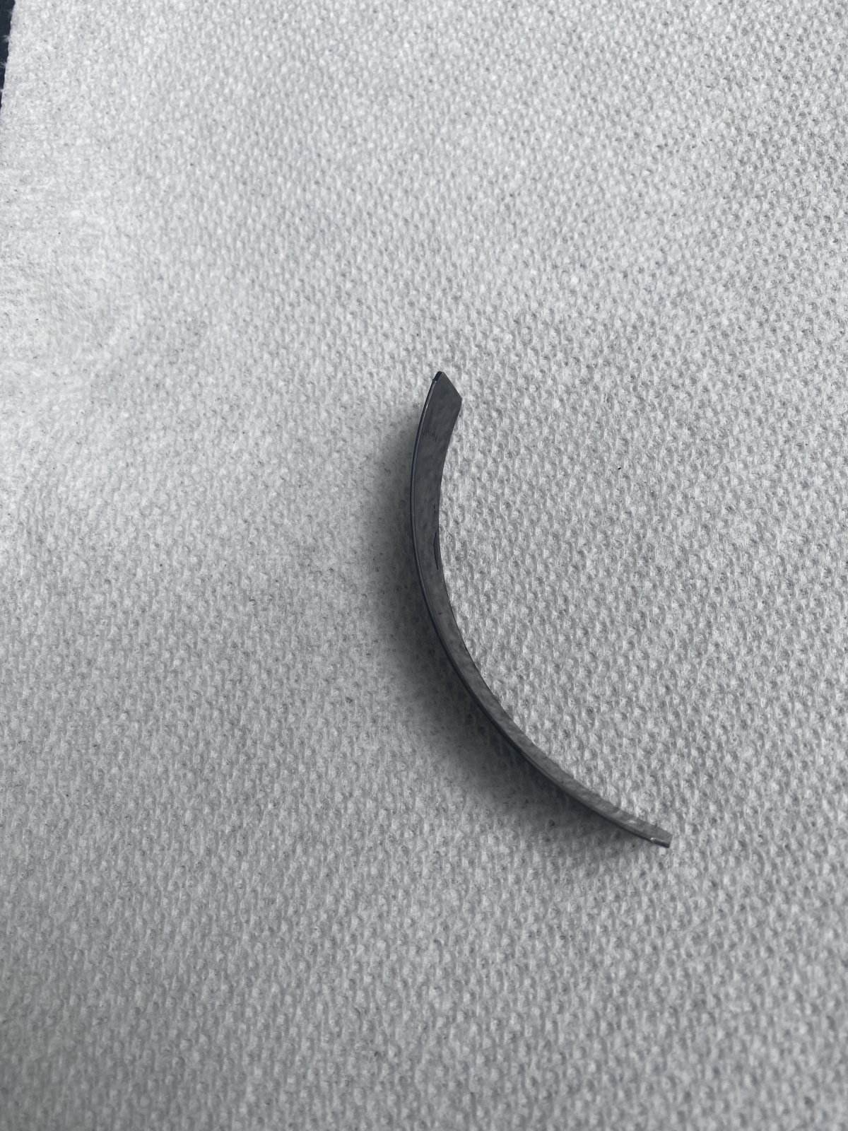

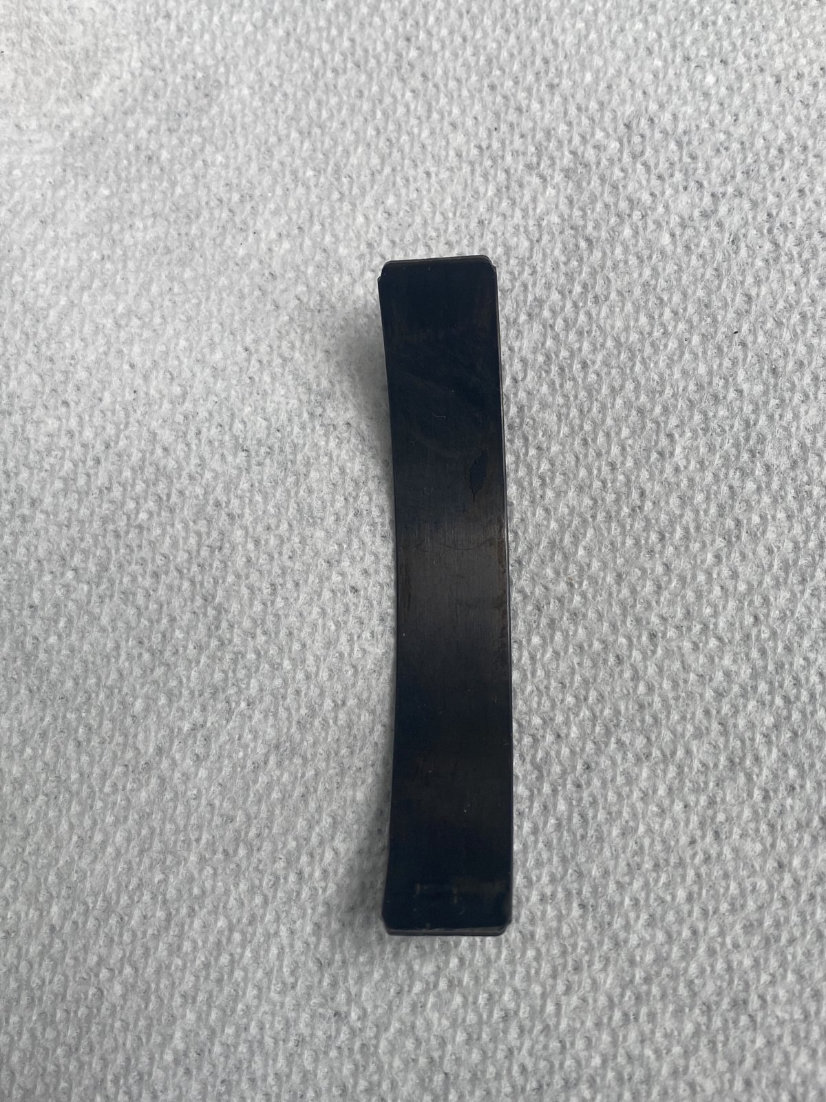

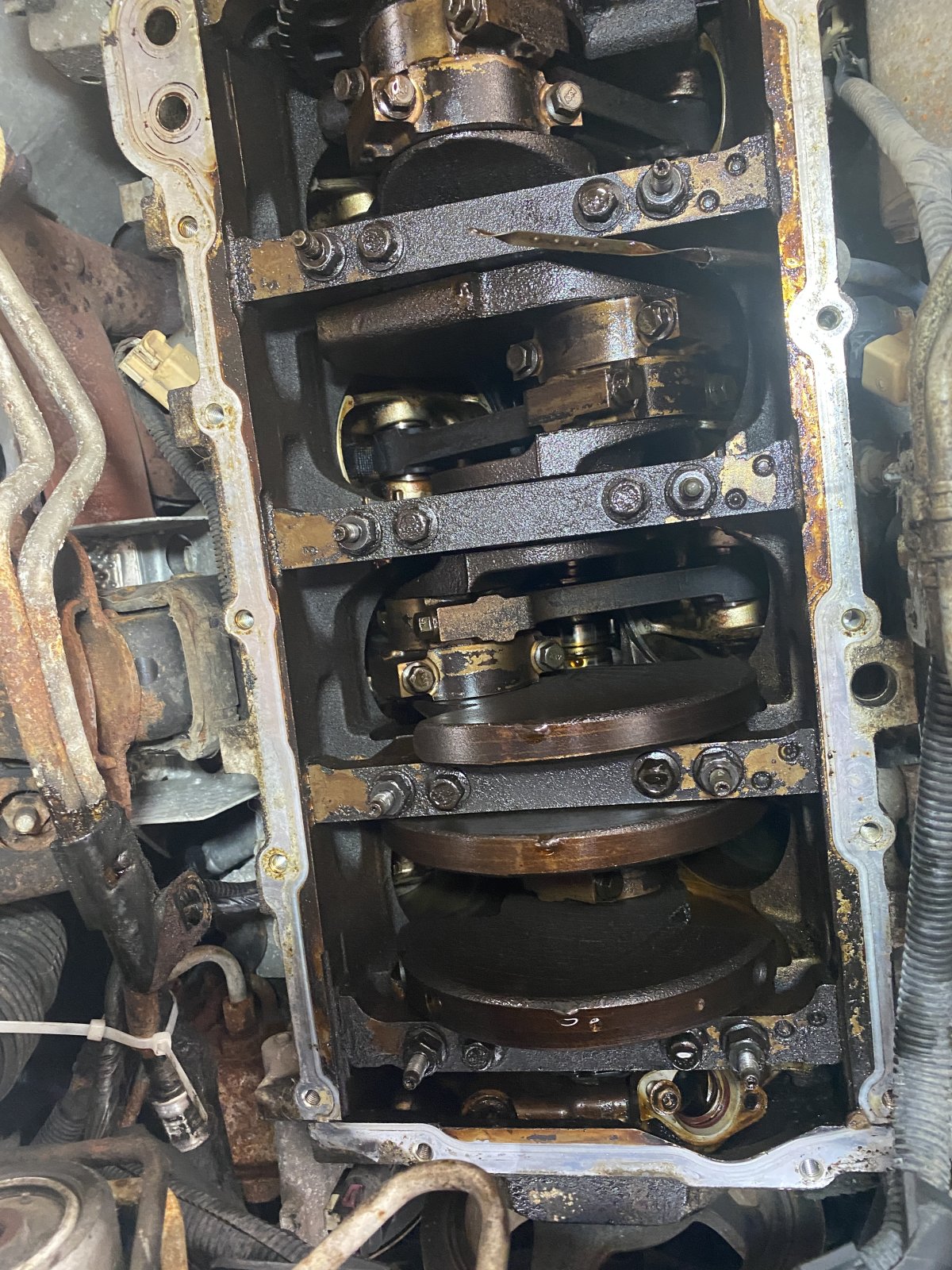

Removed my oil pan on my 2012 Yukon Denali to replace the take up tube O-ring.
Vehicle runs good, no rod knock, no broken cylinder connecting rods ends.
Does not seem to look like a connecting rod bearing.
Any thought what is is or where it came from?

While you have the oil pan off, you may want to replace the over pressure oil relief valve that's screwed into the oil pan itself. There is also a deflector available for that relief valve (GM recommended), so that when it releases oil, it deflects the oil back into the pan, versus onto the rotating parts above. These relief valves eventually fail in the open position, thus lowering your oil pressure.

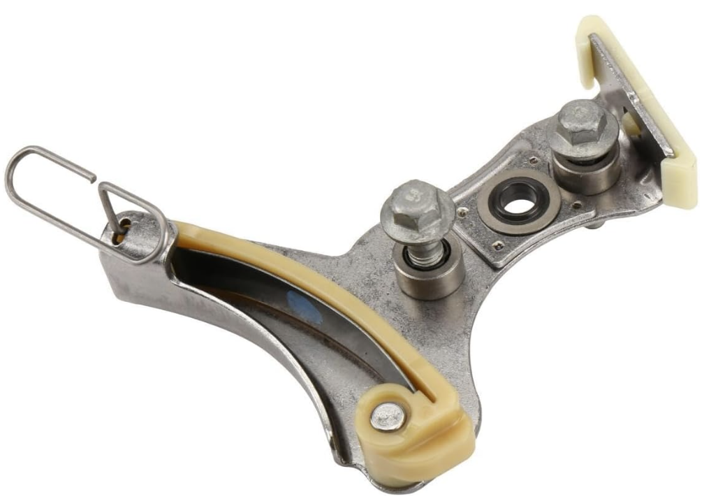

Excellent point that it could be left over. Not sure a boroscope camera will fit from underneath around the timing chain to get a view of the tensioner....
