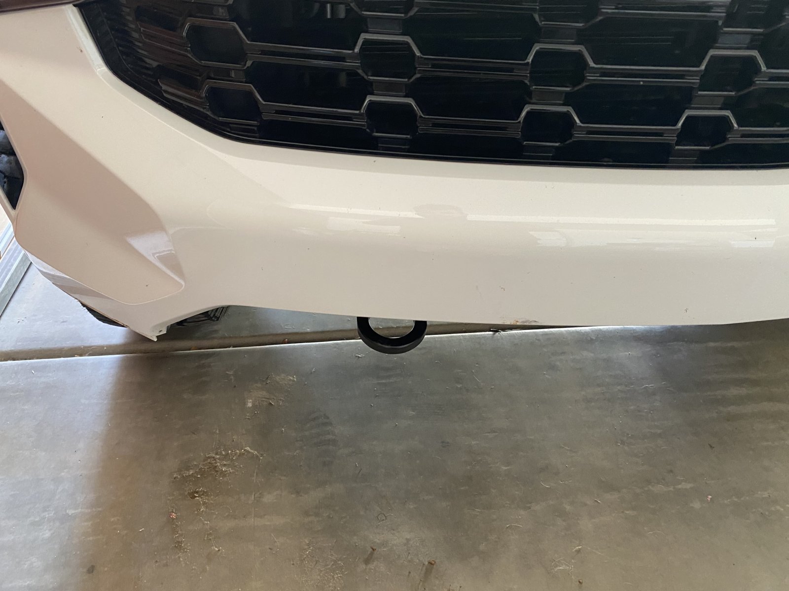

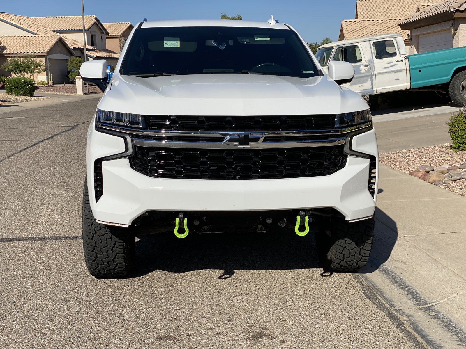

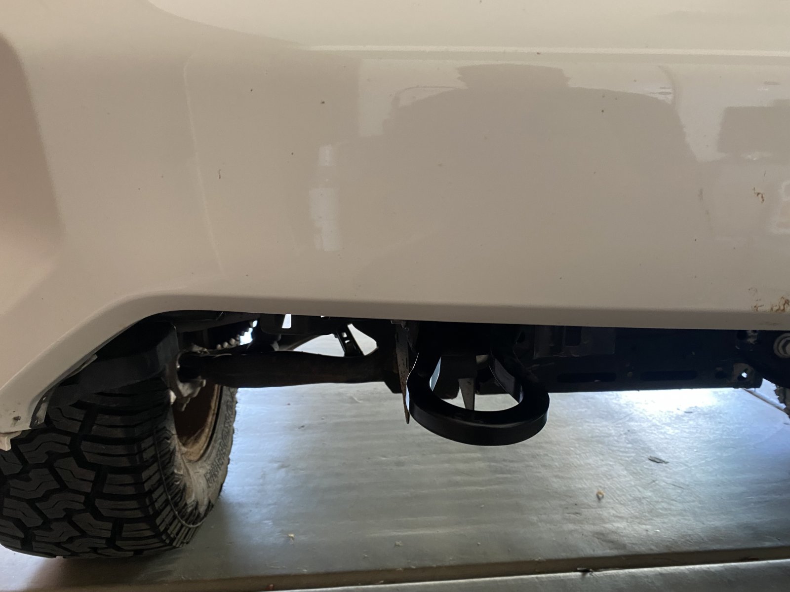

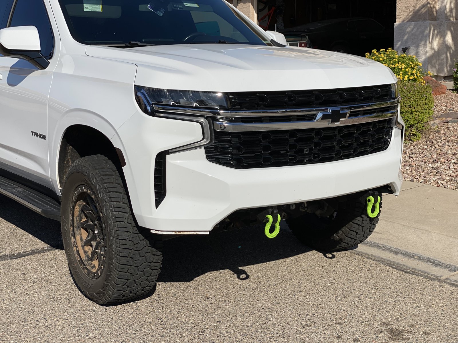

As long as you don’t have the active cruise control on the LT z71 tow hooks will fit. Just removed my lower clip today and checked fitment. Fits perfect but they don’t come out very far.
I’ve ordered some Silverado aftermarket tow hooks as they look similar. They’ll be here this afternoon and I’ll post if they fit. The regular tow hooks look identical.
csisson09
May 22, 2023
34
64
Interesting. How hard is it to remove the lower clip??
Trying to be gentle it took a few hours. It may have been faster to just take off the entire front bumper but I didn’t want to do that. I think it was totally worth it. I’m gonna do a custom front prerunner winch bumper in its place just the trapezoid section with a skid plate going down to the lower control arms.
Also! Silverado tow hooks fit Tahoe!
Had to drill one hole but I think that was a manufacturer defect.
