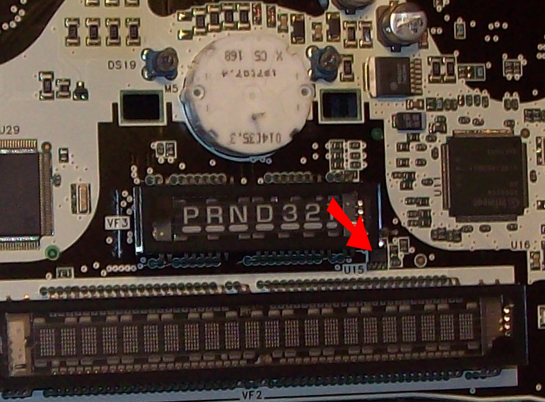

I know this thread is getting old, but I recently stumbled onto some new information about how to activate the trans temp gauge. It appears there is another eeprom on the the cluster circuit board that actually contains the mileage and engine hours values. I found a memory dump of this and it does not have much storage, only 256 bytes, so this is not where the cluster software is stored. What I found was a video of a guy converting a cluster to add the gauge and he updated the software through the cluster connector, but activated the gauge by reprogramming the eeprom with the memory contents from a 2500. He did this by connecting directly to the eeprom on the circuit board. He then reloaded the correct mileage with a Tech2. Apparently, you are only offered the ability to change the mileage if the cluster is currently at 0 miles.
This might be easy to do if you knew the exact format of the memory contents, and which bytes needed to be changed. I suspect it is only one byte that defines whether there is a trans temp gauge, but there is probably a checksum as well that would need to be recalculated. This guy did not try edit the memory, he just replaced it with the full contents from another cluster with 0 miles and 0 hours.
This is the eeprom:
