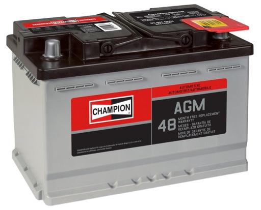

I had another one (of the four) optima battery I owned fail after a DVD player was left on. No replacement Optima were in stock for warranty so I got a Bosch AGM (now labeled Champion). It’s a flat plate design unlike the Optima’s spiral, but it rebounds flawlessly from a full run flat. With a four year, hassle free, over the counter warranty from PepBoys this one’s a winner.
https://www.pepboys.com/champion-agm-battery-group-size-h6/product/2071686
