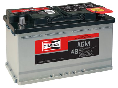

Since I discontinued using Optima batteries after almost two decades I switched to Bosch's AGM made by East PEnn / DEKA. Bosch ended their licensing agreement with Pep Boy's. They rebranded their AGM as Champion AGM, like the spark plug company. Johnson Control makes the Champion AGM batteries :) .
All four of my vehicles now run Champion AGM batteries made by Johnson Control who manufacture Optima batteries. HA! I found the biggest AGM battery for our power hungry Esky which is the H7-850CHAGM. It barely fits in the tray and kisses the overflow tank but for 1000 Cranking amps @ 32* and 850 CCA with a 4 year no hassle over the counter warranty, you cant beat it. When they go on sale expect to pay about $170.
The 07-14 have smart charging systems. They'll properly maintain an AGM battery including battery sulfation mode that determines the correct charge protocol to correct plate sulfation condition.
Here's what I have in the Esky. Purchase it over the counter from Pep Boy's if you decide on this one. They closed all their retail part stores and only have service bays now. If you want an AGM with a little less performance but made by DEKA, Sam's Club sells Duracell AGM for a little less with a 3 year over the counter warranty.

Thanks! I was looking at the H6 version which has slightly lower specs but if the H7 will fit without modification, thats the way I'm going. Someone mentioned JC being a brand sold at Walmart.

I heard the same but that was around the time I bought my Die Hard which was about 6 years ago. Just came from Advanced Auto and confirmed all is good except my CCA is low, down to 209. Definitely grabbing a battery tomorrow. Debating between the
https://shop.advanceautoparts.com/p...9-P?navigationPath=L1*14920|L2*15000|L3*15597
and
https://www.pepboys.com/champion-agm-battery-group-size-h7/product/2071662
leaning towards the Champion since it has similar features to my current die hard but the DieHard is cheaper and I can get it today...

After further research and a good night sleep, I decided to stay with what has done me good and go with the DieHard Platinum. I wanted the higher feature Champion but the DieHard seems to provide same specs as the previous DieHard Advanced Gold battery did. If I can get same life as I did before, it seems like a win.

Grabbed the DieHard Platinum. I was tempted to grab the H7 version for same price and has higher CCA and all but I was too scared of fitment so I punked out lol
