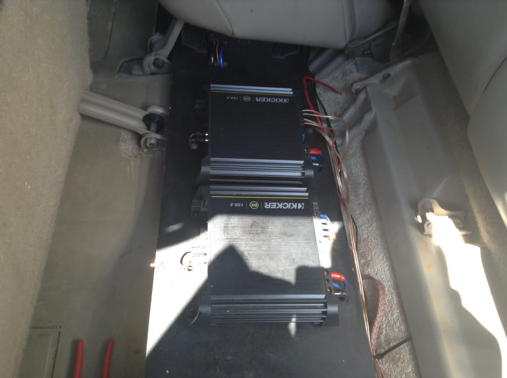

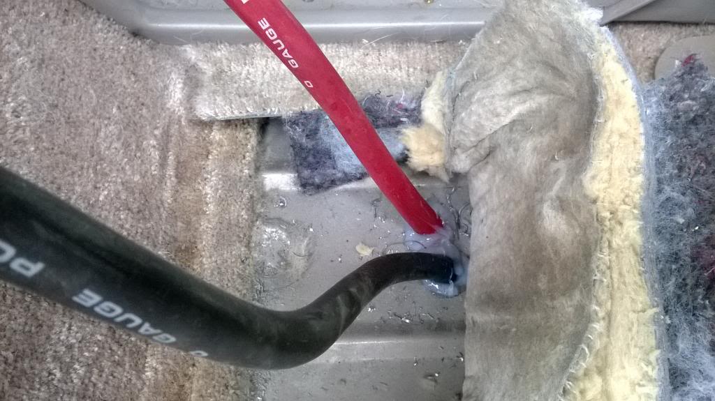

i just ran my 0 ga underneath the car and drill holes near the rear seats that where i have my amps at

Awesome, thanks for the pics. I just might do that too since its way easier than hiding them behind the panels

Just a quick safety PSA: Not to bag on getonerd's install, but always be sure to use actual plastic grommets (silicone is not the same thing) anywhere you ********* sheet metal and regardless of any other fuses in your system always place a system fuse within 18" of your battery connection. Failure to do so can land you with one seriously cooked (read: car fire) Tahoe.
