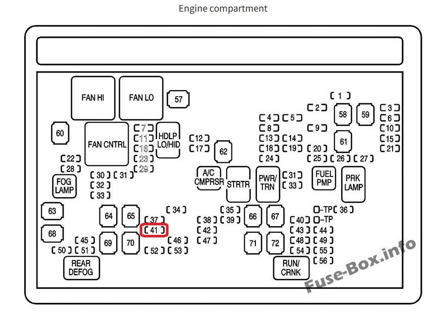

What "Uxx" RPO codes does it have? UQA/UQS, UQ3 (with or without UQ6), U2K?
Is there power at both sides of fuse #41 in the underhood fusebox? Fuse socket pin tension good?
