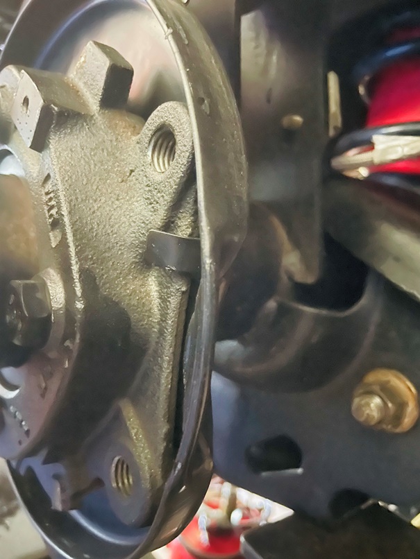

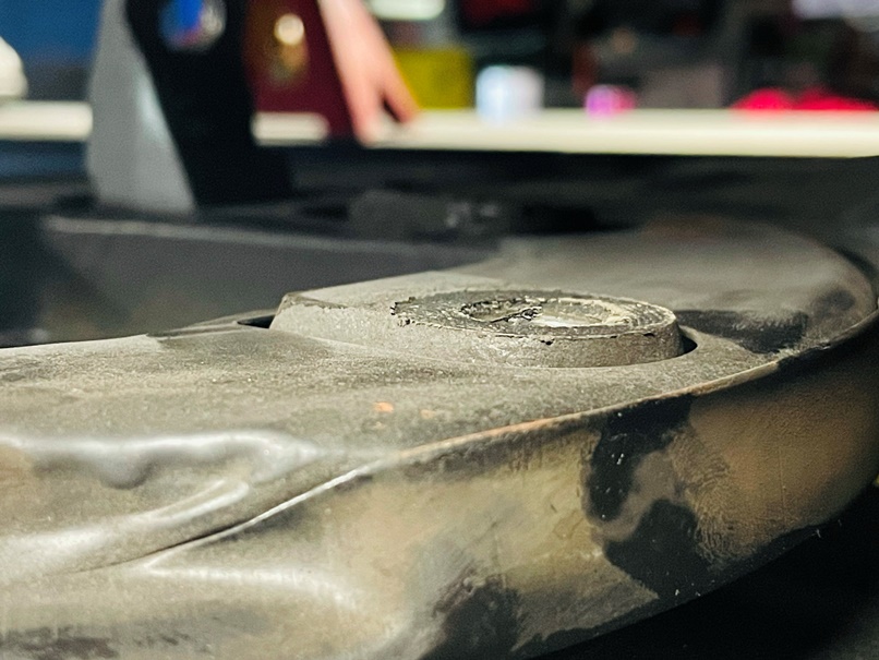

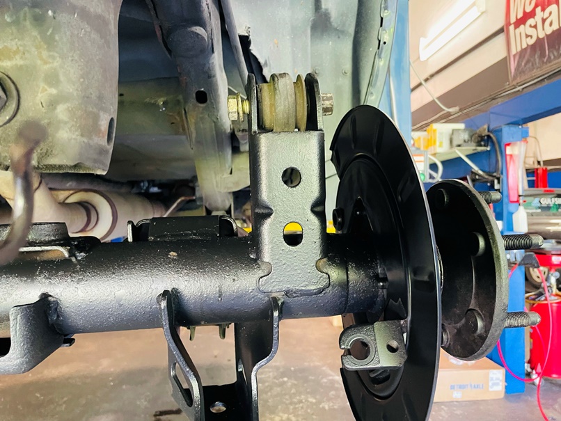

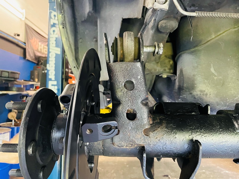

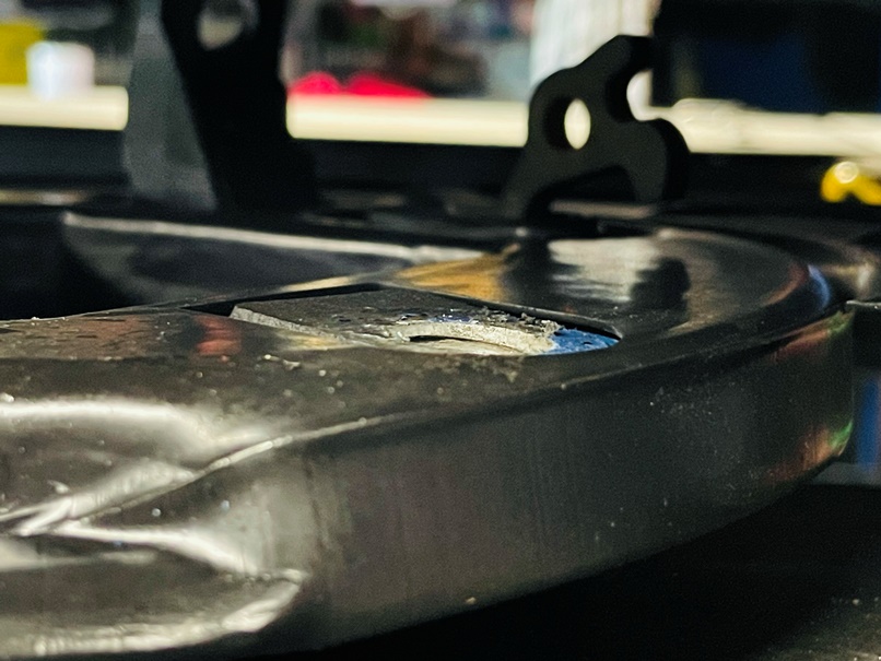

Okay, I need to rant. Jan 2020 I sprang for a reman. rearend for my 2003 Yukon XL form ATK (purchase thru JEGS). Within a few hundred miles, I started having issues with the limited-slip clutches shuddering when making turns. I finally contacted ATK and they shipped a replacement. I've had it for about a month and we finally got around to swapping it. I reserved my son-in-law's shop and lift (and master mechanic skills), to do the swap today. Right out of the crate, we notice that the left UCA bracket is bent about 4 or 5° out-of-square with the diff. We debated and decided to proceed with trying to straighten it. After about an hour of experimenting, we ended up heating the bracket with a torch and beat the snot out of it with a 5 lb hammer. We got it reshaped and proceeded. Then we have some issues with the right rear rotor and caliper not aligning correctly. Upon closer examination, we noticed that the brake bracket is seriously bent. So much so, that the caliper dragged on the outer edge of the rotor (probably about 1/4" out). We ended up having to remove the rear axles from both units, swap the brake mounting plate, and then reassemble the diff., axle, and brakes. Of course, that means drain all of the brand new gear oil limited-slip additives and trying to save it. So a two-hour swap took six hours, in all. It was very obvious that the truck this came out of took a hard hit on the driver's side, bent the UCA bracket and the brake backer bracket on the opposing. Shame on ATK for not inspecting the cores before rebuilding them. It is so obvious that no one on their reman. line cares. The UCA bracket was so tweaked, I noticed it the second we opened the crate. This means that all of the people that touched this thing ignored the damage, including whoever crated it. So, if you're considering buying from ATK, maybe you'd better reconsider.
View attachment 347032View attachment 347033View attachment 347034View attachment 347035View attachment 347036
Thats ALOT of tweaks to the steel of the rear axle! Obvious wreck damage there unless ATK dropped the axle form 20ft, 30 times! Excellent rework of the metal. You guys did a fine job there. Looks like a factory new piece.
