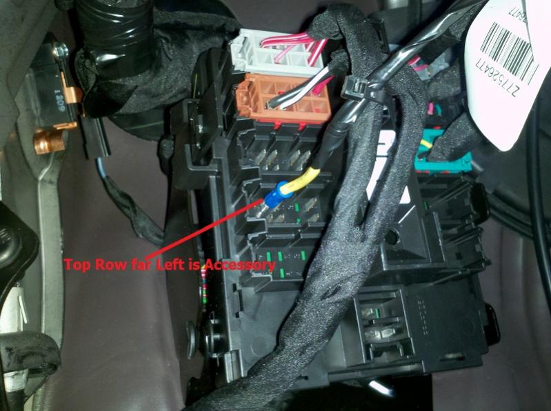

Here ya go! The box pictured is to the direct left of the brake pedal...picture is showing the cover off.
I can probably get you switched supply at the mirror...but I don't have that info handy at the moment.

I found it. Its actually the same color it was on my 03 tahoe. Had to break down and by a new voltmeter though:(
---------- Post added at 09:08 PM ---------- Previous post was at 08:11 PM ----------
I just taped in right at the mirror. Well under the headliner of course but there are multiple sources to use up there for the +. I was not about to take the time to run wire all the way to the fuse box. Any low level radar detector isnt going to pull enough power to mess any of those circuits up anyways. Now idk about the nicer Passports and what not
