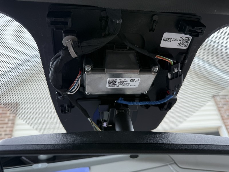

OK, the deed is done.

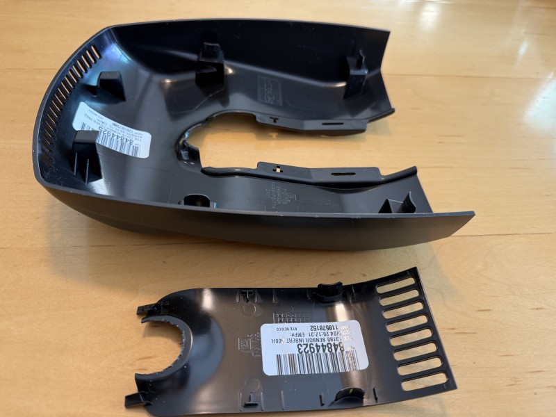

1) Remove the center section of the cover on the windshield camera and wiring. This was very difficult, as the center section did not want to come out , the retainers had so much grab on it.
So I used a fork in the slots at the top, and pulled down while my wife held the main cover in place. I did not want it to come off before the center section. PULL HARD at the top, lift bottom up and out so pins which stick down don't get broken off.
look at the pics to see how the tabs fit in (top is to the right)
2) pry under edge of main cover at 10:00, 2:00, 5:00 and 7:00 oclock, and lift off.

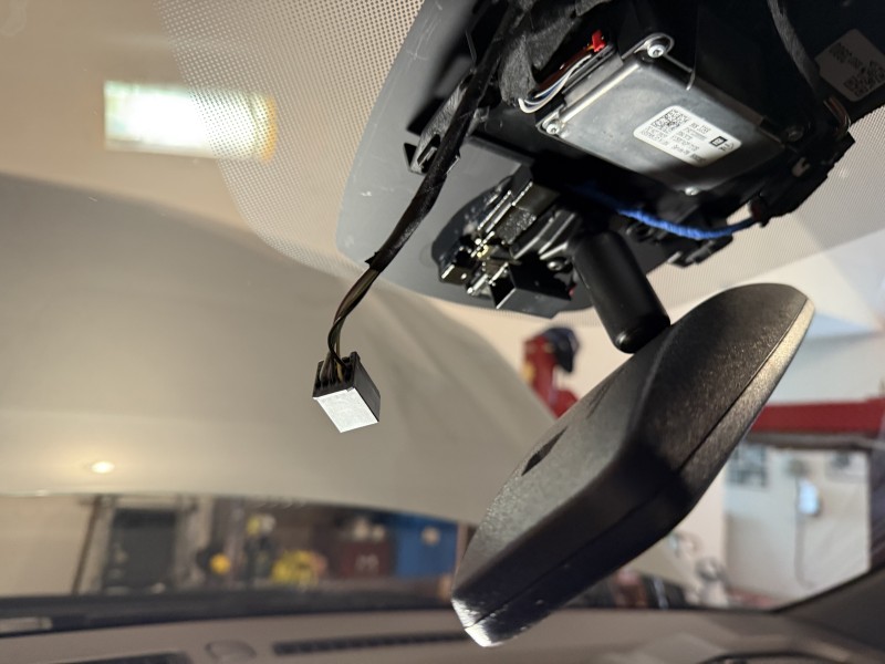

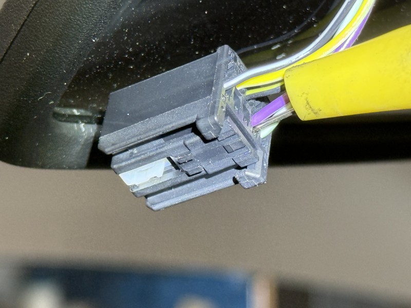

3) The connector you want is at the bottom , and runs horizontally
notice the ( +12 Volts with ignition on)Violet wire at Position #2, and the (Ground) Black with White stripe at Position #5

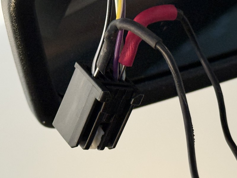

4) place the pins in the back of the connector, 12v in the violet hole, and Ground in the Black/White hole
replace the connector into its mate.
If you are just powering a detector , you are done, you can replace the main cover , then the center cover.

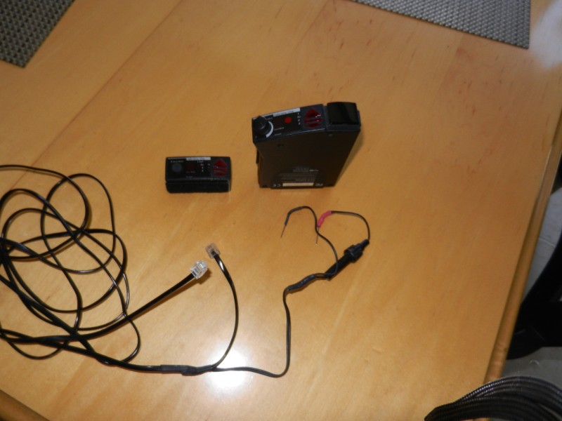

In my case, I had made a harness, so I could use the remote mute button. Here is the harness, and a diagram of how I constructed it. I ran the wires under the headliner, across to the left A Pillar, around the A Pillar to the outside, down the A pillar under the gasket to the bottom of the Dashboard, then up through the dash alongside the moveable steering column, then over to the remote.
Here is the remote , mounted on the dash, and the detector mounted on the windshield. The advantage of the remote is that the V1 is dark when using the remote.
