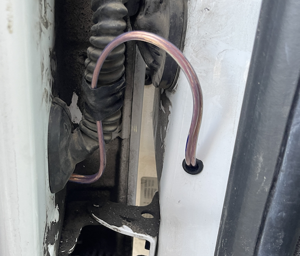

I decided to do it the easy way. Also, I don't care how it looks, so that helps.
I cut a small hole in the bottom of the rubber boot on the door side. I didn't want to mess around with the plug connector in the pillar so I drilled a hole instead. From there, it was easy enough to run the wire along the door sill and up to the front. I may put a bit of RTV or similar in the grommet eventually.
