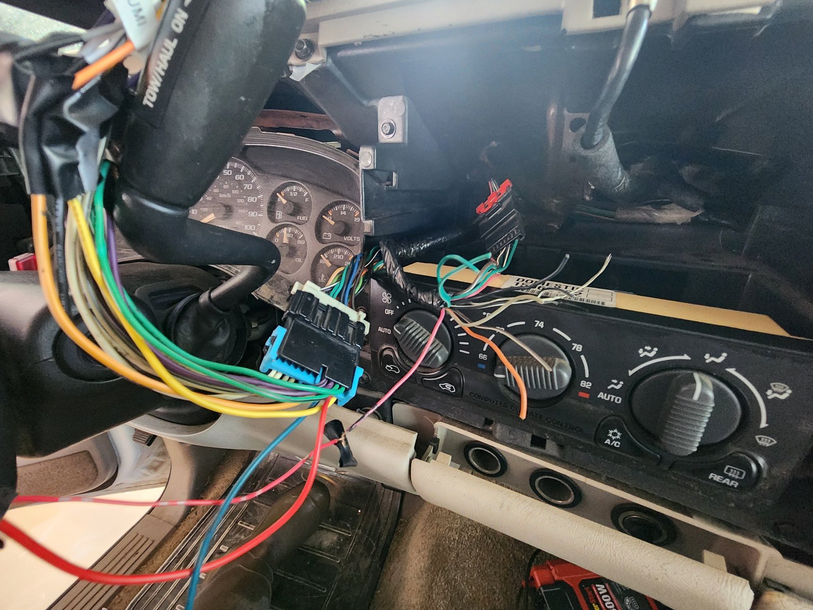

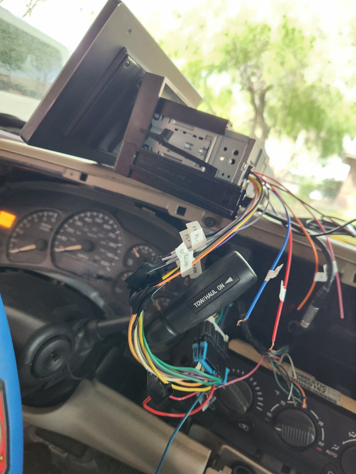

Hello all,
I hope I can get some help before I lose my mind. I'll put as much information and pictures here that I know. Any help is appreciated.
I have an 02 Tahoe non bose, with on-star, had center console with rear audio controls but removed it for a needed jumper seat.
P.O. had installed pioneer single din H.U. To my recollection there hasnt been sound in rear since I've owned tahoe (about 9 years) I'm upgrading to a tablet style unit.
On install noticed some wires clipped from 2nd harness. I don't know if i should connect them or which wire goes to which.
I have sound in front speakers but none in rear. Checked rear speakers and they're good. Checked amp fuse and it's good. Connected to front speakers to see if sound would go through - no sound. I've connected the pink wire and I'm getting sound in front. Not sure if I'm connected to the right pink wire because I see two. Unit powers up and works fine.
I've connected the blue wire still no rear sound.
I've read about still needing that secondary harness but not sure.
I ordered a factory amp bypass harness to see if that works. Using tape as temporary until the problem is solved.
Thank you

I believe that since you removed the rear control that you will need to jumper a couple wires on that harness to get rear sound, which wires exactly I do not have memorized at the moment, but pretty sure it needs to be done.

Hello,
So I had a chance went and connected like colors for the wires but still no sound. Could it be a bad factory amp? Any ideas, I thought maybe connect power to the other pink wire still nothing.

I got the bypass harness and got the same issue. I haven't figured out the second harness wires that were cut and which wires to connect on the main harness. Any thoughts?

I would do a little more testing, verify the rear speakers even work to begin with. the link @Fless provided above is the factory wiring diagrams.
once you have verified the speakers are working, then test at the amp output and figure out where the issue is in-between if both the amp output is good and speakers are good.
if the amp output is not there then verify it has input, just a matter of troubleshooting one step at a time.

@Fless and @Doubeleive, I figured it out ot was the rear audio control. I remembered i still had my center console from when I swapped out to a jumper seat. So I plugged it in and got sound back. Thank you again for the help. Now I just gotta figure it out how to jumper it.
