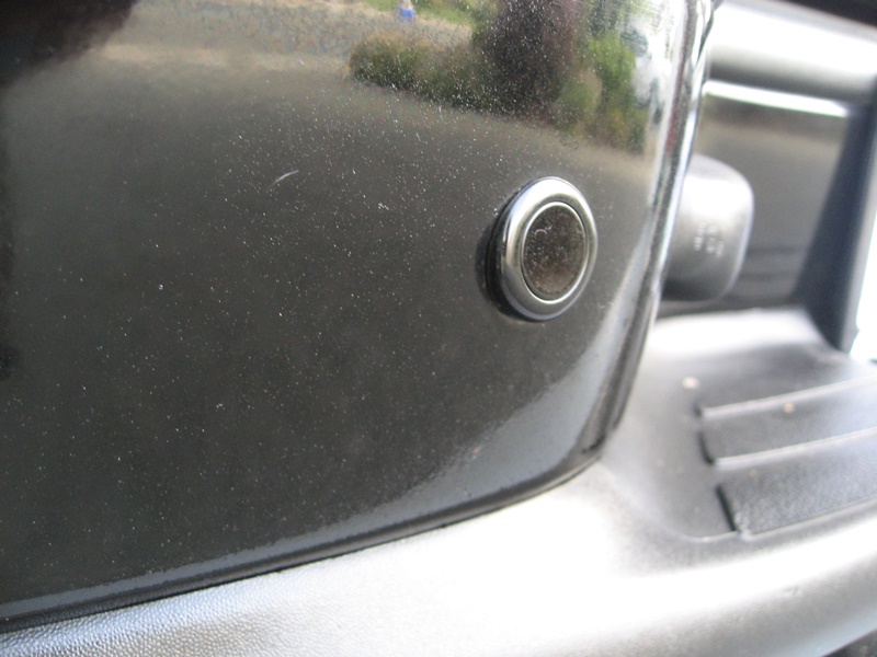

Bumper sensor ... there are four of these across the width of the rear bumper. They look factory to me.

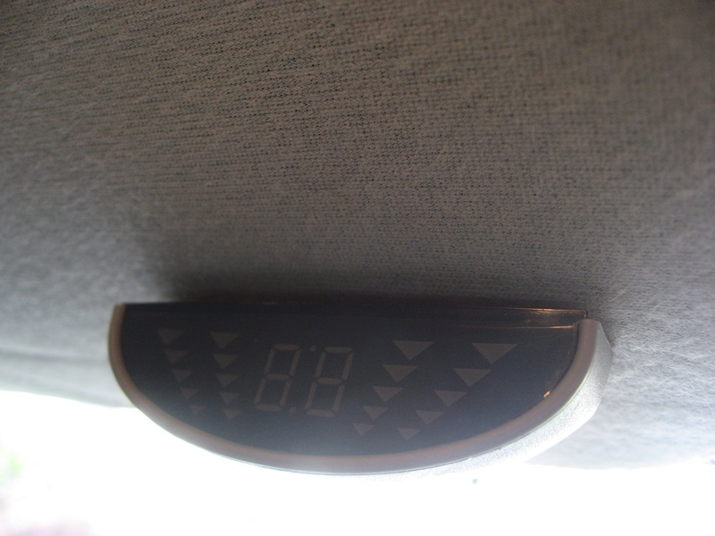

Rear display (for distance?) ... this is mounted on the ceiling at the back edge of the headliner where it meets the tailgate. The wiring routes along the headliner then down behind the D panel trim. Again, looks factory.

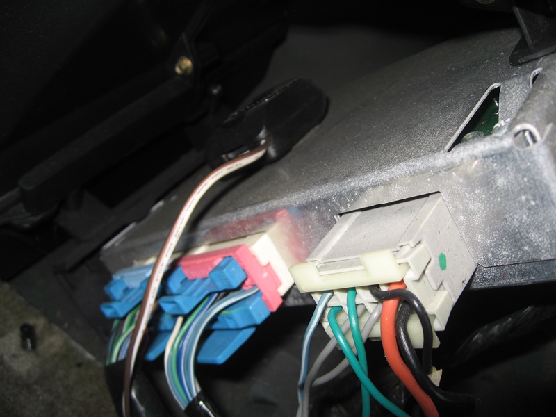

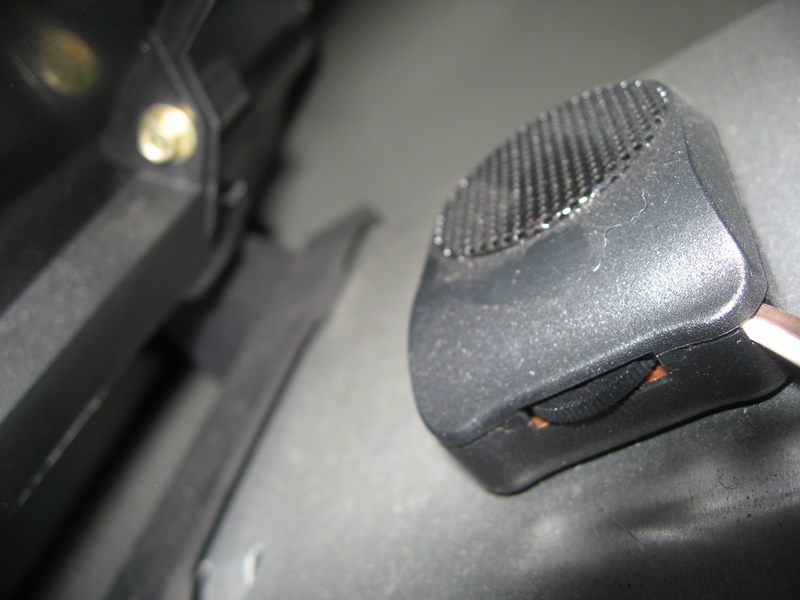

There is a speaker with a volume dial stuck to the top of a module.

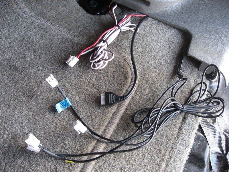

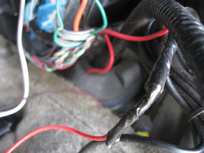

And here are all the terminated wires from behind the trunk trim panel with nothing to plug into:

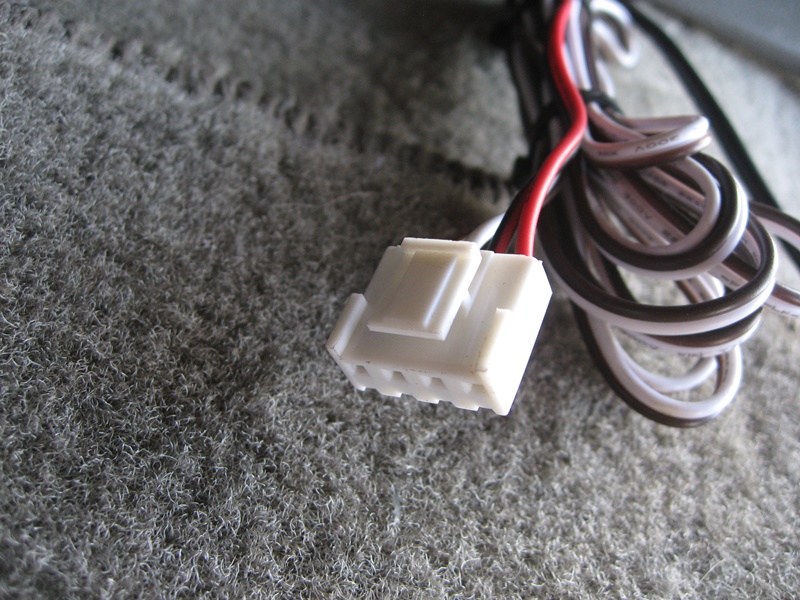

Closeup of the sensor wires and what I believe is the diagnostic plug
BTW ... there is no button on the dash to enable/disable the parking assist feature. I believe the Cadillac ESVs of this year have a button.
Would really love to get this working. Can anyone offer some advice or direction?

One more image ... here's a closeup of the four wire harness ... red wire assume is power, black is attached to a ground under the carpet and the other two wires route to the speaker.

For me, that little speaker confirms it's aftermarket. Possibly prior owner took the brains to it, simply by unplugging it leaving the wires behind.

Update: Definitely not stock .. took a closer look at the rear of the bumper sensors and they look to be epoxied/siliconed in there.
Thanks for all your guidance / insight everyone ... much appreciated.
Now to try and figure out what the control module is and who makes it and if it's still available.:cool:
