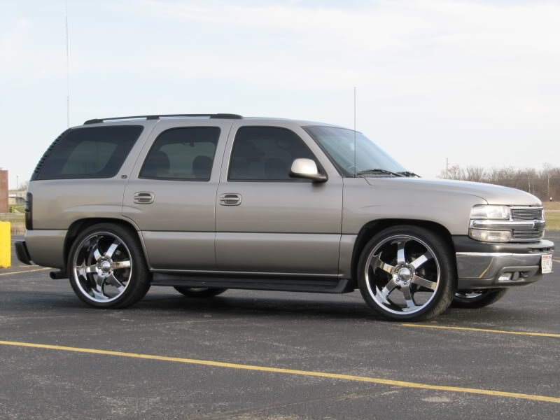

you can sit level with keys and 5" springs..heres my truck with keys and 5" coils in rear..no trailing arm relocation kit, just new stock shocks from autozone and shock extenders with the free travel mod..im right at about 33.5 all the way around..rides like stock in the rear now..i just need new shocks in front then it will be perfect..
worst case just throw some helper bags in the rear if its a little low for you..i can raise the rear over an inch with the bags
