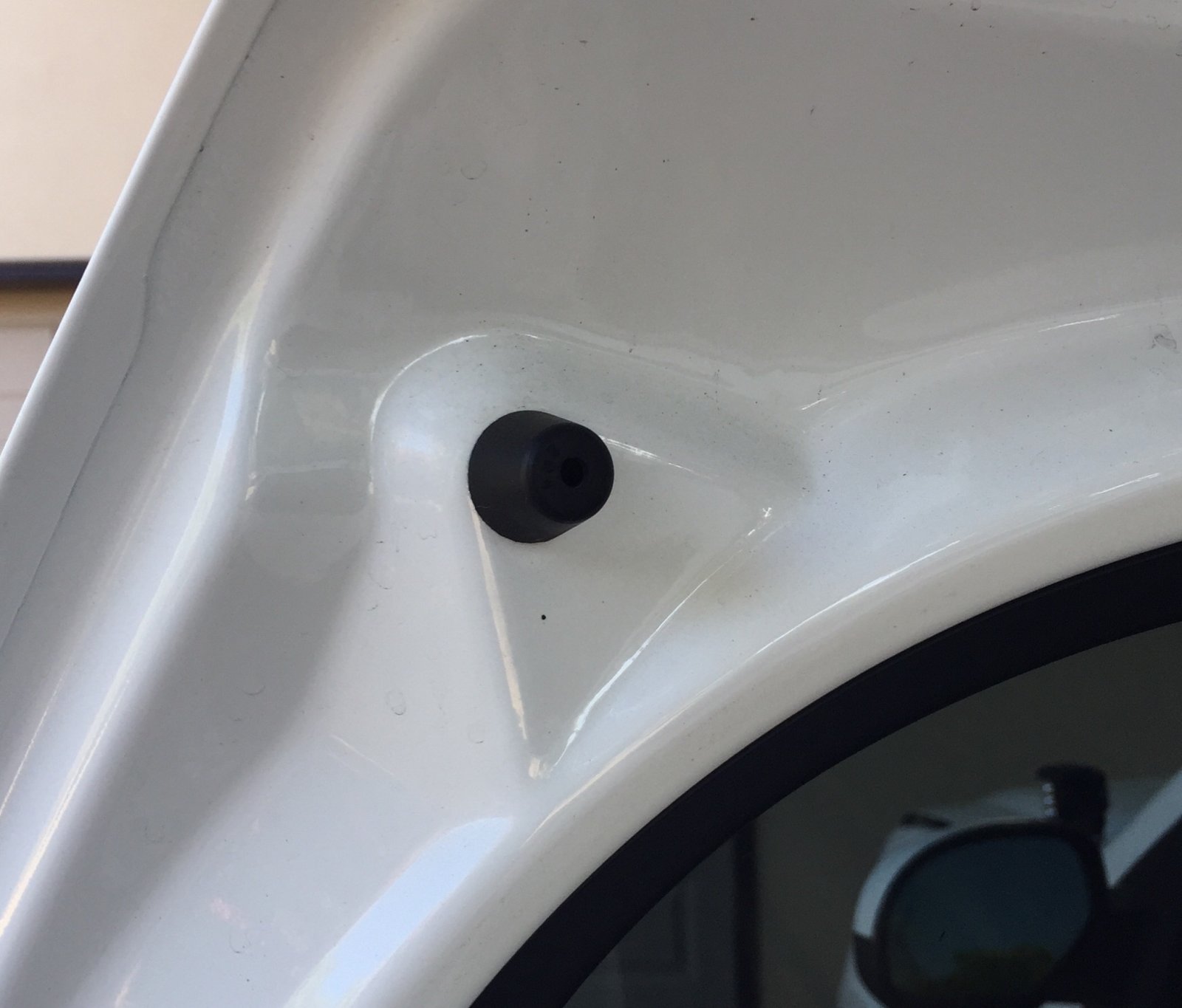

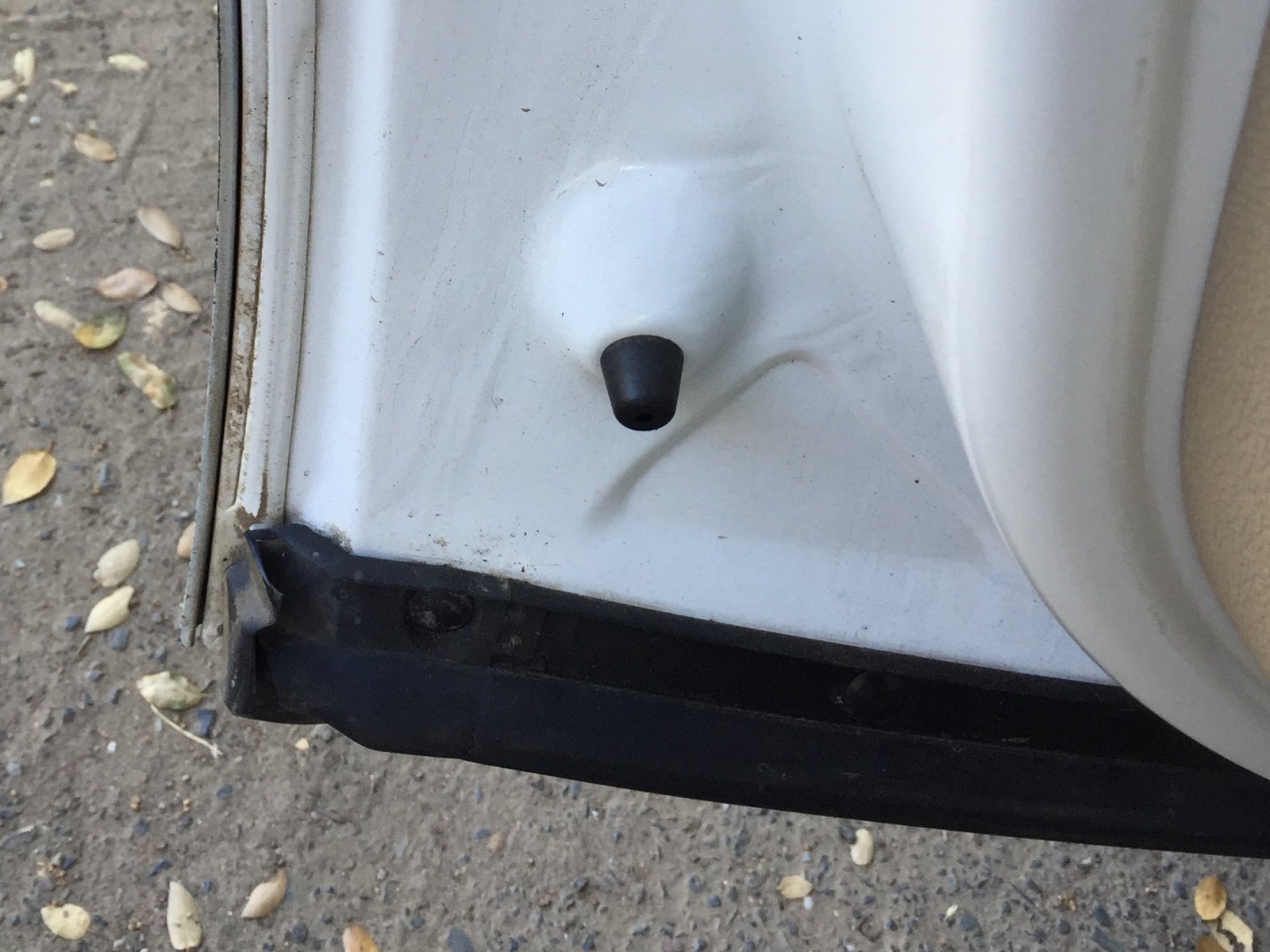

You do have the rubber bumpers at the top and bottom corners?

I do have both top and bottom bumpers on the right door but missing the top one on the left. Both doors sound identical so I ruled that out as the problem.
