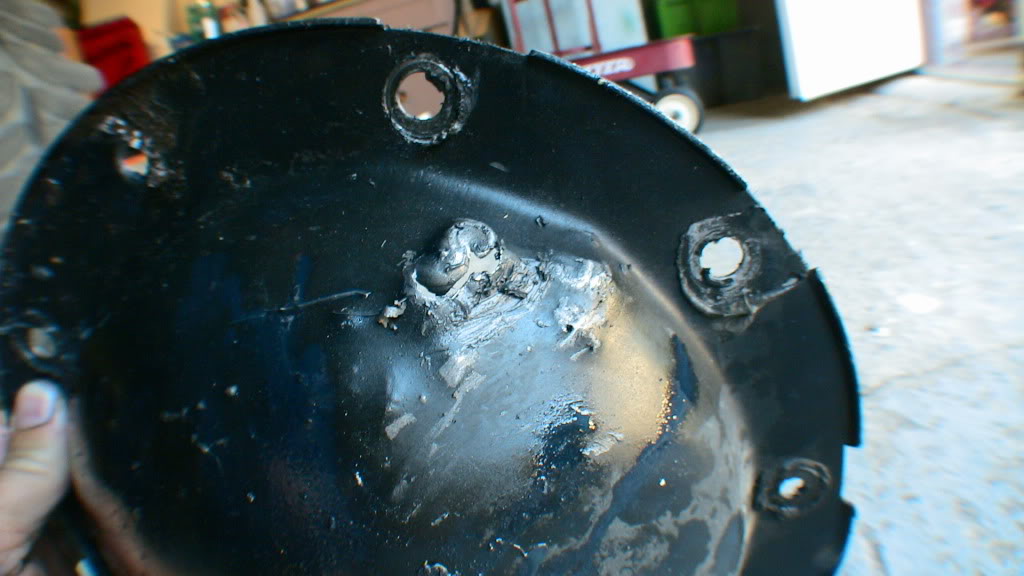

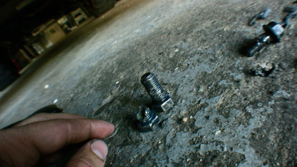

oh and might I add that this similar incident (differential wise) happened to clean95 and he had his work done at the same shop
they didn't torque one of the bolts down enough or put loc-tite on it or something because one of his bolts backed out and smashed the cover

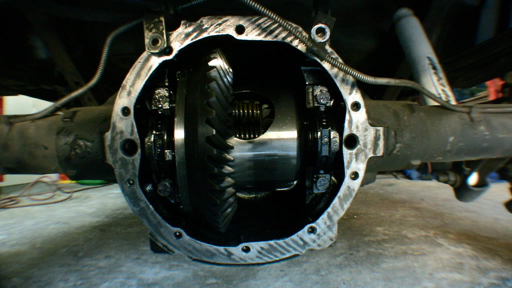

according to the shop..
I never replaced the oil causing everything to heat up and the bearings let go and a bolt sheared off causing the ring gear to hit the cover and crack

I'm no expert on diffs, but I'm calling BS on the shop all day. How many Tahoes leave the factory only to never have their diffs serviced and not blow up? If not servicing the diff was actually the cause that diff oil better look like paste IMO and the ring/pinion should show signs of the diff seizing and further more at least one bearing would have to have failed in order for it to "walk" out like it did. I'd say someone didn't torque the bolts down properly and one backed out. Once load was put on it snapped and flies into the diff cover like the pic or the entire diff shifts and the entire ring gear slides into the diff cover. They'd have to show me some seized bearings or something. I would definitely put the ball back in their court to prove without a doubt you caused the failure which I doubt is the case.

the pictures above are what happened to clean95 when he got his work done at the same shop.. he on the other hand out of the act of god got his replaced under warranty (could it be that he is quite a bit older and doesn't look like he would **** around compared to me who the shop thinks is some punk kid who doesn't know the difference between a spider gear and a ring gear?)
either way from what they told me (which I have to believe since I wasn't there when they took it apart) everything got too hot and the bearing let go which caused the bolt to shear off at the head causing the ring gear to slip and hit the cover of the differential
my dad was trying to tell them that oil is oil.. no matter if its black or not if its full of gear oil then it should be lubricating
I would understand if I was trying to do a burnout and it popped I would eat my words and say yes this is my fault I will pay to fix it but I was ****** driving on the golden gate bridge hit one bump in the road and my rear end BLEW up
how could it have got hot driving in 70º weather for less than an hour without towing/hauling under normal driving circumstances?
the owner of the shop said that he has been doing differentials for 20 years so he would know what he is doing and that any sign of an installer defect he would stand up for me and say it is his fault and that my diff wouldn't have lasted more than 100 miles if it was in fact installer defect
