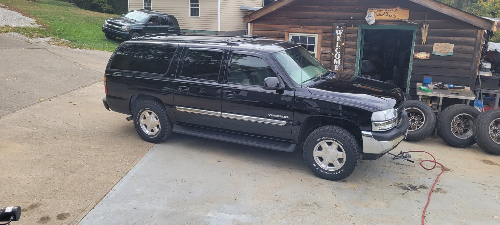

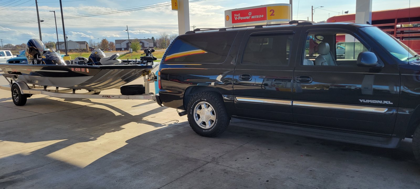

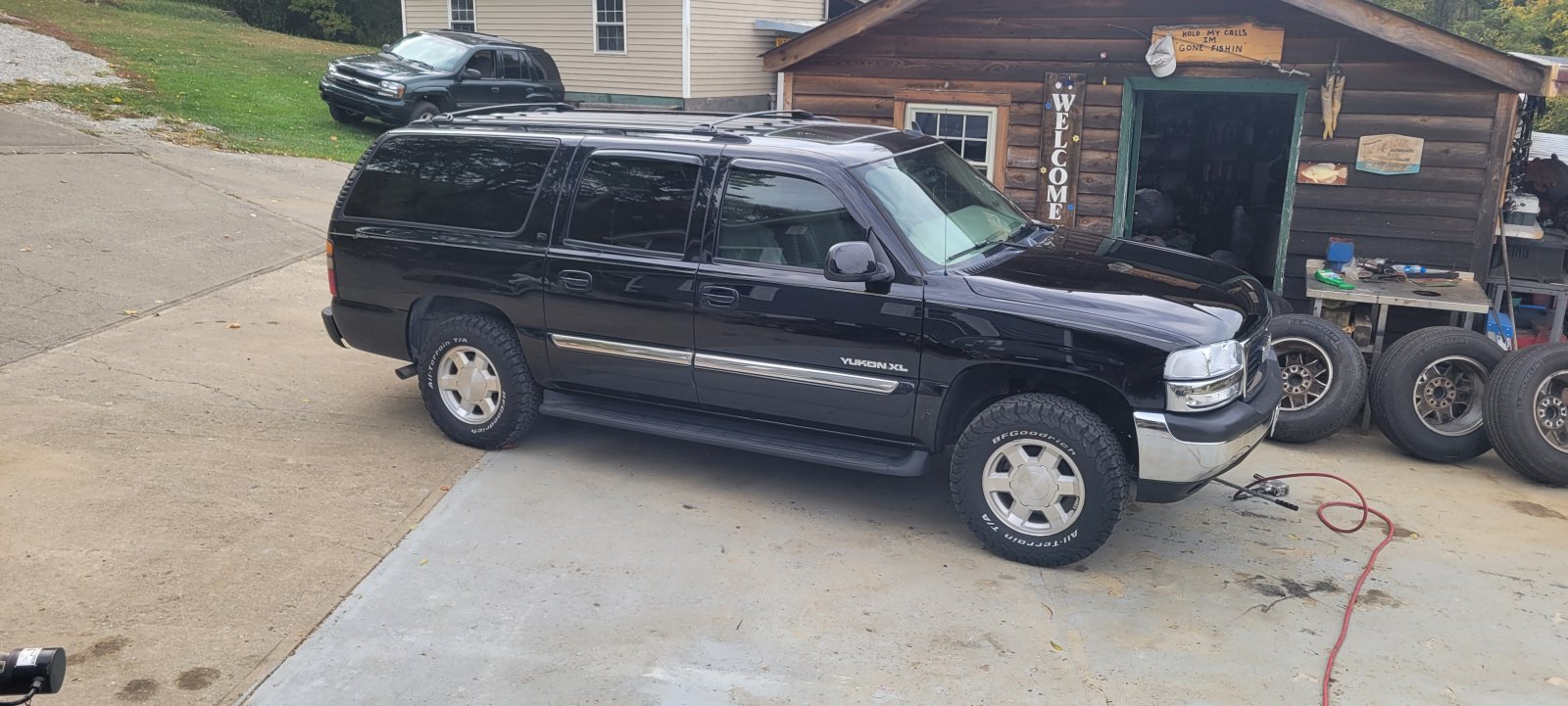

Let me back up, thanks for having me in the forum.
I have always had GM or GMC products and really like my Yukon its my second one and most likely my last one? Use it for towing my fishing boat and sometime load it down with grand kids. I do not use as a daily driver.
I should of known you would need all the detailed info to help my concern.
History : I have only had the truck for 6 months, My goal is to help with load capacity but not increase ride height. It has auto level ride but I`m guessing it doesn`t work? No codes on display.
I will not repair or replace that system, I plan on removing it some day but for now if possible just increase capacity.
Vehicle:
2006 Yukon SLT 1500 xl serial# 3GKEC16Z36G232626, 128,000 miles no rust in nice shape.
Couple of other option codes if needed, 69-Level control Auto Air, HDyd6 Rear spring base equipment
Thanks ahead of time!

I show that you have the fancy suspension and if she is sagging, then the springs are likely wore out.
19331451 are your rear shocks.
15182557 are your rear springs.
If you want to convert that to dumb parts, the rear end WILL rise up a few inches until it takes a load.
