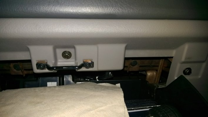

Same problem on my 05. It is the latch. I got the new latch but it is a bear/PITA to disassemble the cover. I have yet to replace the latch. At this point, I think a new cover is in order. They are available at ebay.

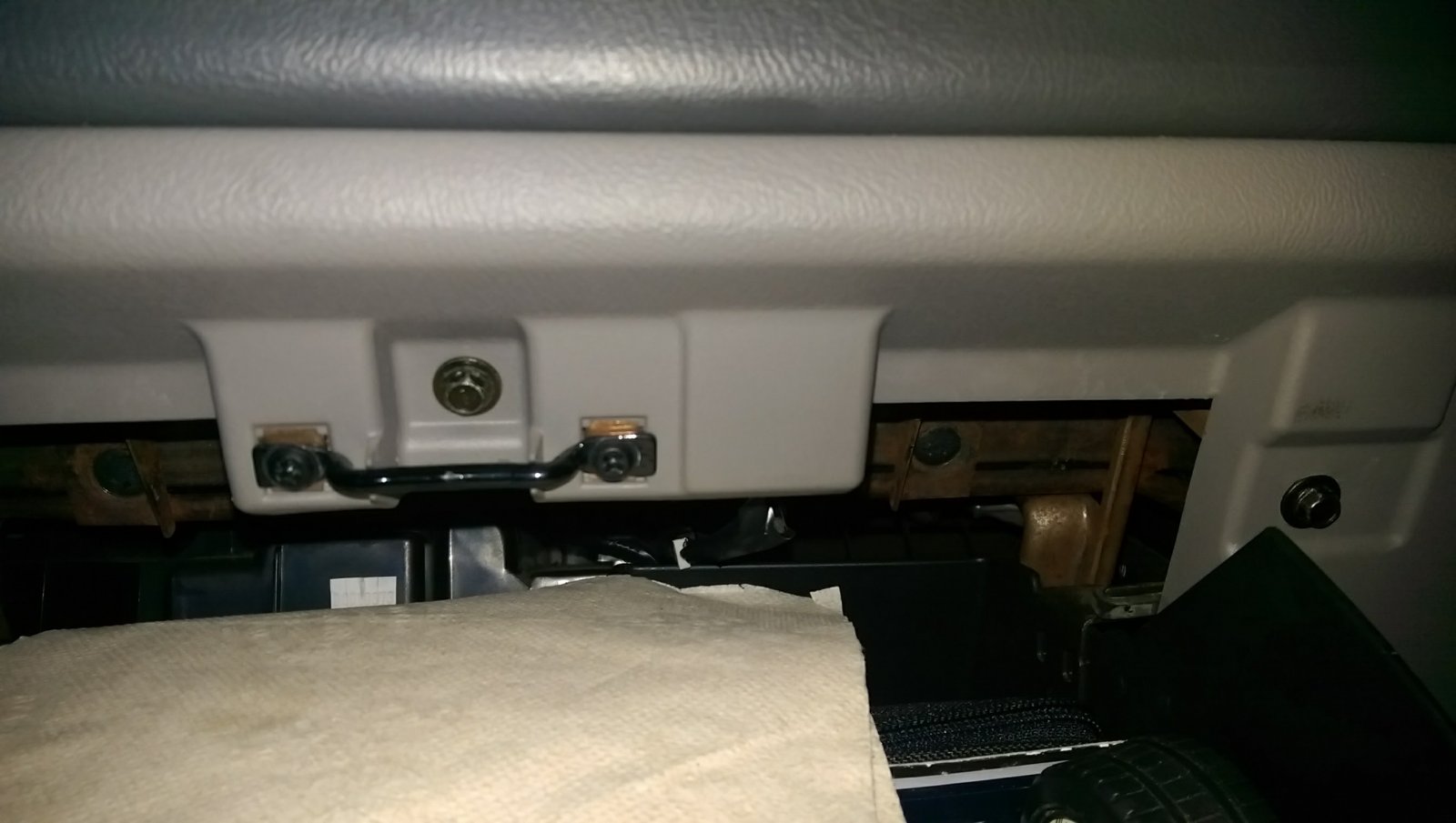

So I looked at my glove box latch assembly and found that the plastic housing where the latch bar (maybe called a latch eye) is screwed into (2 screws) is cracked and a piece broke off, so it is loose. Now the glove box closes (hook engages the eye) but since there's a lot of play the glovebox light stays on because there's not enough force to keep the switch pressed, so I had to disconnect the light switch connector. Now I'm looking for a pewter grey glove box assembly (probably the whole thing door and housing/trim)

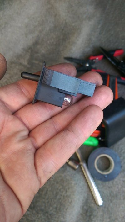

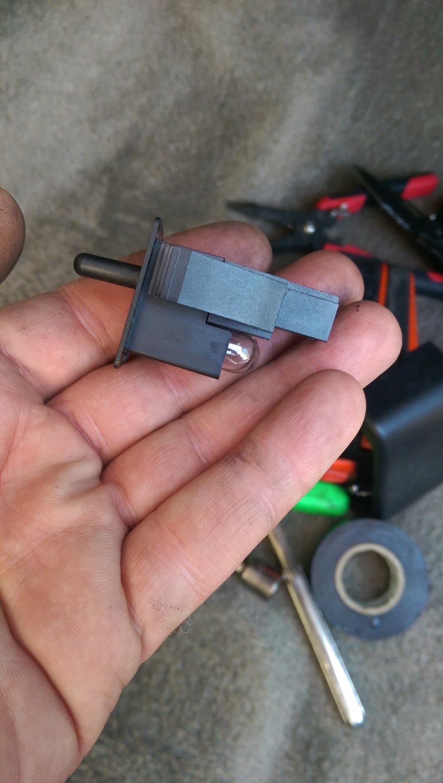

03 was the last year for the glovebox light. It can be retrofitted, or just get a used one from a junkyard.
This is the light switch you'll need for the retrofit. IMAG0323_416229821831947.jpg
You'll need to cut out the blank square to the right of the metal latch. I'm not sure how you'd do the wiring tho.

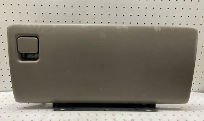

Just hit me with a reasonable offer. Not sure how much it'll cost to ship tho. I'm in 07734.
Thanks for the offer. I found the part on eBay, shipping for free from NY. It's $130 for the whole assembly (glove box door & bezel trim). Color code 922 (grey) and is also from a 2003 Denali.
